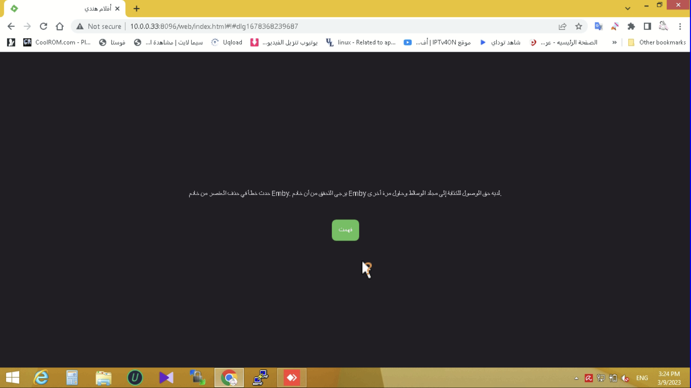

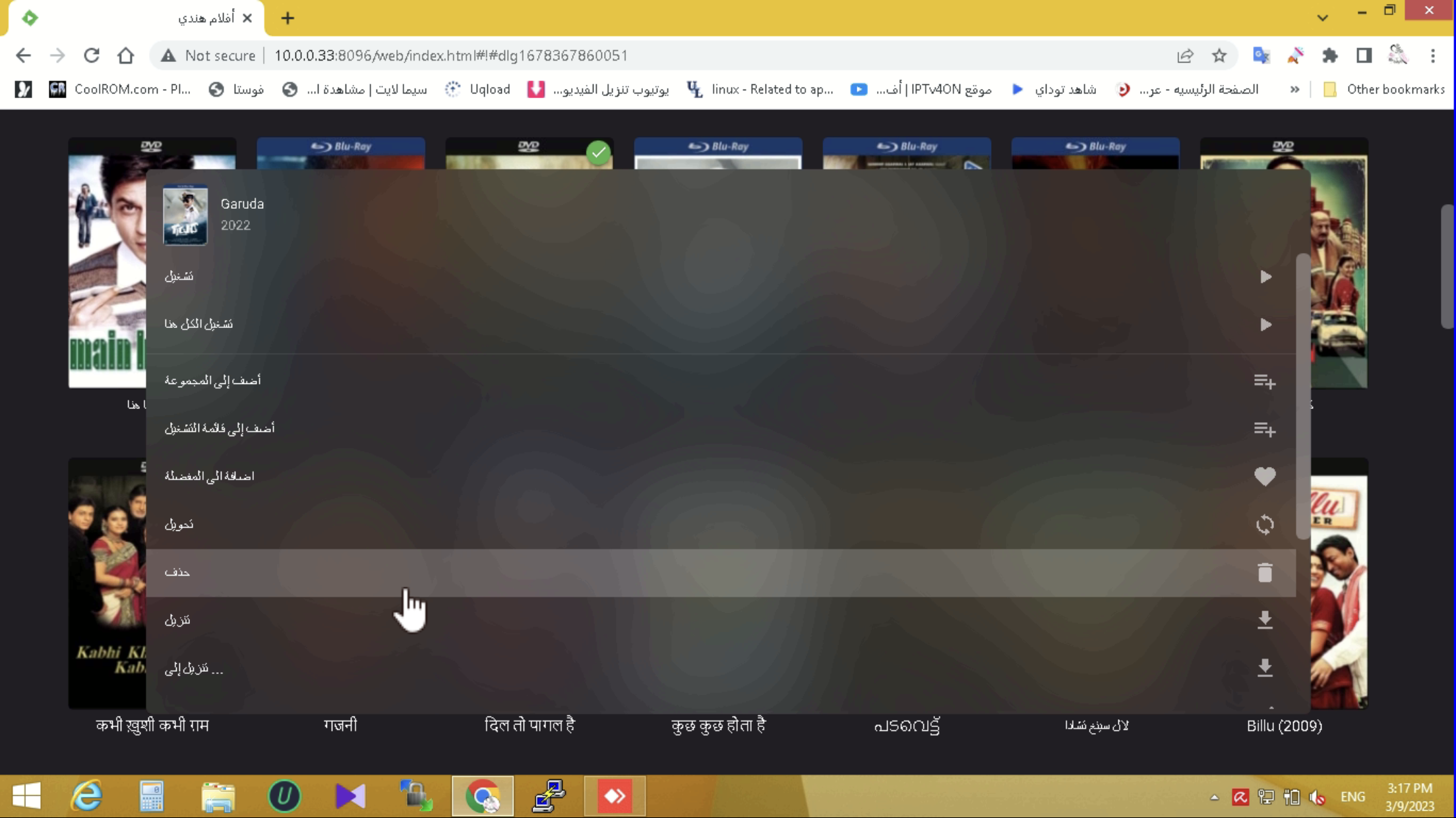

sameh1925 24 Posted March 9, 2023 Posted March 9, 2023 (edited) When I say to delete anything as shown in the picture. I see an error that Mbe does not have access to write in the folders. How can I make Mbe have the powers of the raut so that I can delete it immediately? ubuntu 20.04 Edited March 9, 2023 by sameh1925

Luke 42245 Posted March 9, 2023 Posted March 9, 2023 The server is being denied permission to delete your file: 2023-03-09 17:44:05.484 Info Server: http/1.1 Response 304 to 10.0.0.45. Time: 3ms. http://10.0.0.33:8096/emby/videos/42056/stream.mp4?DeviceId=0a104312-e0d5-4531-b7d6-5ee16bb1f3eb&MediaSourceId=64b81e7baf147845bb89d71ace17d00d&Static=true&PlaySessionId=053a9773898b4002ac60fa1287038659 2023-03-09 17:44:05.510 Error Server: Error processing request *** Error Report *** Version: 4.6.7.0 Command line: /opt/emby-server/system/EmbyServer.dll -programdata /var/lib/emby -ffdetect /opt/emby-server/bin/ffdetect -ffmpeg /opt/emby-server/bin/ffmpeg -ffprobe /opt/emby-server/bin/ffprobe -restartexitcode 3 -updatepackage emby-server-deb_{version}_amd64.deb Operating system: Linux version 5.4.0-139-generic (buildd@lcy02-amd64-112) (gcc version 9.4.0 (Ubuntu 9.4.0-1ubuntu1~20.04.1)) #156-Ubuntu SMP Fri Jan 20 17:27:18 UTC 2 Framework: .NET Core 3.1.21 OS/Process: x64/x64 Runtime: opt/emby-server/system/System.Private.CoreLib.dll Processor count: 2 Data path: /var/lib/emby Application path: /opt/emby-server/system System.UnauthorizedAccessException: System.UnauthorizedAccessException: Access to the path '/media/aflam-handy/Garuda (2022).mp4' is denied. Have you checked the permissions on the file?
