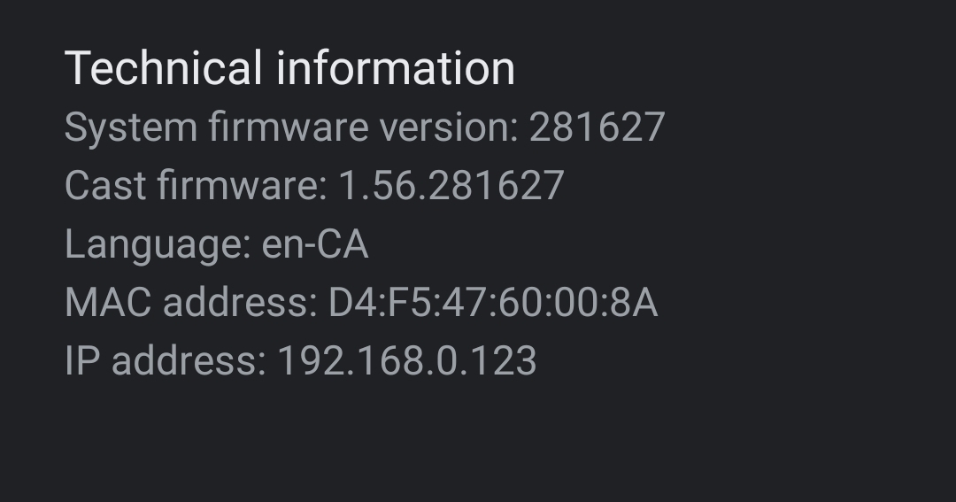

Luke 42186 Posted March 6, 2023 Posted March 6, 2023 Hang on here, I don't believe the number of subtitle tracks is relevant to this. What model Chromecast is this?
hyftar 1 Posted March 6, 2023 Author Posted March 6, 2023 2 minutes ago, Luke said: Hang on here, I don't believe the number of subtitle tracks is relevant to this. What model Chromecast is this? This is the device information. Otherwise it's a Chromecast ultra connected via ethernet.
