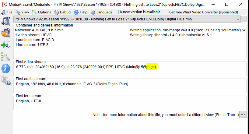

jrhessey 21 Posted March 1, 2023 Posted March 1, 2023 I've been noticing more 4k videos have been transcoding here recently and decided to try to figure out why. After a couple days of googling and looking at logs, I think I've noticed the culprit. Any 4K hevc files with the format profile where the tier is set to high transcodes. I'm not sure if this is an Emby thing or a Shield thing though. I'm transcoding a video that is Main@L5@High down to Main@L5@Main to see if it direct plays. Has anyone else noticed this with Emby and the Shields? If so, is there a fix? Thanks!!

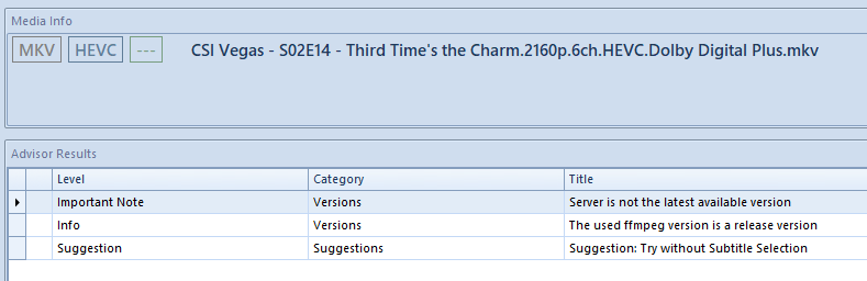

rbjtech 5344 Posted March 1, 2023 Posted March 1, 2023 I now just use the Emby Support tool - in both the cases above, its suggestion was subtitles in both cases. It's usually spot on. @softworkz
GrimReaper 4898 Posted March 1, 2023 Posted March 1, 2023 (edited) Ditto, when I'm in front of a PC and online - which won't happen for another 3-4 months, sentenced to mobile phone only for forseeable future. Though those look like generic recommendations in these particular cases, items have SUBRIPs only which shouldn't (doesn't mean they don't) create issues. Edited March 1, 2023 by GrimReaper 1
jrhessey 21 Posted March 1, 2023 Author Posted March 1, 2023 1 hour ago, GrimReaper said: However, you have global bitrate limit at 2 MBps: and you're playing back 8+ Mbps item. Since your IPs are anonymized and no server log, don't know whether that was remote or local playback? It was a local playback. Where can I get that Emby Support Tool? Would it transcode even if I wasn't displaying the subs? I can post a log file, but mine are always full of tvdb errors getting images. I can create a new log when I got to play the file again tonight. When you guys said they were main profiles, is that the first Main or the second Main in the format profiles. I attached the pictures of the media info data with the TIER highlighted. They both appear to have subtitles with the text stream, right?

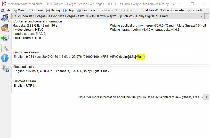

GrimReaper 4898 Posted March 1, 2023 Posted March 1, 2023 7 minutes ago, jrhessey said: Would it transcode even if I wasn't displaying the subs? Easy to test, ain't it? 8 minutes ago, jrhessey said: When you guys said they were main profiles, is that the first Main or the second Main in the format profiles. I attached the pictures of the media info data with the TIER highlighted. I think you might've provided wrong logs as they're both for the same CSI episode (Main profile only) played at different times. 9 minutes ago, jrhessey said: They both appear to have subtitles with the text stream, right? Yes, they both have embedded text subs.

jrhessey 21 Posted March 1, 2023 Author Posted March 1, 2023 Here you go guys. I played CSI Vegas Season 2 Episode 5 (Direct Play) and Episode 14 (Transcode). I included both the remux and transcode log but they are both from Episode 14. The emby server log shows the direct play of Episode 5. I included the hardware detection too just in case. Episode 14 and 5 txt files are the media info for each episode. One weird thing I see on the activity is that the transcode episode was played twice and it said it was recovered from a playback error. I've attached a couple screenshot as well showing the tier bandwidth settings (fCOdRus and HEVC Wiki) . That's the only thing I can see that is different between the 2 and I am wondering if the shield or emby can't handle the bandwidth difference, 25 for main and 100 for high. Thanks for any help everyone!! ffmpeg-transcode-9c35cb75-6440-4548-88ff-b2cb6aabdcd5_1.txt ffmpeg-remux-2fcdc82f-b029-4840-b56f-db4a9997a71f_1.txt embyserver.txt hardware_detection-63813288508.txt Episode 14.txt Episode 5.txt

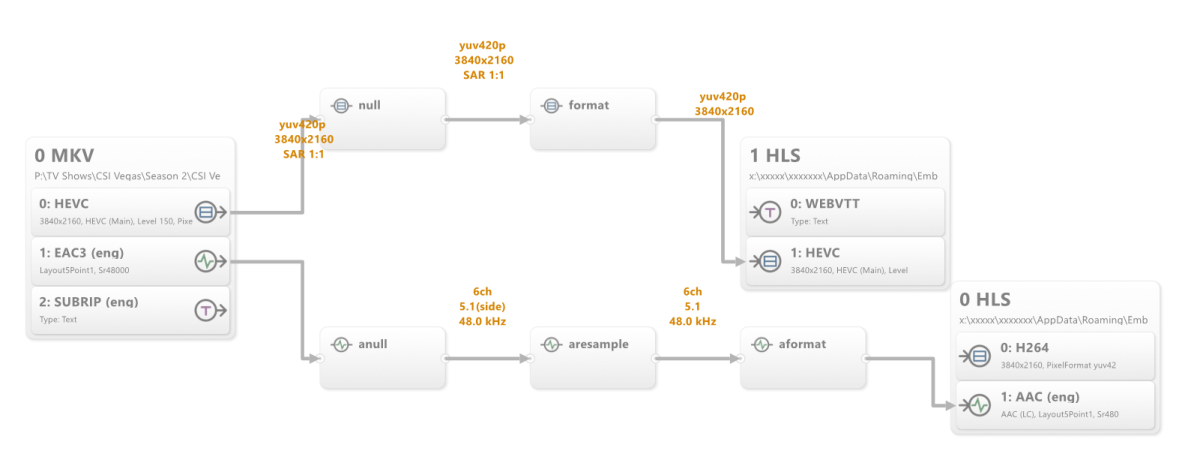

Carlo 4561 Posted March 21, 2023 Posted March 21, 2023 On 3/1/2023 at 11:48 AM, jrhessey said: here are the ffmpeg files for the file that transcoded. ffmpeg-transcode-b6c3ecb5-5aa9-44a0-b5e2-da6e0e18b260_1.txt 143.36 kB · 5 downloads ffmpeg-remux-0bc93a4f-4f87-43df-889e-7a2d11bd89e0_1.txt 12.78 kB · 4 downloads There's a limit of 2GB set for the client which forced it to transcode. It was software transcoding and it could only transcode the 4K file at speed=0.448x which is a bit less than half the speed it needed to transcode at to be successful. Subtitles looked fine. Your problem might have only been a setting limiting bandwidth to 2MB. The filtergraph looks a little strange to me. @softworkzcan you take a look at this: We have 0 HLS with H.264, audio, no subs and also 1 HLS with sub and HEVC but no audio.. I don't know if it's just a funky graph drawn this way but the ffmpeg file look a bit strange as well.
