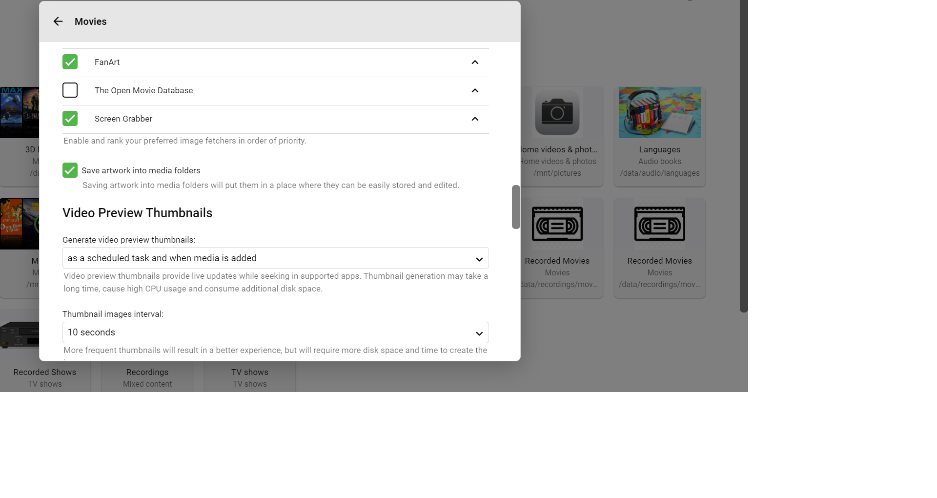

JuJuJurassic 49 Posted February 28, 2023 Posted February 28, 2023 My network swich was turned off, so my emby server lost access to the SMB data store. Now it's lost all the movies from it's library, a rescan files brings them back, but with no metadata. Now it's bringing the metadata back, but in doing so it loses the order the films were added. Why is this happening, the metadata is stored with the media, as in meta1 attached. The recently watched area also wrong, quite out of date, is this a clue? Does rescan files force a metadate refesh too? What can I do to stop this happening? It's driving me nuts. Thanks embyserver.txt

ebr 16307 Posted March 1, 2023 Posted March 1, 2023 4 hours ago, JuJuJurassic said: Is there a way of adding the films and listing them by file creation date? Hi. Yes, this is an option in the library settings.
