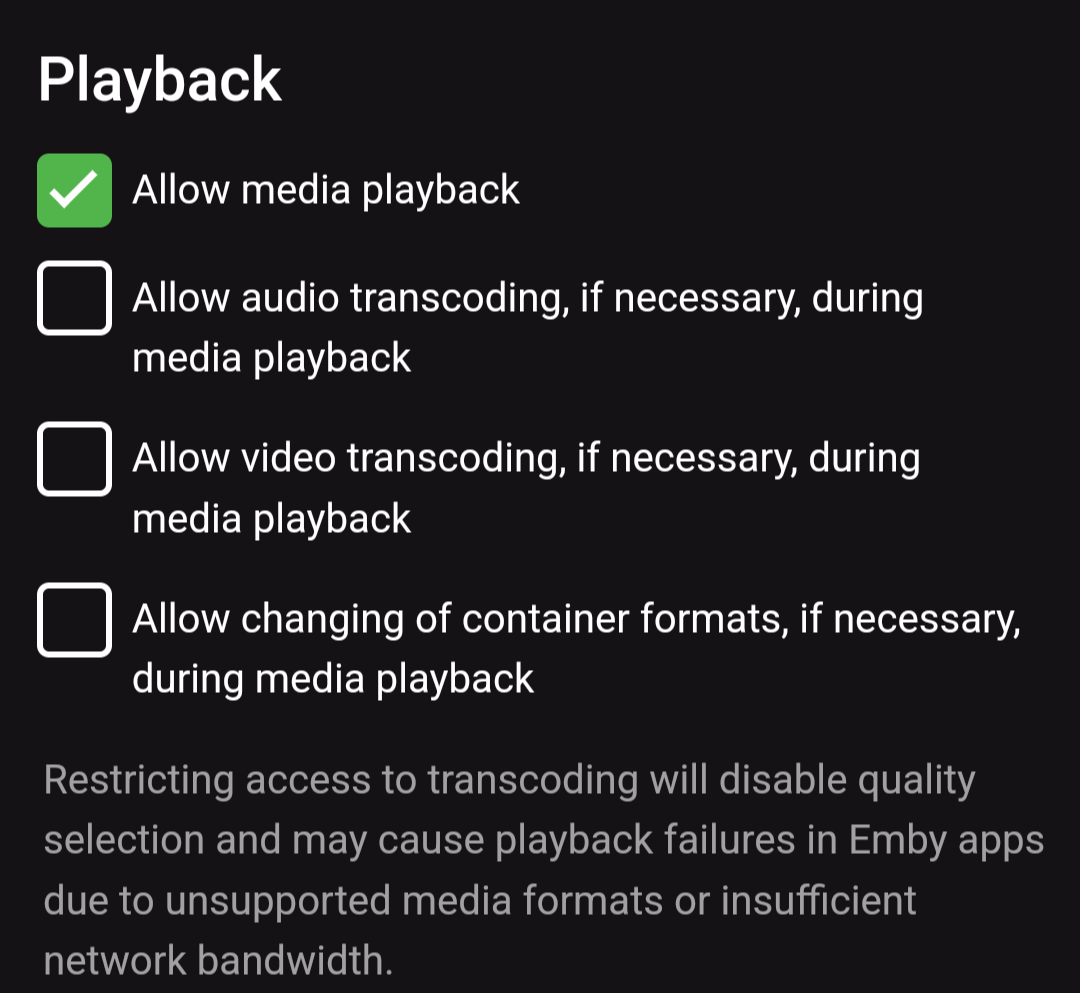

Darkseidd 59 Posted March 9, 2023 Posted March 9, 2023 idk about others setup, but this is my setup to ensure DirectPlay is always in place. its been years since last i saw log with *transcode* name on the log's name.
