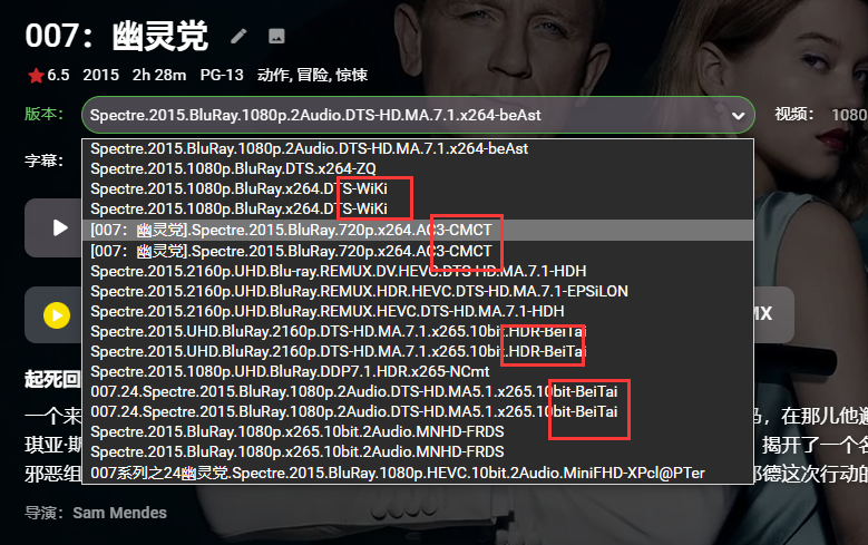

tobox 1 Posted February 26, 2023 Posted February 26, 2023 Hi there, Don't know how to remove dupe versions , there isn't exsit dupe videos in source folder. I try to remove the media folder and rejoin and rescan , the matter still exsists. I guess the only way to do is to deal with library.db directly. But i can't delete extra records in MediaItems table, how to solve this ,thanks!

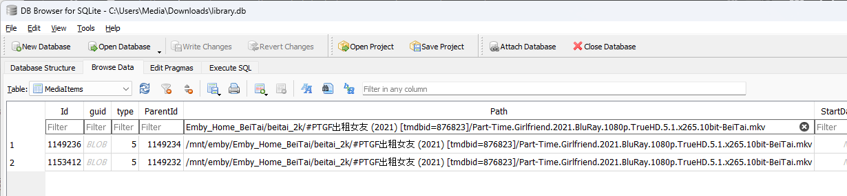

tobox 1 Posted February 27, 2023 Author Posted February 27, 2023 --can't done this because i don't know how other tables are related, guess delete this can remove the dupe. delete from MediaItems where ParentId='1207912'; delete from MediaItems where ParentId='1207911'; -and i guess also need to remove records in other related tables. delete from MediaStreams2 where itemid in (select id from MediaItems where ParentId='1207912'); delete from MediaStreams2 where itemid in (select id from MediaItems where ParentId='1207911'); Not know too much , those are my thoughts to directly remove dupe.
Happy2Play 9800 Posted February 27, 2023 Posted February 27, 2023 (edited) 4 hours ago, tobox said: tried removing them from the library, full scann, readding? >> Yes, i tried many times but can't work This should have cleared the entries from the library. Did you check the database when you removed the items and did a scan of all libraries? But yes, it is a pain clearing an item manually from the database as you have to remove the itemid data from each table it exists in to delete the mediaitem. Don't know sql but took itemid 1215858 which is one of the "/mnt/emby/Emby_Home_CMCT/cmct_2k/007:幽灵党 (2015)/[007:幽灵党].Spectre.2015.BluRay.720p.x264.AC3-CMCT.mkv" versions and removed it. DELETE FROM AncestorIds2 WHERE ItemId = 1215858; DELETE FROM Chapters3 WHERE ItemId = 1215858; DELETE FROM ItemLinks WHERE ItemId = 1215858; DELETE FROM ItemPeople WHERE ItemId = 1215858; DELETE FROM MediaStreams2 WHERE ItemId = 1215858; DELETE FROM MediaItems WHERE Id = 1215858; Would need to do this for each duplicate, just pick one of the itemids. Edited February 27, 2023 by Happy2Play
tobox 1 Posted February 27, 2023 Author Posted February 27, 2023 (edited) 1 hour ago, Happy2Play said: This should have cleared the entries from the library. Did you check the database when you removed the items and did a scan of all libraries? But yes, it is a pain clearing an item manually from the database as you have to remove the itemid data from each table it exists in to delete the mediaitem. Don't know sql but took itemid 1215858 which is one of the "/mnt/emby/Emby_Home_CMCT/cmct_2k/007:幽灵党 (2015)/[007:幽灵党].Spectre.2015.BluRay.720p.x264.AC3-CMCT.mkv" versions and removed it. DELETE FROM AncestorIds2 WHERE ItemId = 1215858; DELETE FROM Chapters3 WHERE ItemId = 1215858; DELETE FROM ItemLinks WHERE ItemId = 1215858; DELETE FROM ItemPeople WHERE ItemId = 1215858; DELETE FROM ItemLinks WHERE ItemId = 1215858; DELETE FROM MediaStreams2 WHERE ItemId = 1215858; DELETE FROM MediaItems WHERE Id = 1215858; Would need to do this for each duplicate, just pick one of the itemids. Did you check the database when you removed the items and did a scan of all libraries? ==> Yes, when i remove the items and scan again, these same video still show dulicate version. I guess the only way is to totally remove all the data and reinstall emby and rescan all of libraries. But it wll take weeks to do since i have a huge library. any sqls to batch remove the duplicate for once if possible, that would save my time lol Edited February 27, 2023 by tobox

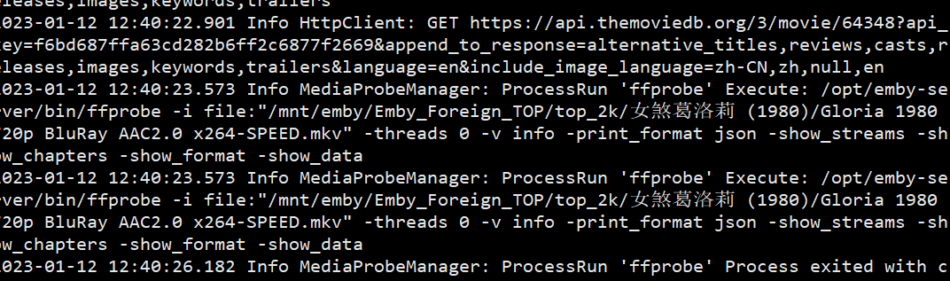

tobox 1 Posted February 27, 2023 Author Posted February 27, 2023 19 minutes ago, Happy2Play said: That does not make sense if you removed the item they can't still appear. Can you post a server log when you did this as it will show the items being removed from the database. Might be but I don't know querying to show items with the same PATH. As all multi-versioning is considered duplicates. That does not make sense if you removed the item they can't still appear ==》 Yes if i remove the item, it disappear. When i remove the video outside the folder and rescan, this item sure disapper. But if i join the video again and rescan, it still shows duplicate versions., the following shows the server log: See it scans twice for a same video. Might be but I don't know querying to show items with the same PATH. As all multi-versioning is considered duplicates. ==> Yeaah at least i know how to remove item from database, i will try to write batch sqls to deal.

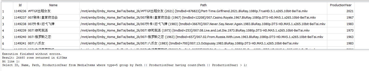

Happy2Play 9800 Posted February 27, 2023 Posted February 27, 2023 (edited) 26 minutes ago, tobox said: See it scans twice for a same video. @Lukewould have to comment on that but will want to see the full server log with specific examples. But will guess both entries were not removed from the database. But looking at your database you have 24460 movies that are duplicated. So roughly a quarter of your movies have duplicates. Slight change to @cayarsquery group all same path media. Execution finished without errors. Result: 24460 rows returned in 4813ms At line 1: Select ID, Name, Path, ProductionYear from MediaItems where type=5 group by Path || ProductionYear having count(Path || ProductionYear) > 1; I guess you could the take the IDs in that list to create a script to delete them all. But with that many records I personally would rebuild the database. But remember all your userdata is in that same database. If you use the server configuration backup plugin then is is a easy userdata only restore. Edited February 27, 2023 by Happy2Play

Solution Happy2Play 9800 Posted February 27, 2023 Solution Posted February 27, 2023 21 minutes ago, Luke said: Is anything actually duplicated in the database? Yes lets look at the first item in the query as this database has 24,460 dups.

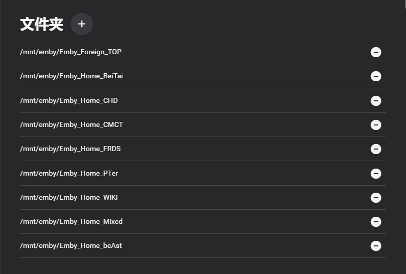

Carlo 4561 Posted February 28, 2023 Posted February 28, 2023 4 hours ago, Happy2Play said: Yes lets look at the first item in the query as this database has 24,460 dups. By any chance have the same directories been added to multiple libraries? 1
Happy2Play 9800 Posted February 28, 2023 Posted February 28, 2023 39 minutes ago, cayars said: By any chance have the same directories been added to multiple libraries? Don't know how to check that via the database but would appear so they are different ParentIds so 1149234 and 1149232 are a mirror of each other 4176 items. But there other ParentIds. I know the one I found in my db has the same ParentId. 1
Happy2Play 9800 Posted February 28, 2023 Posted February 28, 2023 @toboxSince the plugin made the problem visible, do you have the same folder added to multiple libraries? But removing the plugin should show you have items assigned in multiple libraries.
tobox 1 Posted March 1, 2023 Author Posted March 1, 2023 15 hours ago, Happy2Play said: @toboxSince the plugin made the problem visible, do you have the same folder added to multiple libraries? But removing the plugin should show you have items assigned in multiple libraries. Nope i check carefully none same folder was added to multiple libraries. I set up a whole new server andd scan again, everything works fine. So i guess this prolem was something related to auto-group script. For those dupe in database,i would try to use your sqls to write a script to remove. That would save time to fully rescan. BTW, only some folders are dupe, many others work fine. It's this library , some of folders scan dupe movies for same video, for thoes dupe folders, you remove them , scan ,rejoin them again ,scan , still dupe.
