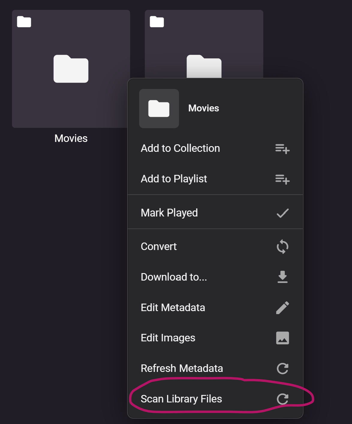

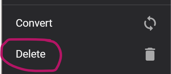

MovieGoer2021 4 Posted February 26, 2023 Author Posted February 26, 2023 2 minutes ago, GrimReaper said: That all sounds in order. Have you run Scan library task upon adding those themes, in case RTM didn't pick them up? Yes, I ran both Scan library and Refresh metadata,it just didn't work. The only solution I found is to first move /Interstellar(2014) out of the Movie folder, and then delete the movie from the webpage, and then move /Interstellar(2014) back to /Movies, and run Scan library again, after that the theme song will finally start playing.
Solution GrimReaper 4851 Posted February 26, 2023 Solution Posted February 26, 2023 Sorry, cannot recreate, wherever I put theme.mp3 it just plays upon scan. Try manually running Scan media library scheduled task (Settings>(scroll down) Scheduled Tasks tab>(scroll mid way) Scan media library>press Play icon right-end) instead of library menu Scan library files, see whether that'll make a difference (though it generally shouldn't).
MovieGoer2021 4 Posted February 26, 2023 Author Posted February 26, 2023 4 minutes ago, GrimReaper said: Sorry, cannot recreate, wherever I put theme.mp3 it just plays upon scan. Try manually running Scan media library scheduled task (Settings>(scroll down) Scheduled Tasks tab>(scroll mid way) Scan media library>press Play icon right-end) instead of library menu Scan library files, see whether that'll make a difference (though it generally shouldn't). Thanks,I will give it a try

Happy2Play 9800 Posted February 26, 2023 Posted February 26, 2023 17 minutes ago, visproduction said: I just put the mp3 or flac theme music file in a subfolder theme-music. Make sure you have a correctly made .mp3 file and you are not just renaming a different audio codec type file to the mp3 extension. Also, there appears to be a bug that causes theme music to not play. If the folder name is different from the main video name before any dash, then theme music fails to play. This seems to stop theme music from playing. Folder name: Vacation video 2019 Media name: Vacation vid (2019).mp4 This works: Folder name: Vacation video 2019 Media name: Vacation video 2019 - 720P.mp4 Or this also works: Folder name: Vacation video 2019 Media name: Vacation video 2019.mp4 Hope that helps. Don't really follow as I had no issue with theme music with different folder/media names. Die Hart the Movie Anything.strm theme.mp3 But sounds like @MovieGoer2021is having database issues if removing, scanning, readding corrects the issue. Delete is not needed as Emby will automatically remove it via RTM or library scan (should be full scan to clear the database completely) when items are physically removed from library folder. 1
MovieGoer2021 4 Posted February 27, 2023 Author Posted February 27, 2023 18 hours ago, visproduction said: I just put the mp3 or flac theme music file in a subfolder theme-music. Make sure you have a correctly made .mp3 file and you are not just renaming a different audio codec type file to the mp3 extension. Also, there appears to be a bug that causes theme music to not play. If the folder name is different from the main video name before any dash, then theme music fails to play. This seems to stop theme music from playing. Folder name: Vacation video 2019 Media name: Vacation vid (2019).mp4 This works: Folder name: Vacation video 2019 Media name: Vacation video 2019 - 720P.mp4 Or this also works: Folder name: Vacation video 2019 Media name: Vacation video 2019.mp4 Hope that helps. Thanks,manually running Scan media library scheduled task fixed this problem. 3
MovieGoer2021 4 Posted February 27, 2023 Author Posted February 27, 2023 18 hours ago, Happy2Play said: Don't really follow as I had no issue with theme music with different folder/media names. Die Hart the Movie Anything.strm theme.mp3 But sounds like @MovieGoer2021is having database issues if removing, scanning, readding corrects the issue. Delete is not needed as Emby will automatically remove it via RTM or library scan (should be full scan to clear the database completely) when items are physically removed from library folder. A full library scan fixed this issue,thanks 1
