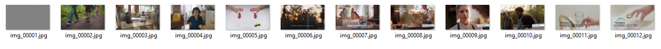

MBSki 1115 Posted February 24, 2023 Posted February 24, 2023 Here's an example from the super bowl which I recorded from Verizon Fios cable on their 4k channel. Why are all the thunmbnails grayed out?

rbjtech 5341 Posted March 17, 2023 Posted March 17, 2023 Worth providing a log - look for 'QuickImageSeriesExtractor' - and see what the ffmpeg command is doing. I'm thinking it maybe is trying to do tonemapping on SDR material ?

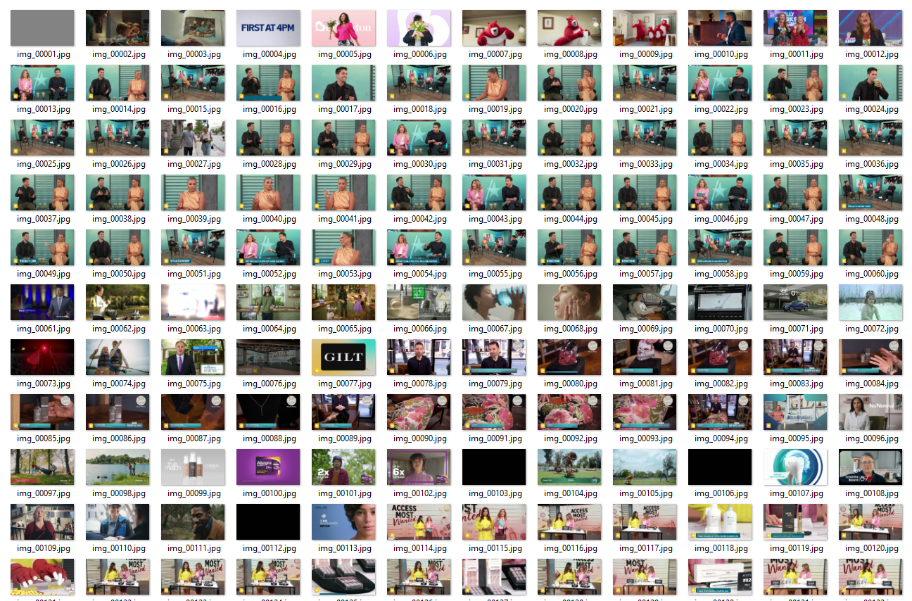

MBSki 1115 Posted April 6, 2023 Author Posted April 6, 2023 I just did a new recording and found this: 2023-04-06 11:25:27.408 Info App: ProcessRun 'quick-extract-imageseries' Execute: G:\MediaCenter\Emby-Server\system\ffmpeg.exe -f mpegts -threads 1 -skip_interval 10 -copyts -i file:"G:\MediaCenter\Videos\Television\Recorded TV\The View (1997)\Season 26\The View S26E139.ts" -an -sn -vf "scale=w=320:h=180" -vsync cfr -r 0.1 -f image2 "G:\MediaCenter\Emby-Server\programdata\cache\temp\e01ef7e9b1c140169d9478efa3f12fe2\img_%05d.jpg" 2023-04-06 11:25:27.449 Info Server: http/1.1 POST http://emby_remote_ip:8094/emby/Sessions/Playing/Progress. UserAgent: okhttp/4.9.2 2023-04-06 11:25:27.450 Info Server: http/1.1 Response 204 to host15. Time: 1ms. http://emby_remote_ip:8094/emby/Sessions/Playing/Progress 2023-04-06 11:25:27.551 Info App: ProcessRun 'quick-extract-imageseries' Process exited with code 0 - Succeeded I don't know what it's saying. But I got the grayed out images with that recording just now.
rbjtech 5341 Posted April 6, 2023 Posted April 6, 2023 @softworkzmay want to be involved here. What you can do it literally copy and paste the ffmpeg command from the above and save the output. I've modified it for you below to write to g:\MediaCenter\temp. run the command below from a command prompt. G:\MediaCenter\Emby-Server\system\ffmpeg.exe -f mpegts -threads 1 -skip_interval 10 -copyts -i file:"G:\MediaCenter\Videos\Television\Recorded TV\The View (1997)\Season 26\The View S26E139.ts" -an -sn -vf "scale=w=320:h=180" -vsync cfr -r 0.1 -f image2 "G:\MediaCenter\temp\img_%05d.jpg" The temp area will be filled with hundreds of images - which I presume will be 'grey'. Maybe have a play with the ffmpeg parameters to see if you can get non-grey images. (remove -vf "scale=w=320:h=180") for example will remove the scaling, -vsync cfr will remove the sync (or change to -vsync auto) -r 0.1 is every 10 seconds, change to -r 0.2 for every 20 seconds etc. You can't do any damage to the original file - it will dump all the output to the temp area. Is there any way to get 'the View S26E139.ts' to test with ? I suspect it's related to it being a TS file but difficult to know why without an analysis on the source file.

rbjtech 5341 Posted April 6, 2023 Posted April 6, 2023 (edited) Do you get the grey thumbs on the commercial breaks ? As I'm only getting the grey images at the start of that file above - the commercials look fine ? We may need an extract of the actual programme, not just the ads .. Edited April 6, 2023 by rbjtech
MBSki 1115 Posted April 6, 2023 Author Posted April 6, 2023 15 minutes ago, rbjtech said: Do you get the grey thumbs on the commercial breaks ? As I'm only getting the grey images at the start of that file above - the commercials look fine ? We may need an extract of the actual programme, not just the ads .. I'm not sure, I'd have to do a longer recording. For the Super Bowl I got 1 ok image out of more than 50. It seems commercials, at least for that recording are not HVEC. I can try another longer recording. Did you see anything in the logs for that first thumbnail?
rbjtech 5341 Posted April 6, 2023 Posted April 6, 2023 Yea, think we need an actual programme, not the commercials - as they are ok. It may be the transport stream itself. Lets get another recording to recreate the issue, then we can try and solve ..
MBSki 1115 Posted April 6, 2023 Author Posted April 6, 2023 Just now, rbjtech said: Yea, think we need an actual programme, not the commercials - as they are ok. It may be the transport stream itself. Lets get another recording to recreate the issue, then we can try and solve .. Sounds good. I'm recording another now for about 10 minutes.
MBSki 1115 Posted April 6, 2023 Author Posted April 6, 2023 Ok, I've got a new recording and every thumbnail is gray. Here's a link to the file: https://1drv.ms/u/s!AoeIRL90LCrSr5QCmrSA9iRPGg0Khg?e=gZxz5u
rbjtech 5341 Posted April 6, 2023 Posted April 6, 2023 22 minutes ago, MBSki said: Ok, I've got a new recording and every thumbnail is gray. Here's a link to the file: https://1drv.ms/u/s!AoeIRL90LCrSr5QCmrSA9iRPGg0Khg?e=gZxz5u hmm - I'm not seeing that .. so the output to a manual extract (to the temp folder) is producing grey images for you ?
Happy2Play 9811 Posted April 6, 2023 Posted April 6, 2023 26 minutes ago, MBSki said: Ok, I've got a new recording and every thumbnail is gray. Here's a link to the file: https://1drv.ms/u/s!AoeIRL90LCrSr5QCmrSA9iRPGg0Khg?e=gZxz5u Not sure but this is what I get from that file. 1
rbjtech 5341 Posted April 6, 2023 Posted April 6, 2023 Just now, Happy2Play said: Not sure but this is what I get from that file. Yep - same as me - images look fine (I'm extracting manually, but same result as you)
MBSki 1115 Posted April 6, 2023 Author Posted April 6, 2023 Well that's interesting. @Happy2Play, are your images from the Emby scan or manually? I'll try manual.
