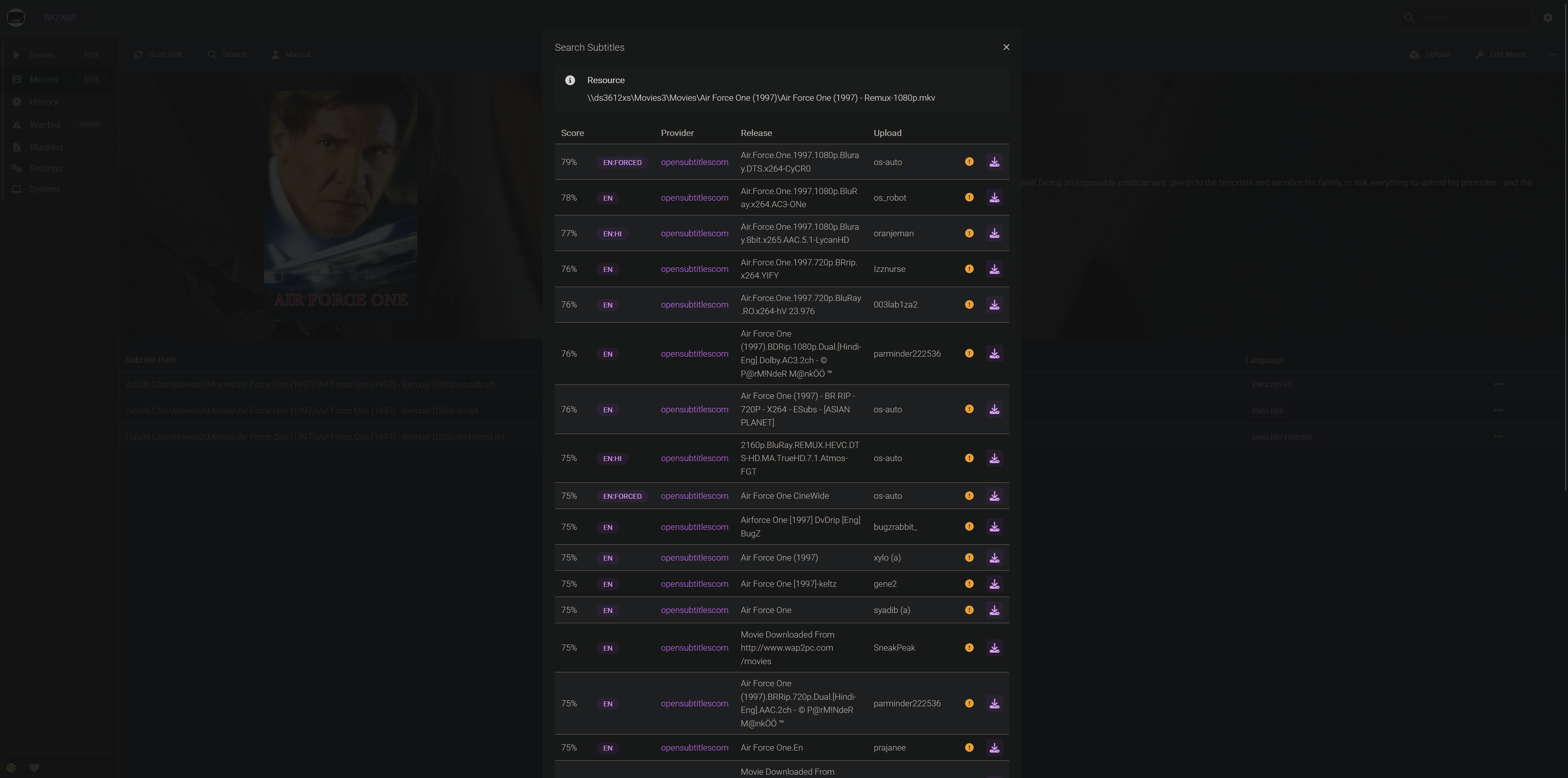

Spaceboy 2573 Posted February 26, 2023 Posted February 26, 2023 just one example of what you can get in bazarr as you can hopefully see behind, bazarr has fetched me english, english SDH and english forced for Air Force One. i don't know if it does some editing of the subs as it downloads them but i see no adverts - just the subs. once set up this is fully automated 1

Dickydodah! 154 Posted February 26, 2023 Posted February 26, 2023 I've just zoomed in on @Spaceboy picture and can see that the file has been renamed so it does seem to work. As long as you use Sonarr/Radarr as a "database manager" then Bazarr should work on DVD rips which I believe what @musicmafia currently has. 1
Spaceboy 2573 Posted February 26, 2023 Posted February 26, 2023 34 minutes ago, jaycedk said: Just one thing I need to add. Bazarr only works if you are using Radarr and / or Sonarr. true - but radarr and sonarr can just be used as simple media managers. no need to use the full function 2 1

Dickydodah! 154 Posted February 26, 2023 Posted February 26, 2023 9 hours ago, Spaceboy said: as you can hopefully see behind, bazarr has fetched me english, english SDH and english forced for Air Force One. i don't know if it does some editing of the subs as it downloads them but i see no adverts - just the subs. once set up this is fully automated I have actually setup Bazarr today and I was amazed to find how easy it was. However I am seeing the adverts in the subs. This is at the beginning of all of the files; 1 00:00:06,000 --> 00:00:12,074 Someone needs to stop Clearway Law. Public shouldn't leave reviews for lawyers. And this is at the end; 30 00:43:13,305 --> 00:44:13,636 Watch Movies, TV Series and Live Sports Signup Here -> WWW.ADMITME.APP The provider is Opensubtitles. @Spaceboy Do you have a VIP account as that may be why you don't see Ads? 2

Spaceboy 2573 Posted February 27, 2023 Posted February 27, 2023 14 hours ago, Dickydodah! said: I have actually setup Bazarr today and I was amazed to find how easy it was. However I am seeing the adverts in the subs. This is at the beginning of all of the files; 1 00:00:06,000 --> 00:00:12,074 Someone needs to stop Clearway Law. Public shouldn't leave reviews for lawyers. And this is at the end; 30 00:43:13,305 --> 00:44:13,636 Watch Movies, TV Series and Live Sports Signup Here -> WWW.ADMITME.APP The provider is Opensubtitles. @Spaceboy Do you have a VIP account as that may be why you don't see Ads? i do have a VIP account, thats likely what it is
