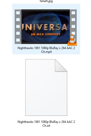

musicmafia 38 Posted February 24, 2023 Posted February 24, 2023 I love Emby but I'm not very tech savvy, so here goes: I've spent months acquiring hundreds of movie files and I am starting to notice a lot of the files either do not have (or are not showing an option to play) English subtitles ONLY during the parts of the movie where people may be speaking another language other than english. I am told this is called forced English subtitles. If there is a dropdown option to choose "forced" English, it works fine. But with some movies, no dropdown or subtitle options are shown. Reading about this it seems some files have these forced subs built in and others require external sub files, so I have downloaded many external sub files (most seem to be SRT format). In all the places I've looked for these files, I rarely see any files marked "forced" and so far all the srt files I've downloaded keep the subtitles on screen for the whole movie, even when English is being spoken. I tried adding ".forced" to the file name and that does not work. I also make sure the external sub files are named exactly to match the movie file. In my Emby subtitle settings, I have tried Default, Smart and Only Forced and none of those options solve the problems. I read the emby subtitle page and it wasn't much help for this issue or perhaps I didn't understand it properly. If I was watching on my computer, I suppose my workaround would be to simply click the Eng subtitles on when needed and turn them off again, BUT I am streaming (via Firestick) to my TV downstairs and the playback interface is different and I have to stop the movie, go back to the movie home page, turn the subs on, then back to playing the movie, then the whole process again to turn them off, every time. There's got to be a better way!! Here are some screen shots. Can anyone tell me if I am doing something wrong or how I can go about getting forced eng subs to work on all files? Thanks!

pwhodges 2132 Posted February 25, 2023 Posted February 25, 2023 The file name should match the movie name, but with the addition of extra extensions which describe it. e.g. moviename.en.srt to specify the English language (eng also works). You have "UND" because no language is specified. Following the language with .forced - as in moviename.en.forced.srt tells programs using it that these are forced subtitles. Many standalone players will also recognise these conventions. Paul 1

musicmafia 38 Posted February 25, 2023 Author Posted February 25, 2023 Thanks for all the help! So if my movie file name is "Aliens (1986) Special Edition 1080p BluRayx 265 HEVC 10bit DTS 5.1 Ch.mkv" the sub file only needs to be named "Aliens.forced.en.srt" without the spaces and other stuff?
Dickydodah! 161 Posted February 25, 2023 Posted February 25, 2023 (edited) Aliens (1986) Special Edition 1080p BluRayx 265 HEVC 10bit DTS 5.1 Ch.forced.en.srt is the correct way I believe. edited to include the en Edited February 25, 2023 by Dickydodah! 1
