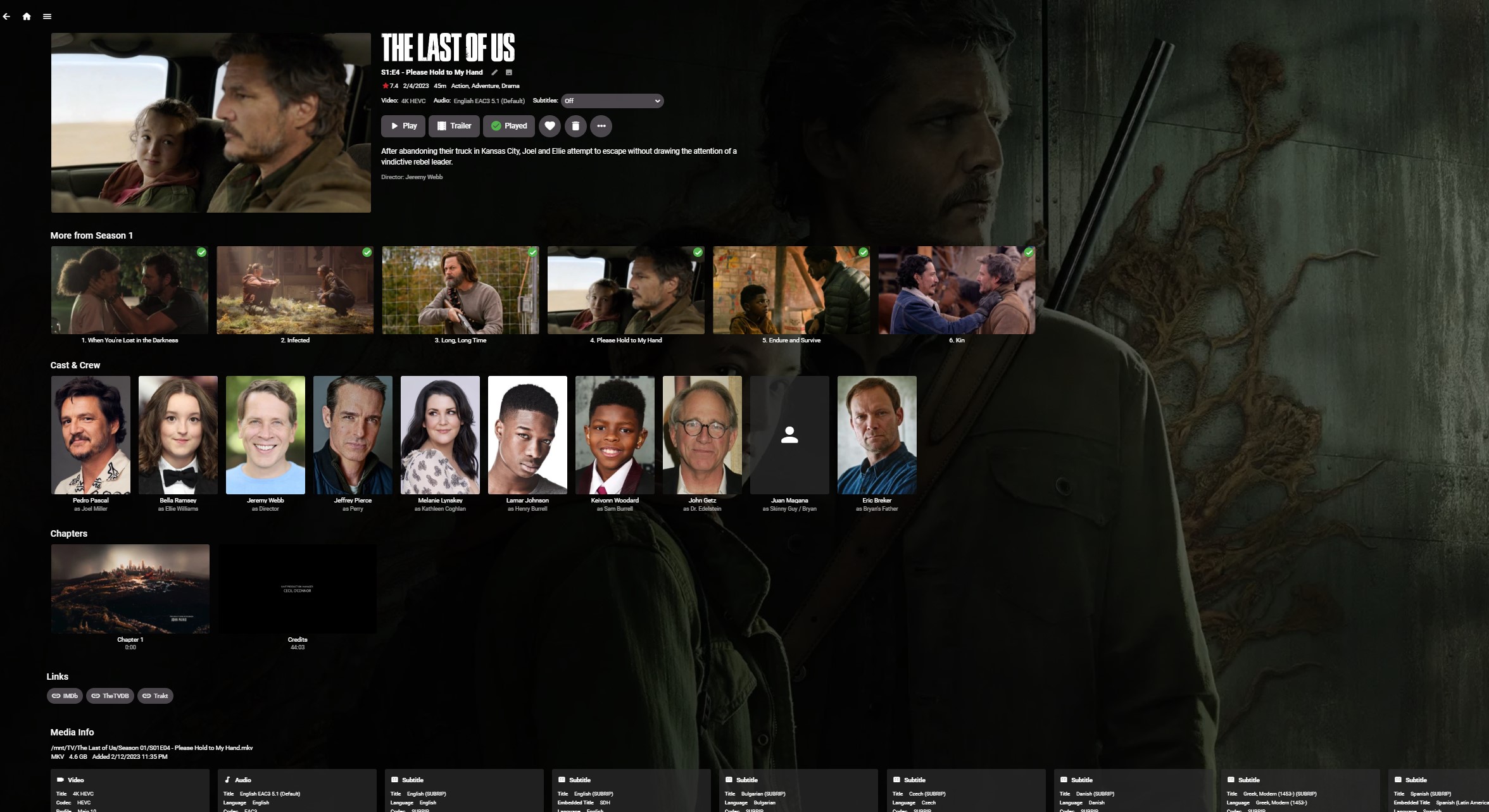

nickglott 5 Posted February 21, 2023 Posted February 21, 2023 Hello all, I have noticed that the 5 Min Chapter selcetion for Thumbnail images has been removed and can now only be set to 10s or Chapter Markers. I have done a bit of searching and it has seemed to provide better support for Roku's. I have always skiped rokus because the lack of codec support and the need to transcode more often. I do understand that people do use rokus and that the 5min images might have been an issue but from my experience most TV shows don't haved chapter markers added and by setting it to 10s seems a bit excessive. So why not keep the 5min option and just set the default to 10s so that there is the option I have since had to use chapters API and manuly add chapters every 5mins and this is unsustainable and 240 chapters for a 40min show is quite ridiculous not only for the disk space but to "seek" through. Please let me know if I am am missing something here but I have not seemed to find any other way to set it to 5min. Thanks.

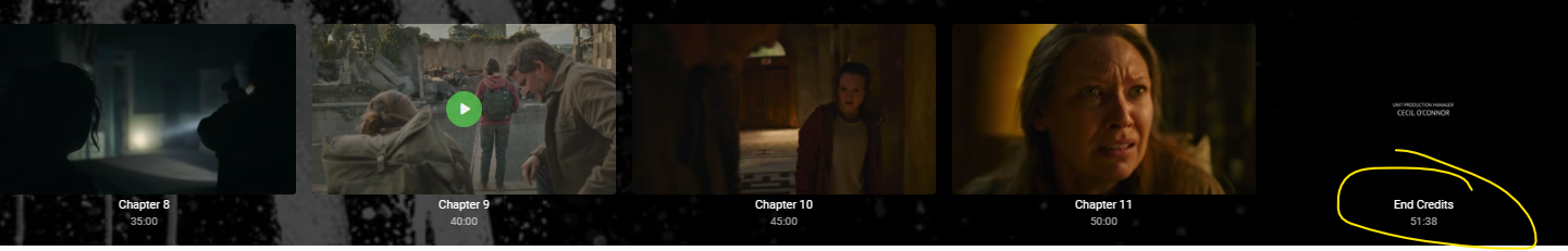

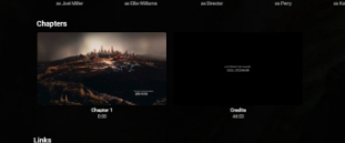

Solution Happy2Play 9814 Posted February 21, 2023 Solution Posted February 21, 2023 (edited) Well visual representation is embedded Chapters and images can come from Chapter Marker or Interval images. Emby Chapters can be created for all files that do not have embedded Chapter Menus. Here is file with stripped worthless chapter menus. Edited February 21, 2023 by Happy2Play

nickglott 5 Posted February 21, 2023 Author Posted February 21, 2023 Okay, I think you are correct. The last 3 shows I added has embeded that are just into and credits. The other 2 shows were Kdrams for my wife ans she is the one that pointed it out on them so I checked with the last show I added "the last of us" and it was the same. After looking at the settings I noticed the 5min is gone so assumed it was that. I have Chapters API installed but I dont see a way to do it automaticly when files are added, just automaticly like per episode if I click the button happen to notice it.

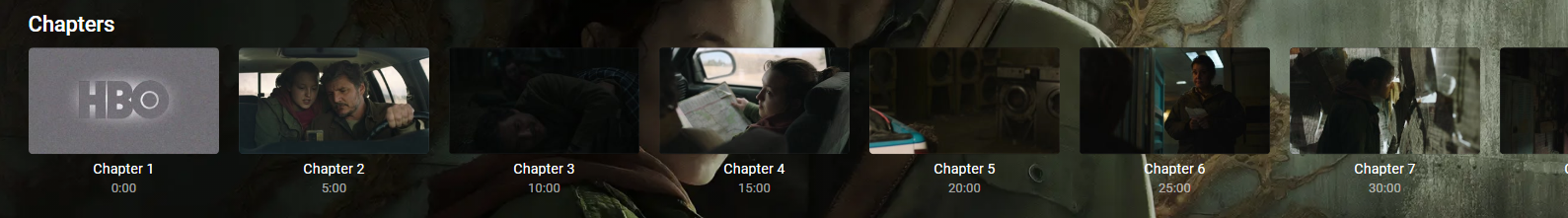

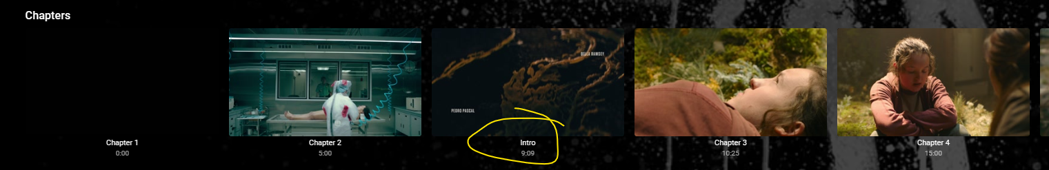

rbjtech 5345 Posted February 21, 2023 Posted February 21, 2023 (edited) Personally I think emby should have an option to merge the existing chapters with the 5 minute auto-chapters (with a little logic to avoid duplicate chapters if within say +/- 1 minute of each other) But as of today, because I use the Introskip Plugin which detects both the Intro and Credit markers anyway (and then creates well behaved chapters with logic..) - I simply strip the chapters out and let emby recreate them for consistent naming etc. If you use MKV's - then this is very easy to do without remuxing using mkvpropedit - see example below - mkvpropedit file.mkv --tags all: --chapters "" (Intro and End Credits are inserted by the Plugin (the 5 min auto chapters are inserted by Emby Core) Edited February 21, 2023 by rbjtech
