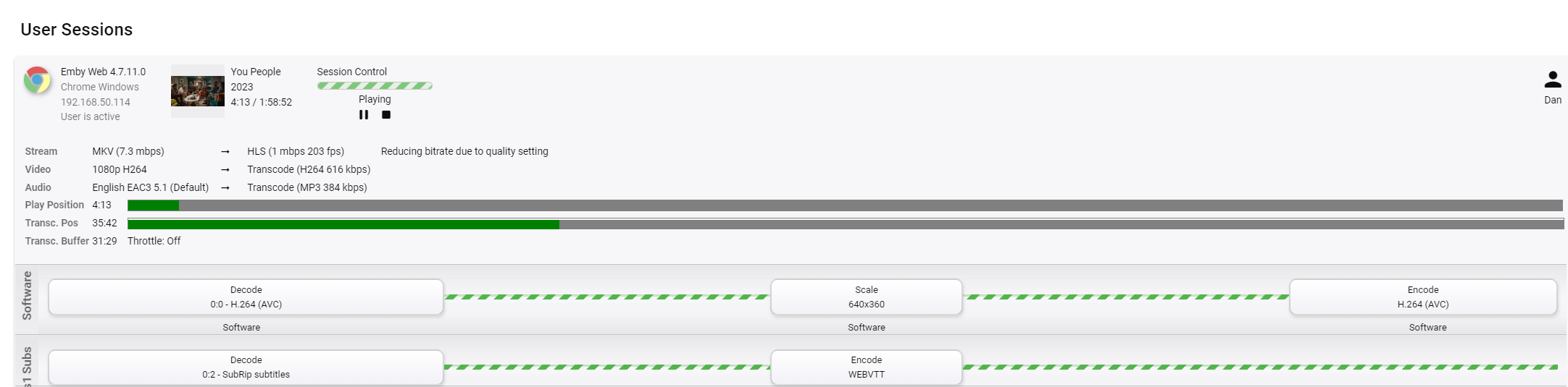

I've been getting by on software transcoding for awhile now but Im finally trying to fix whatever Im doing wrong with HW transcoding.
Short version - I've tried HW transcoding several times with this and a few other GPUs on this install and have never been able to get it to work.  I have a lifetime emby premiere subscription.  I attached some FFmpeg transcode logs and Im not sure what to make of them.  It looks like it recognizes the quadro as a decoder and then just doesnt use it.
Side note - the quadro should be an encoder as well, according to the matrix, but it doesn't show as one.  Thats what I'd really like to work because I want to take the load off of 4K transcodes, but right now I cant even get decode to work, so one step at a time I guess.

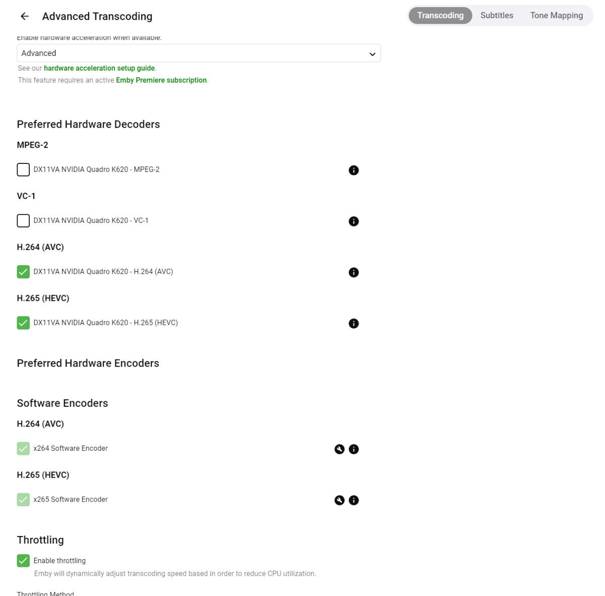

But with the current K620 it might be drives as Emby is using/only sees DX11VA.
23:17:29.469 [h264 @ 0000026c2b8c4cc0] No device available for decoder: device type d3d11va needed for codec h264.
23:17:29.471 Device setup failed for decoder on input stream #0:0 : Unknown error occurred
Info    Previous transcoding attempt failed. Falling back to software transcoding.
Well, that was dumb.  When I put this together for emby, the hardware was old enough that I assumed driver updates had stopped long ago and that I had the latest one pulled from windows update (especially since I had the nvidia tray icon and thought it must have gotten the whole package from Nvidia).  Well, that was wrong.  I just went and updated with the latest nvidia driver package and it enabled NVENC and NVDEC both in emby and in handbrake.  Im still kind of curious why the DXVA don't work as I remember doing older HW decodes with DXVA in the past, but whatever.  It works now.  I go through all the hard stuff trying to find a solution and it turns out to be something easy like a driver update....
