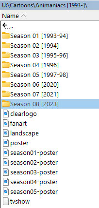

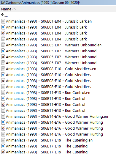

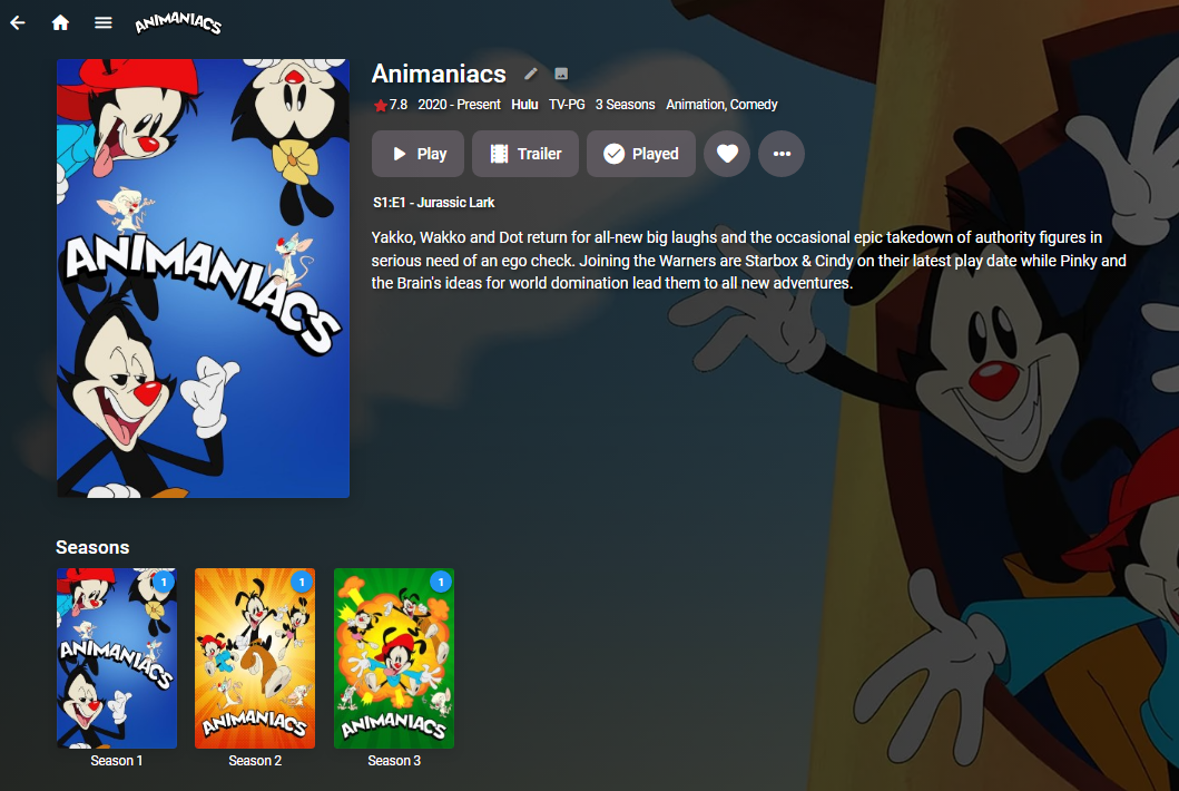

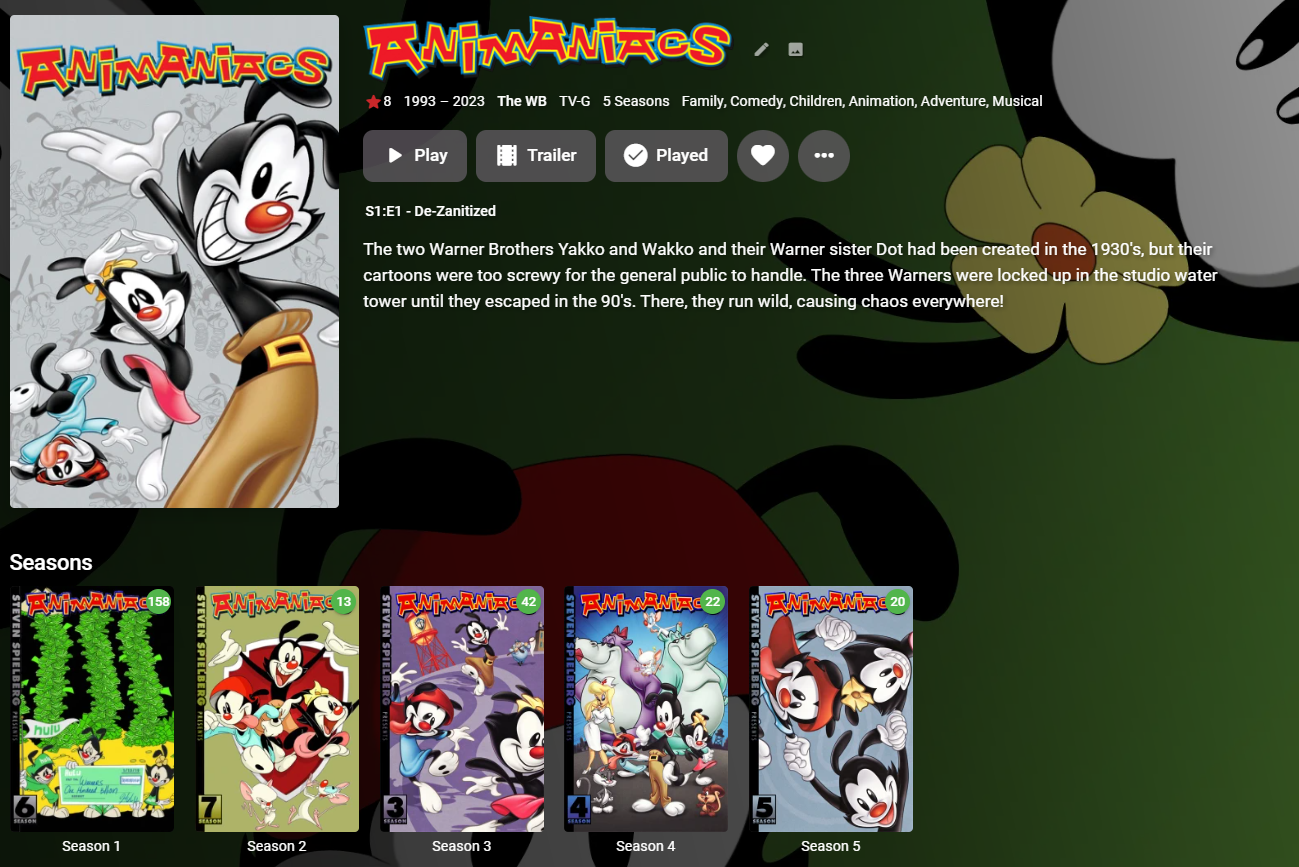

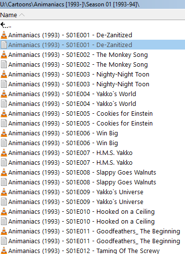

HTanner 6 Posted February 19, 2023 Author Posted February 19, 2023 Nope. Didn't work. Here's screenshots. Root folder. You can see only seasons 1 through 5 have been processed. Here's the beginning of the Season 01 folder, which works: Here's the beginning of the renamed Season 06, which still isn't getting loaded: Here's a screen shot of Emby after Scanning Library Files: As you can see, there's no seasons 6 through 8.

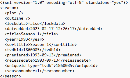

HTanner 6 Posted February 19, 2023 Author Posted February 19, 2023 I just checked the nfo's. Season 6 is being identified as Season 1, Season 7 as Season 2, and Season 8 as Season 3. I've tried editing the nfo's but Emby just replaces them. This is the nfo from Season 6: This is the nfo from Season 1: As you can see, it's misidentifying Seasons 6 through 8 as Seasons 1 through 3. And I have no idea how to fix this!

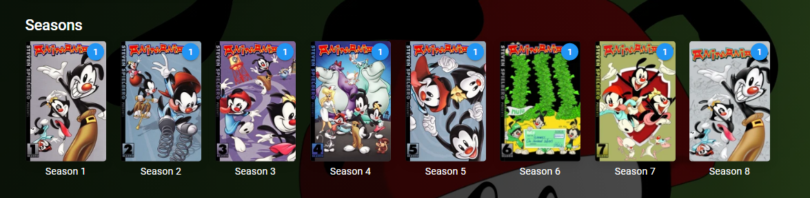

HTanner 6 Posted February 20, 2023 Author Posted February 20, 2023 @Happy2Play, that did it, thanks very much! The problem was caused because of how I originally loaded the show into Emby. I had only downloaded the new Animaniacs 2020 seasons (seasons 1 to 3) and named them as such, calling it "Animaniacs 2020". When Emby couldn't find the show, I looked at the TVDB and found that they only had the new seasons as added to the original 1993 Animaniacs show (the new seasons being 6 to 8). So I downloaded the first 5 seasons, renamed the folder to just "Animaniacs", and renamed the new seasons as 6 to 8, to align with the TVDB. Unfortunately, Emby could not handle this. It continued to see the new seasons 6 to 8 as the originally named seasons 1 to 3. Nothing I could do would fix this. Even re-identifying the show didn't help. To fix it, I moved the entire Animaniacs folder to another disk - this removed the show from Emby, and I confirmed that Animaniacs was no longer in Emby. I then manually renamed all the video files to properly line up with the TVDB episodes (all the new video files contain multiple episodes, which is how I suppose it was shown on TV). When I was done with that, I moved the Animaniacs folder back to the library. I then told Emby to scan that library, and it properly added Animaniacs now. The only remaining issue was that Emby added an end date of 1998 to the show, which is when it originally ended. So I just edited the metadata and removed the end date. It's perfect now! Thanks again, @Happy2Play! 1
