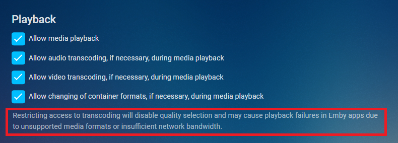

Happy2Play 9812 Posted February 18, 2023 Posted February 18, 2023 You can disable per user but if transcoding is required then the stream will fail if conversion is needed for other than bitrate. Just because everyone has fast connections does not mean those connections will not be throttled by ISP or have issues in the hops between point A and point B. Auto will almost always be conservative when it comes to the internet.
nouboh 4 Posted February 19, 2023 Author Posted February 19, 2023 Disabling transcoding entirely would be too much. I just need it to not be so conservative and to not transcode due to Auto quaility settings unless there are buffer errors. It should still transcode if the container or format is not supported by the client. In my opinion, it is too conservative. Anyway, worst case I'll just remove all references to the source IP address removing the `X-Real-Ip` and `X-Forwarded-For` headers before sending the requests to Emby. This way will behave like before since all connections will seem local. I never had any problem with that set up.
