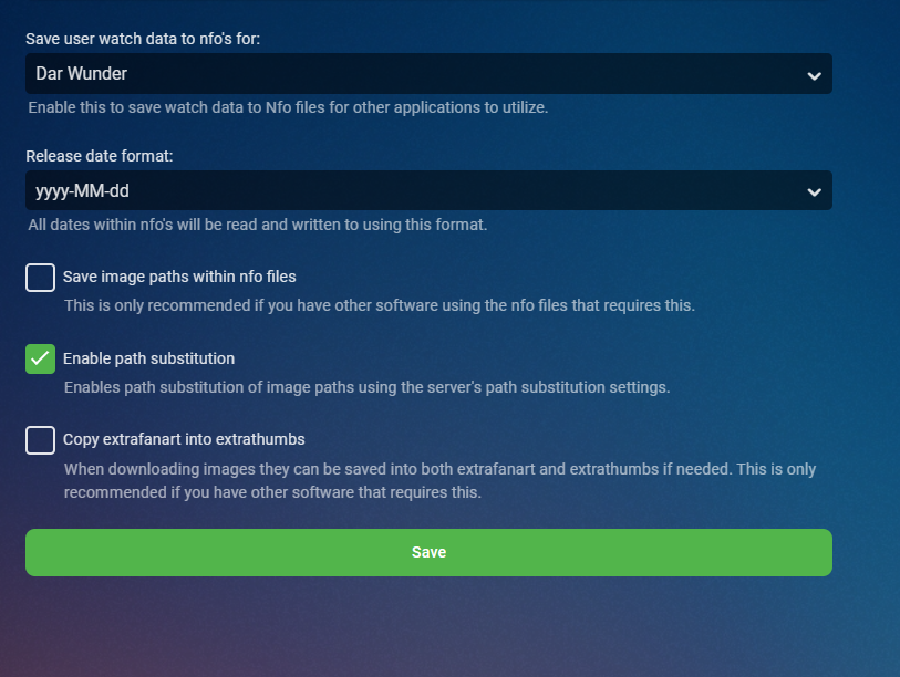

Luke 42185 Posted February 19, 2023 Posted February 19, 2023 Quote When an episode is watched, the .nfo file is updated with the playtime. Did you turn this on in nfo options?
DarWun 352 Posted February 19, 2023 Posted February 19, 2023 @LukeI probably did at some point, as that seems like something I would find useful. Where is that setting exactly? I've checked my TV library settings and I haven't stumbled across it yet. I'll spend a bit more time trying to find it. It in the meantime, here is the log file showing reanalysis of intro fingerprints after watching a single episode in a series. embyserver.txt
Luke 42185 Posted February 19, 2023 Posted February 19, 2023 1 hour ago, DarWun said: @LukeI probably did at some point, as that seems like something I would find useful. Where is that setting exactly? I've checked my TV library settings and I haven't stumbled across it yet. I'll spend a bit more time trying to find it. It in the meantime, here is the log file showing reanalysis of intro fingerprints after watching a single episode in a series. embyserver.txt 714.56 kB · 0 downloads It's in the nfo plugin options.
DarWun 352 Posted February 20, 2023 Posted February 20, 2023 17 minutes ago, Luke said: It's in the nfo plugin options. Okay...Save user watch data to nfo's is enabled. I'm fairly certain that was the default setting. I didn't realize there were actually settings for that plugin. I'll disable that, watch an episode, and post back as to whether or not intro reanalysis happens.
DarWun 352 Posted February 20, 2023 Posted February 20, 2023 (edited) @LukeI Disabled "Save user watch data to nfo's for" primary user. I watched a few episodes of a series. Intro reanalysis did not happen on the next library scan. Reenabled the setting for the primary user, watched an episode in the same series, and it did. embyserver.txt Edited February 20, 2023 by DarWun 1
