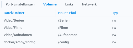

Tomiliy 1 Posted December 17, 2023 Posted December 17, 2023 (edited) Hallo, bei mir das selbe. Ich habe die neueste Version von Emby auf Docker installiert. Ver. 4.7.14.0 Ich habe Filme und Serien eingehängt, der Wizard kann aber keine Bibliothek finden Und ich weiß nicht warum. Ich hatte vorher JelliFin, da hat das einwandfrei geklappt. Logfile: 2023-12-17 20:00:14.431 Error LibraryMonitor: Error watching path: /Filme *** Error Report *** Version: 4.7.14.0 Command line: /system/EmbyServer.dll -programdata /config -ffdetect /bin/ffdetect -ffmpeg /bin/ffmpeg -ffprobe /bin/ffprobe -restartexitcode 3 Operating system: Linux version 3.10.105 (root@build6) (gcc version 4.9.3 20150311 (prerelease) (crosstool-NG 1.20.0) ) #25556 SMP Tue Mar 21 22:22:21 CST 2023 Framework: .NET 6.0.20 OS/Process: x64/x64 Runtime: system/System.Private.CoreLib.dll Processor count: 4 Data path: /config Application path: /system System.UnauthorizedAccessException: System.UnauthorizedAccessException: Access to the path '/Filme' is denied. ---> System.IO.IOException: Permission denied --- End of inner exception stack trace --- Edited December 17, 2023 by Tomiliy

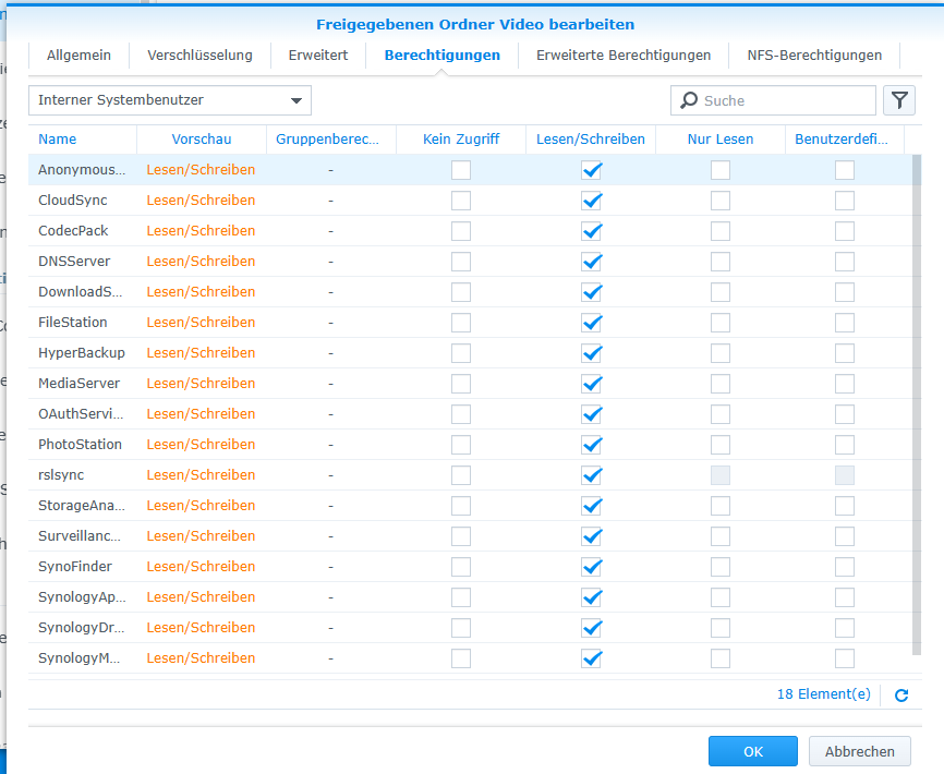

Tomiliy 1 Posted December 18, 2023 Posted December 18, 2023 Hi @Luke, thanks for helping. but i have DS412 with 6.2. i opend the rights panel but found no emby. Emby runs in a docker container i have opend the rights tool, but found no emby or docker... i gave rights to all i found, but nothing worked heres the log: 2023-12-18 08:09:19.931 Error ProviderManager: Error validating children for Filme 637 /Filme *** Error Report *** Version: 4.7.14.0 Command line: /system/EmbyServer.dll -programdata /config -ffdetect /bin/ffdetect -ffmpeg /bin/ffmpeg -ffprobe /bin/ffprobe -restartexitcode 3 Operating system: Linux version 3.10.105 (root@build6) (gcc version 4.9.3 20150311 (prerelease) (crosstool-NG 1.20.0) ) #25556 SMP Tue Mar 21 22:22:21 CST 2023 Framework: .NET 6.0.20 OS/Process: x64/x64 Runtime: system/System.Private.CoreLib.dll Processor count: 4 Data path: /config Application path: /system System.UnauthorizedAccessException: System.UnauthorizedAccessException: Access to the path '/Filme' is denied. ---> System.IO.IOException: Permission denied

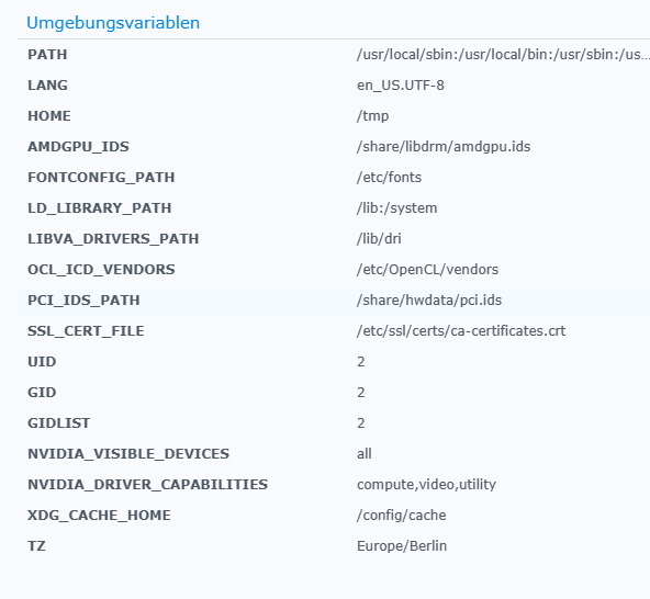

Tomiliy 1 Posted December 18, 2023 Posted December 18, 2023 Hi Luke, i has read this bevor i installed the docker container. i checked that i use UID, Guid instead of PUID, PGUID and so on. or is this wrong? What does the 2 mena?

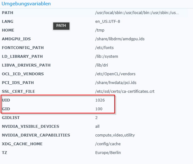

Tomiliy 1 Posted December 18, 2023 Posted December 18, 2023 i think i have a solution.. i change the numbers from UID and GUID. but i have no ideas what i changed.. what does the numbers mean?
Luke 42239 Posted December 18, 2023 Posted December 18, 2023 10 hours ago, Tomiliy said: i think i have a solution.. i change the numbers from UID and GUID. but i have no ideas what i changed.. what does the numbers mean? User Id and Group Id: https://medium.com/@mccode/understanding-how-uid-and-gid-work-in-docker-containers-c37a01d01cf 1
