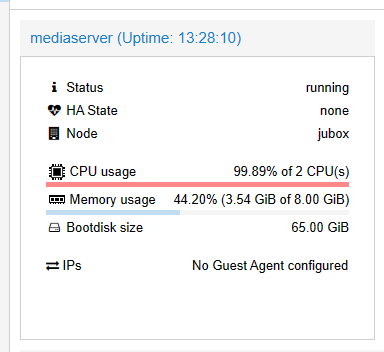

Guest Posted February 15, 2023 Posted February 15, 2023 Here are the examples, please serve your self emby audio video sync problem - Google Search Log files attached. Emby running on hypervisor proxmox 2 CPU Intel about 3+ GHz, VM OS Ubuntu server. Browser MS Edge. CPU usage during playback jumps between 99% to 0.5%. In the log files you can maybe see the transcoding session however log files were downloaded cca 10 minutes after I finished converting. The issue appears even if I do not convert during the playback. Please come back to me in case of any other info needed. ffmpeg-transcode-7ecd8b52-dc52-4332-8092-9c0b71281679_1.txt embyserver.txt

Guest Posted February 16, 2023 Posted February 16, 2023 Thanks for your post I will check browsers competencies as well, but whatever is happening with frames and their synchronization, in the origin of video playback this is not ok at all (screenshot). For example kodi can run playback on orange pi. Attached also actual log files. Currently no problem with syncing. Nothing has been changed since last time issue appeared. Testing with same video. I do not have more time now , maybe in the future. Currently I am still trying emby because of really nice tidy interface, If i will not find what is the reason of this behavior Any hints very well come. Cpu Intel I5 3,4GHz 2Core exclusively for emby on ubuntu. ffmpeg-transcode-7687e4bb-7eb9-4501-b193-a27f0b976468_1.txt embyserver (1).txt
