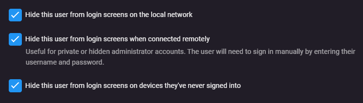

Ranse 6 Posted February 14, 2023 Posted February 14, 2023 Hello, I have recently configured Opnsense firewall , and followed this guide https://forum.opnsense.org/index.php?topic=24778.msg118832#msg118832 Emby is reachable through my DDNS. I am trying to limit access to the server from outside - by doing the following on the Emby server: Hide this user from login screens when connected remotely But I can still see the username when I got to https://mydomain.xxx Hide this user from login screens on the local network - unsure why Also , for some reason Emby server thinks of traffic as being local, because if I were to put the username in login screen it will not ask for password ( I have "do not require password on local network" enabled) Please let me know how can I fix this issue.
seanbuff 1356 Posted February 14, 2023 Posted February 14, 2023 I typically have all three options checked for my remote users: 31 minutes ago, Ranse said: Also , for some reason Emby server thinks of traffic as being local, because if I were to put the username in login screen it will not ask for password ( I have "do not require password on local network" enabled) I have no experience with OPNsense, but it sounds like maybe your Nginx config is not forwarding the Real-IP to the backend server (Emby in this case) It's hard to tell from the way your Nginx is set up, but what is in the drop-down box for this? Is there a way you can view the proxy.config file itself in text? Ultimately it will need at a minimum this header config: server { ... proxy_set_header X-Real-IP $remote_addr; proxy_set_header X-Forwarded-For $proxy_add_x_forwarded_for; ... }
