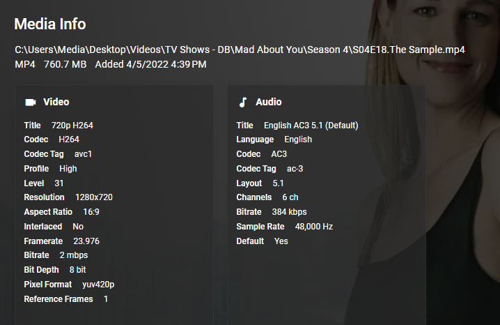

crossfire13148 29 Posted February 13, 2023 Posted February 13, 2023 Mad About You (1992) Season 4, Episode 18 is named "The Sample" it seems emby ignores anything with "SAMPLE" in it, as this episode does not show up in the library, create an NFO for, or even counts as a episode.
Happy2Play 9811 Posted February 13, 2023 Posted February 13, 2023 (edited) Correct, what size is the video. Per library options.xml are set to this files size to ignore. <SampleIgnoreSize>314572800</SampleIgnoreSize> example test file is larger that limit shows without issue. Edited February 13, 2023 by Happy2Play
crossfire13148 29 Posted February 21, 2023 Author Posted February 21, 2023 (edited) nice.... so cause all i have is 480p, that means emby wont display it for me.... Video: 480p H264 Audio: Und AAC stereo (Default) so do i kill the "sample" limit as i do not use sample at all? will an update over write that? (like how the 4.6 update killed my music folders even though i chose the strict structure) ? edit to say that file in 480p H264 comes out to 126.2MB Edited February 21, 2023 by crossfire13148
