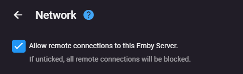

CharleyVarrick 284 Posted February 12, 2023 Author Posted February 12, 2023 1 hour ago, pwhodges said: You've uninstalled the Port Mapper plugin, so that option no longer appears. Paul I swear I didn't see the Network port mapping option even before I uninstalled the plugin. Can you give me a screen shot how this option looks like ?
Happy2Play 9800 Posted February 12, 2023 Posted February 12, 2023 3 minutes ago, CharleyVarrick said: I swear I didn't see the Network port mapping option even before I uninstalled the plugin. Can you give me a screen shot how this option looks like ? With Remote connection enable via Network page 1

seanbuff 1353 Posted February 12, 2023 Posted February 12, 2023 7 hours ago, ebr said: This is all that is actually required. If nothing can get in from your router, all the rest is just redundant. Agree, but if you don't want to touch any of your router config, etc. and just "temporarily" disable remote connections from an Emby perspective - shouldn't this single option be all that's required? [Network] tab Shouldn't need to touch any User config or anything else, no? 3
Luke 42186 Posted February 13, 2023 Posted February 13, 2023 3 hours ago, seanbuff said: Agree, but if you don't want to touch any of your router config, etc. and just "temporarily" disable remote connections from an Emby perspective - shouldn't this single option be all that's required? [Network] tab Shouldn't need to touch any User config or anything else, no? Yes that will work.
