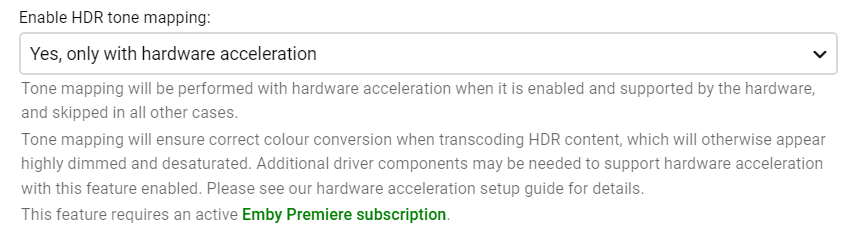

Happy2Play 9812 Posted February 15, 2023 Posted February 15, 2023 (edited) 7 hours ago, Hyy2001X said: Here is the server and ffmpeg log, thanks! embyserver.txt 18.5 kB · 0 downloads ffmpeg-transcode-3e35e51d-a8ae-4b09-a5e5-779de0026463_1.txt 23.85 kB · 1 download Doesn't look like you enabled it. Info Tone Mapping would be desired, but VAAPI tone mapping mapping method is set to 'none' @softworkzare there separate settings? Or is the diagnostic plugin needed. Edited February 15, 2023 by Happy2Play

softworkz 5133 Posted February 15, 2023 Posted February 15, 2023 39 minutes ago, Happy2Play said: @softworkzare there separate settings? Or is the diagnostic plugin needed. The selection on the Transcoding page can switch it on or off only. With the Diagnostics Plugin you get more detailed control (and it's a bit better understandable).

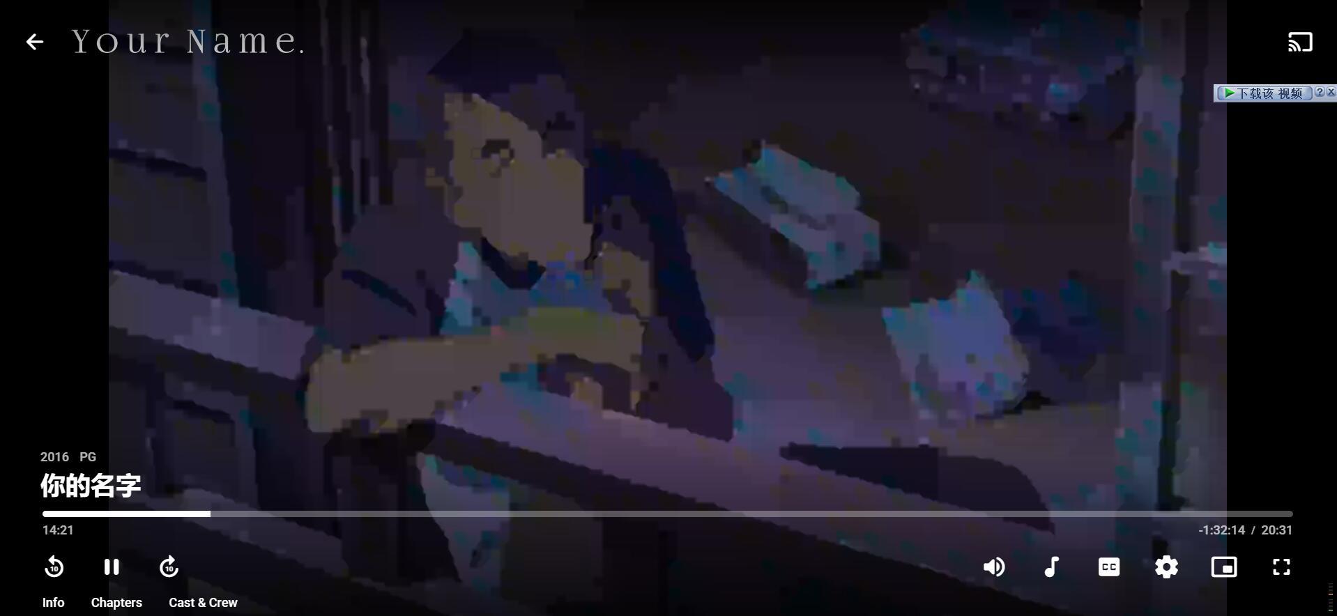

Hyy2001X 1 Posted February 16, 2023 Author Posted February 16, 2023 I upgraded the image to the latest version 'emby/embyserver:4.7.11.0', and installed 'Diagnostic Options 4.7.0.60' plugin Now I enabled 'Tone Mapping' in 'Diagnostic Options 4.7.0.60' plugin, I find that the GPU does not work and the CPU is full when transcoding, the picture is very blurred, like p2.jpg Here is the latest server and ffmpeg log, photos, thanks for helping! embyserver.txt ffmpeg-transcode-8222a280-05eb-4f5f-ab6f-69385474e85f_1.txt
