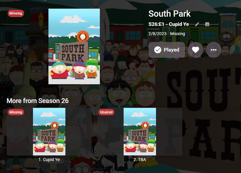

Happy2Play 9814 Posted February 10, 2023 Posted February 10, 2023 (edited) I see the same issue on SeasonID but assume @Lukeis no longer populating it as no NEW season of any series shows season providerid for me. (actually seems sporadic as some do and some don't). But can say I don't see this issue on either stable or beta. 4.7.11.0 - Only have user Display option enabled and shows the Upcoming info and tomorrow the missing virtual will disappear. From Upcoming but same appears in Show/Season level. Really can't see this being a platfom issue though. But really have no idea if this is only affecting one show beside maybe LOCKED metadata. Edited February 10, 2023 by Happy2Play

Luke 42288 Posted February 10, 2023 Posted February 10, 2023 5 hours ago, HawkXP71 said: Both are enabled. Both what exactly?
HawkXP71 112 Posted February 10, 2023 Author Posted February 10, 2023 1 hour ago, Luke said: Both what exactly? I was asked to confirm show missing episodes was turned on in both user display area and the library

Luke 42288 Posted February 10, 2023 Posted February 10, 2023 How many episodes do you have for the show?
HawkXP71 112 Posted February 10, 2023 Author Posted February 10, 2023 2 minutes ago, Luke said: How many episodes do you have for the show? Everyone except for S26E02 which hasnt premiered yet (317 episodes or so) I have about 7900 episodes in total.
HawkXP71 112 Posted February 10, 2023 Author Posted February 10, 2023 So good news/bad news.. Setup a test server on my PC (not the same OS of course). Made sure both my display settings and the library settings had "show missing episodes" turned on. Added the South Park Directory (Same name, tmdbid based) and the season 26 folder (same exact name), no MKV files, just folder names And it worked perfectly Im not sure if that says its a OS Specific issue? or if my DB is corrupt? Or if something else is different. Whats the best way to debug this? Is it possible to setup to copies of emby server (different ports/locations)? Is there a way to use an actual debugger connected to a remote application? Im a 30+ year professional software developer, I can help figure this out
HawkXP71 112 Posted February 10, 2023 Author Posted February 10, 2023 I did notice a a setting that is different in the library setup, "Save metadata and images as hidden files" Im assuming thats a windows only option? Though Im not sure why.. I know its an attribute on windows and not linux, but on linux just start it with a period, and have the system look for "xxx.nfo" or ".xxx.nfo"
HawkXP71 112 Posted February 10, 2023 Author Posted February 10, 2023 Ok, so some further testing. I copied the complete set of data from my server to my test machine. I made two copies, one "raw", only the MKV files. One containing all the other generated files. I then uninstalled emby with the "delete everything" switch. I then installed it, created a new library, made sure all the settings were correct. When I added with the data. The missing show is NOT shown. Im going to now reinstall, and use the raw version
HawkXP71 112 Posted February 10, 2023 Author Posted February 10, 2023 So following. I tried another experiemtn. On the server, I removed the South Park directory. Then I created the directory and the season 26 directory. No media files, just the directory. It created the upcoming episode I dont know what will happen with episode 3, but I think at this point, Im going to try and get some work done
Luke 42288 Posted February 10, 2023 Posted February 10, 2023 1 hour ago, HawkXP71 said: Everyone except for S26E02 which hasnt premiered yet (317 episodes or so) I have about 7900 episodes in total. In order to get missing episodes, every single season must be tagged with the season number in the emby metadata editor, and every single episode must be tagged with the episode number and season number in the metadata editor. You probably have at least one episode or season that is missing this information. Why is this required, because users complain that they get missing episode entries for episodes they already have, which might be true, but there's no way for the server to know this without being able to match up the numbers. It's an escape I added a couple years ago to avoid having to troubleshoot that.
HawkXP71 112 Posted February 10, 2023 Author Posted February 10, 2023 10 minutes ago, Luke said: In order to get missing episodes, every single season must be tagged with the season number in the emby metadata editor, and every single episode must be tagged with the episode number and season number in the metadata editor. You probably have at least one episode or season that is missing this information. Why is this required, because users complain that they get missing episode entries for episodes they already have, which might be true, but there's no way for the server to know this without being able to match up the numbers. It's an escape I added a couple years ago to avoid having to troubleshoot that. OK. So what do I look for?
Luke 42288 Posted February 10, 2023 Posted February 10, 2023 7 minutes ago, HawkXP71 said: OK. So what do I look for? every single season must be tagged with the season number in the emby metadata editor, and every single episode must be tagged with the episode number and season number in the metadata editor.
HawkXP71 112 Posted February 10, 2023 Author Posted February 10, 2023 9 minutes ago, Luke said: every single season must be tagged with the season number in the emby metadata editor, and every single episode must be tagged with the episode number and season number in the metadata editor. Is this stored in the nfo files? Or do I have to do it by hand?
HawkXP71 112 Posted February 10, 2023 Author Posted February 10, 2023 15 minutes ago, Luke said: every single season must be tagged with the season number in the emby metadata editor, and every single episode must be tagged with the episode number and season number in the metadata editor. In the season 26 NFO (havent checked others) its missing both the tvdbid and the uniqueid type="tvdb"
