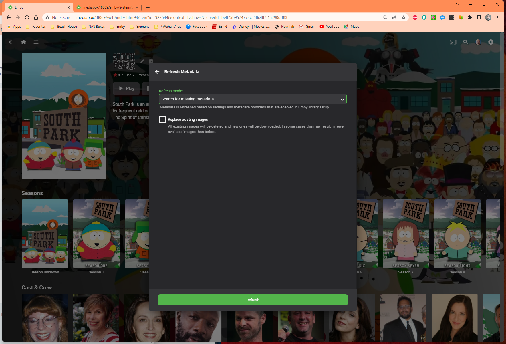

Happy2Play 9814 Posted February 9, 2023 Posted February 9, 2023 3 minutes ago, HawkXP71 said: How do I "refresh search for the missing show"? Click on South Park series and Refresh / Search for Missing. User authentication should be irrelevant. When you click on an Upcoming episode does it show all future/unaired episode? Only guess would be do you have LOCKED metadata on the Series?
HawkXP71 112 Posted February 10, 2023 Author Posted February 10, 2023 16 minutes ago, Happy2Play said: Click on South Park series and Refresh / Search for Missing. User authentication should be irrelevant. When you click on an Upcoming episode does it show all future/unaired episode? Only guess would be do you have LOCKED metadata on the Series? I assume you mean the following? If so, I just kicked it off. I rotated the log before hand, so once it finishes, Ill update the log to see if there is anything of concern.

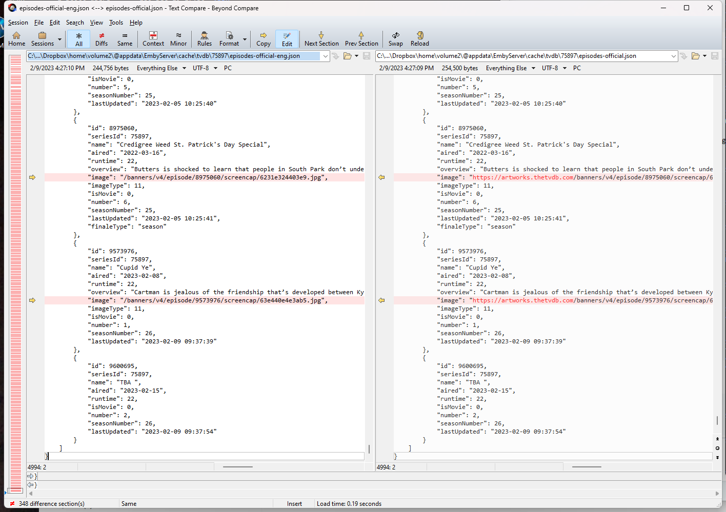

Happy2Play 9814 Posted February 10, 2023 Posted February 10, 2023 1 minute ago, HawkXP71 said: I assume you mean the following? Yes Can you look in your Emby cache\tvdb\75897 folder at the episode json file at the bottom. beatified the flattened json file. }, { "id": 9573976, "seriesId": 75897, "name": "Cupid Ye", "aired": "2023-02-08", "runtime": 22, "overview": "Cartman is jealous of the friendship that’s developed between Kyle and Tolkien and decides to do something about it.", "image": "/banners/v4/episode/9573976/screencap/63e440e4e3ab5.jpg", "imageType": 11, "isMovie": 0, "number": 1, "seasonNumber": 26, "lastUpdated": "2023-02-09 17:46:52" }, { "id": 9600695, "seriesId": 75897, "name": "TBA ", "aired": "2023-02-15", "runtime": 22, "isMovie": 0, "number": 2, "seasonNumber": 26, "lastUpdated": "2023-02-09 17:47:50" }
Happy2Play 9814 Posted February 10, 2023 Posted February 10, 2023 But this could be an api cache issue as they have a lastupdated of today.
Happy2Play 9814 Posted February 10, 2023 Posted February 10, 2023 Last resort would be deleting the \cache\tvdb folder and do a library scan to get cache files again. But if their api is not returning updated info for you then it may be a matter of waiting. But pulling directly from their Swagger returns correct info, same as what I get in Emby. Would assume you get the same cache as I do here in the Northwest.
HawkXP71 112 Posted February 10, 2023 Author Posted February 10, 2023 Just now, Happy2Play said: But this could be an api cache issue as they have a lastupdated of today. 5 minutes ago, Happy2Play said: Yes Can you look in your Emby cache\tvdb\75897 folder at the episode json file at the bottom. beatified the flattened json file. }, { "id": 9573976, "seriesId": 75897, "name": "Cupid Ye", "aired": "2023-02-08", "runtime": 22, "overview": "Cartman is jealous of the friendship that’s developed between Kyle and Tolkien and decides to do something about it.", "image": "/banners/v4/episode/9573976/screencap/63e440e4e3ab5.jpg", "imageType": 11, "isMovie": 0, "number": 1, "seasonNumber": 26, "lastUpdated": "2023-02-09 17:46:52" }, { "id": 9600695, "seriesId": 75897, "name": "TBA ", "aired": "2023-02-15", "runtime": 22, "isMovie": 0, "number": 2, "seasonNumber": 26, "lastUpdated": "2023-02-09 17:47:50" } 3 minutes ago, Happy2Play said: But this could be an api cache issue as they have a lastupdated of today. I dont have an episodes.json, I do have episodes-official.json, episodes-official-eng.json and seasons.json Season 26 is showing up in the seasons.json { "id": 2043040, "seriesId": 75897, "type": { "id": 1, "name": "Aired Order", "type": "official" }, "number": 26, "nameTranslations": [], "overviewTranslations": [], "image": "https://artworks.thetvdb.com/banners/v4/season/2043040/posters/63d4a430131fb.jpg", "imageType": 7, "companies": [ { "id": 0, "primaryCompanyType": 0 } ] }, And interesting enough, the episodes-official-eng.json and episodes-official.json both include the missing episode, { "id": 9573976, "seriesId": 75897, "name": "Cupid Ye", "aired": "2023-02-08", "runtime": 22, "overview": "Cartman is jealous of the friendship that’s developed between Kyle and Tolkien and decides to do something about it.", "image": "/banners/v4/episode/9573976/screencap/63e440e4e3ab5.jpg", "imageType": 11, "isMovie": 0, "number": 1, "seasonNumber": 26, "lastUpdated": "2023-02-09 09:37:39" }, { "id": 9600695, "seriesId": 75897, "name": "TBA ", "aired": "2023-02-15", "runtime": 22, "isMovie": 0, "number": 2, "seasonNumber": 26, "lastUpdated": "2023-02-09 09:37:54" } The only difference between the official and official-eng is the location of the image

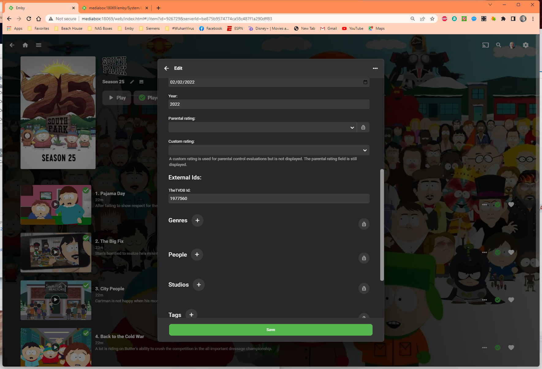

HawkXP71 112 Posted February 10, 2023 Author Posted February 10, 2023 One thing I just noticed. For season 25, the metainfo contains a TVDB id, but Season 26 does not
Happy2Play 9814 Posted February 10, 2023 Posted February 10, 2023 You won't see anything else as Emby gets everything in one pull and process everything from that json file behind the scenes. But everything appears to be correct so I am not sure why you are not seeing this info in the UI especially if it is only on one show. 4 minutes ago, HawkXP71 said: One thing I just noticed. For season 25, the metainfo contains a TVDB id, but Season 26 does not I can say I am seeing the same thing for season number.
