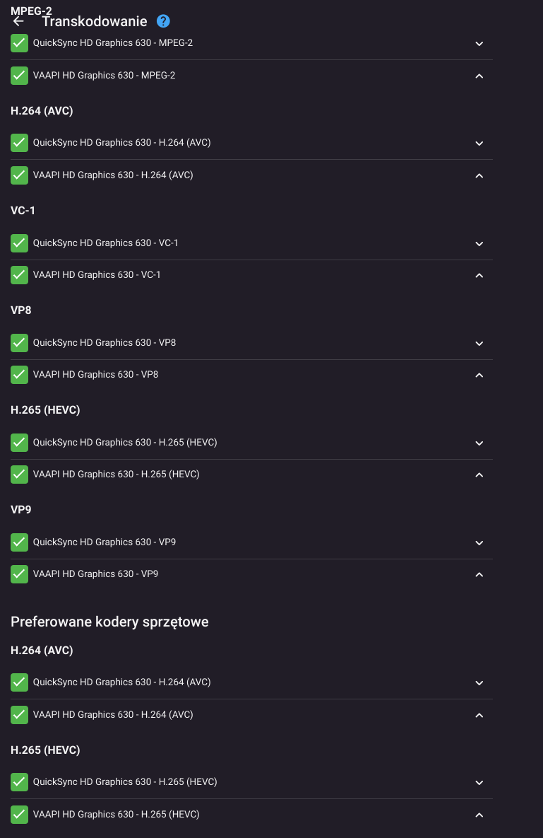

Przemek 70 Posted February 9, 2023 Author Posted February 9, 2023 8 minutes ago, seanbuff said: Actually, QSV should already be available - are you able to disable VAAPI and select QSV instead to test if there is any difference? I cannot find that option. Can You tell me where to find that settings?
seanbuff 1356 Posted February 9, 2023 Posted February 9, 2023 2 minutes ago, Przemek said: I cannot find that option. Can You tell me where to find that settings? Transcoding > Select 'Advanced'
seanbuff 1356 Posted February 9, 2023 Posted February 9, 2023 Make sure to "test" it first, as you may run into issues as described here - where it's stated that should be fixed in 4.8.x release https://emby.media/community/index.php?/topic/113702-unable-to-hard-decode-h265-video/&do=findComment&comment=1199918 Seems VAAPI works better for the meantime while you're still on 4.7.x stable.

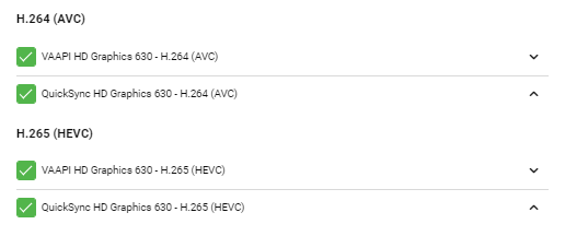

Przemek 70 Posted February 9, 2023 Author Posted February 9, 2023 (edited) OK. How to test. Just play something? It's OK like that? Edited February 9, 2023 by Przemek
seanbuff 1356 Posted February 9, 2023 Posted February 9, 2023 25 minutes ago, Przemek said: OK. How to test. Just play something? It's OK like that? Yes, simulate some transcoding sessions (by reducing in-app quality, etc) Also try completely disabling VAAPI, so that QuickSync is the only option.
