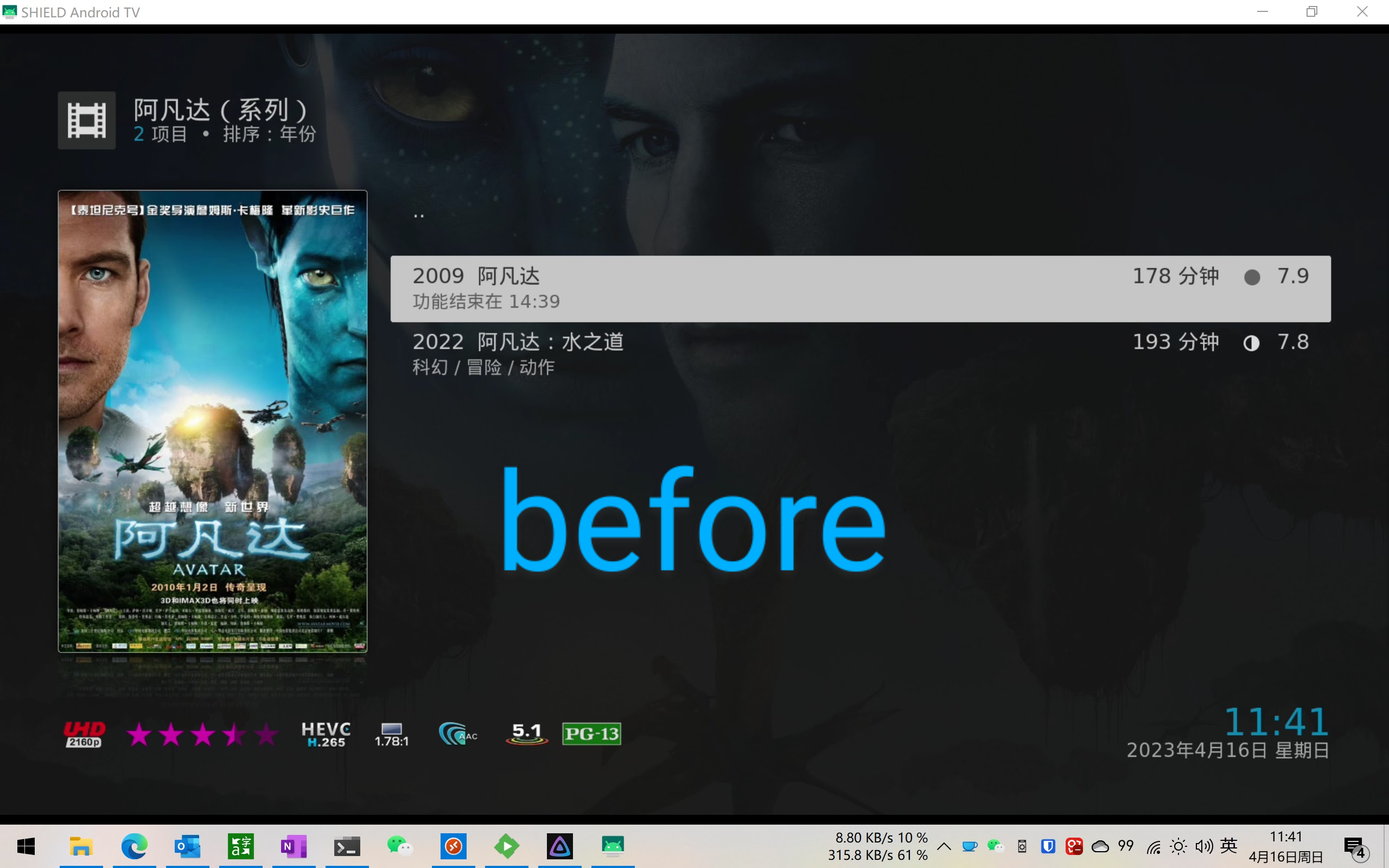

chuwz 12 Posted April 16, 2023 Posted April 16, 2023 I found a BUG, When I change the path of a movie, for example from "/mnt/movie folder A/avatar (2009)" to"/mnt/movie folder B/avator (2009)", then Emby will rescan and detect the movie, at this time, look at the movie collection, web Emby everything is fine, but the movie in Kodi Emby's movie set will disappear (such as pictures) I found a solution, which is to use "refresh collection" in the setting of Emby Next Gen, but manually refreshing the collection before each time you use Kodi to browse the movie is too cumbersome, can you fix this bug so that the collection can be updated correctly and automatically?
quickmic 1709 Posted April 16, 2023 Author Posted April 16, 2023 (edited) 8 hours ago, LittleWizard said: 8.1.1 was great to me. 8.1.2 not working for resume point. It doesn't save any resume point! Reverting back to 8.1.1 Yes it does. The actual question is, why it's not in your setup. Without proper information, I cannot help. Do you use Emby server beta version >19? I'm not active testing >19 versions, only if problems are reported. Edited April 16, 2023 by quickmic
quickmic 1709 Posted April 16, 2023 Author Posted April 16, 2023 1 hour ago, chuwz said: I found a BUG, When I change the path of a movie, for example from "/mnt/movie folder A/avatar (2009)" to"/mnt/movie folder B/avator (2009)", then Emby will rescan and detect the movie, at this time, look at the movie collection, web Emby everything is fine, but the movie in Kodi Emby's movie set will disappear (such as pictures) I found a solution, which is to use "refresh collection" in the setting of Emby Next Gen, but manually refreshing the collection before each time you use Kodi to browse the movie is too cumbersome, can you fix this bug so that the collection can be updated correctly and automatically? Currently, this is a limitation. Boxset/collection changes must be (re)synced manually as you did.
chuwz 12 Posted April 16, 2023 Posted April 16, 2023 6 minutes ago, quickmic said: Currently, this is a limitation. Boxset/collection changes must be (re)synced manually as you did. Thanks for your reply, is it possible to remove this limitation in a future release?
quickmic 1709 Posted April 16, 2023 Author Posted April 16, 2023 2 minutes ago, chuwz said: Thanks for your reply, is it possible to remove this limitation in a future release? I tried several approaches to fix it but currently no proper solution found. The problem, Emby server does not report Boxset/Collection changes (as it does for other content). The only way would be, checking Boxsets/collection after each movie change. This would massively delay updates -> completely useless. So no, currently no solution on the horizon.
chuwz 12 Posted April 16, 2023 Posted April 16, 2023 2 hours ago, quickmic said: I tried several approaches to fix it but currently no proper solution found. The problem, Emby server does not report Boxset/Collection changes (as it does for other content). The only way would be, checking Boxsets/collection after each movie change. This would massively delay updates -> completely useless. So no, currently no solution on the horizon. Perhaps you can add a function that is not enabled by default, this function is: after each update of the database, add the "refresh collection" operation. This would at least solve this problem temporarily, because I don't care that kodi takes a long time updating the database. But the collection does not work properly, which seriously affects my viewing series when watching movies. Would you like to add this feature in future updates? You can choose not to turn on this feature by default, so that it will not affect most people. But for those who have this need, the problem can be solved.
