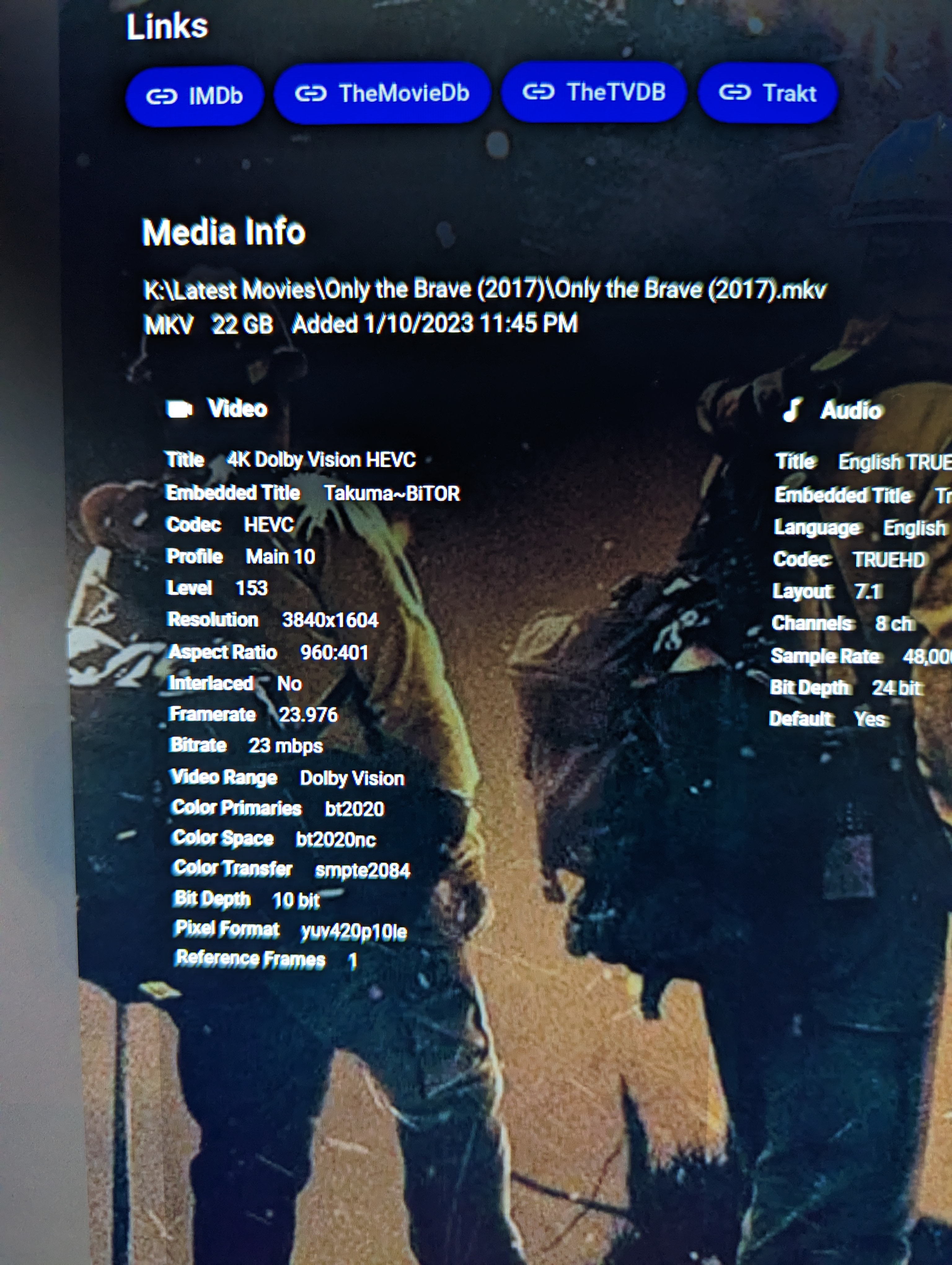

Pejamas 58 Posted March 31, 2023 Posted March 31, 2023 I can't get the HDR codec flags to appear, not sure if im missing something.
quickmic 1709 Posted March 31, 2023 Author Posted March 31, 2023 (edited) 4 hours ago, djhifi said: Running server version .21 and E4K 8.1.0, the database reset is prompting and everything goes well when I relaunch KODI and select libraries, but the scan eventually finishes with only 20% of everything scanned. I'm trying again but only selecting Movies to see what happens. EDIT: Not working. Maybe because server is still .21? Kodi log attached. Will update to .28 and try again. kodi.log 2.17 MB · 0 downloads Yes quite sure it's related to .21. Server times out -> 2023-03-31 01:55:15.090 T:24295 error <general>: EMBY.emby.http: [ ServerReadTimeout ] Lower the sync paging to 1 - 5, but actually you should upgrade to .27, yes. Edited March 31, 2023 by quickmic
quickmic 1709 Posted March 31, 2023 Author Posted March 31, 2023 (edited) 3 hours ago, Pejamas said: I can't get the HDR codec flags to appear, not sure if im missing something. How Kodi shows the tags is up to Kodi skin. If the tags are set depends on Emby server information. The plugin uses the codec tags from Emby server: "hvc1" means in Kodi terms: "hdr10" "dvhe" means "dolbyvision" If the info is not available on Emby server, the plugin will not set the tag. "hlg" is currently never set, cause Emby server never reported a codec tag for hlg in my tests. If you know the codec tag for hlg, I'll add this too. Edited March 31, 2023 by quickmic
Pejamas 58 Posted March 31, 2023 Posted March 31, 2023 1 hour ago, quickmic said: How Kodi shows the tags is up to Kodi skin. If the tags are set depends on Emby server information. The plugin uses the codec tags from Emby server: "hvc1" means in Kodi terms: "hdr10" "dvhe" means "dolbyvision" If the info is not available on Emby server, the plugin will not set the tag. "hlg" is currently never set, cause Emby server never reported a codec tag for hlg in my tests. If you know the codec tag for hlg, I'll add this too. I see the issue now, I don't have any codec tags in my library files. I'm assuming this is something I need to manually add, using the tag editing tool for example?
Pejamas 58 Posted March 31, 2023 Posted March 31, 2023 (edited) Should also mention All my HDR/DV files are MKV. In the mediainfo section of the files like in your photo both Dolby Vision and HDR10 are listed in the Video Range field. Edited March 31, 2023 by Pejamas Add pics
quickmic 1709 Posted March 31, 2023 Author Posted March 31, 2023 Just now, Pejamas said: Should also mention All my HDR/DV files are MKV. In the mediainfo section of the files like in your photo both Dolby Vision and HDR10 are listed in the Video Range field. Well this is maybe a question for Server devs. I assume this info is automatically detect by Servers ffmpeg analysis. I doubt that this can be set manually.
Pejamas 58 Posted March 31, 2023 Posted March 31, 2023 1 minute ago, quickmic said: Well this is maybe a question for Server devs. I assume this info is automatically detect by Servers ffmpeg analysis. I doubt that this can be set manually. I edited my previous comment to add photos, but yeah guess its above my head. Not a big deal since I custom make all my posters to show the 4k/dv banner anyway.
quickmic 1709 Posted March 31, 2023 Author Posted March 31, 2023 5 minutes ago, Pejamas said: I edited my previous comment to add photos, but yeah guess its above my head. Not a big deal since I custom make all my posters to show the 4k/dv banner anyway. Another way to tag videos is by filename. Somthing like name (2019)(1080p).imax.hdr.10bit.atmos.mkv https://kodi.wiki/view/Media_flags https://forum.kodi.tv/showthread.php?tid=366049 Don't ask for details, this is Kodi stuff and I'm not using those tags in filenames. But the plugin supports filenaming tags
