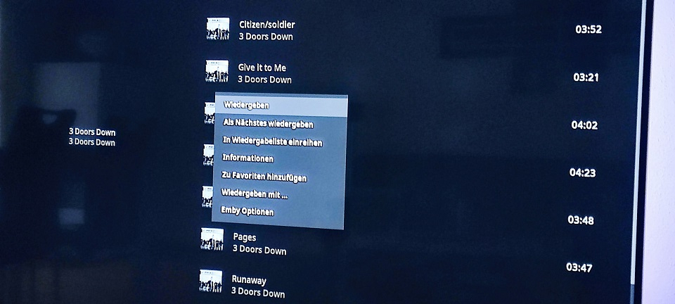

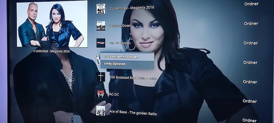

mad-max 2 Posted November 26, 2023 Posted November 26, 2023 I use Emby Next Gen version 18.2.13 on Kodi 20.02. My music library is stored as a dynamic list as a folder view in Kodi. When I select a music folder, I can no longer specify that I want to play from this folder. I can only play it if I select a file. How can I play all the songs directly from a folder? With the add-on in version 17 this was actually still possible. Many thanks for your help!

quickmic 1709 Posted November 27, 2023 Author Posted November 27, 2023 14 hours ago, mad-max said: I use Emby Next Gen version 18.2.13 on Kodi 20.02. My music library is stored as a dynamic list as a folder view in Kodi. When I select a music folder, I can no longer specify that I want to play from this folder. I can only play it if I select a file. How can I play all the songs directly from a folder? With the add-on in version 17 this was actually still possible. Many thanks for your help! I'll check it.

mad-max 2 Posted November 27, 2023 Posted November 27, 2023 (edited) 4 hours ago, quickmic said: I'll check it. Thank you! The same problem exists with mixed content. Edited November 27, 2023 by mad-max 1
quickmic 1709 Posted November 27, 2023 Author Posted November 27, 2023 11 hours ago, mad-max said: Thank you! The same problem exists with mixed content. Will be addressed in 9.X version. 1
mad-max 2 Posted November 28, 2023 Posted November 28, 2023 11 hours ago, quickmic said: Will be addressed in 9.X version. OK thank you. Can you say when version 9 will come? Is there a workaround for version 8 until then?
quickmic 1709 Posted November 28, 2023 Author Posted November 28, 2023 1 hour ago, mad-max said: OK thank you. Can you say when version 9 will come? Is there a workaround for version 8 until then? I hope in one or two weeks. Why not using synced nodes?
mad-max 2 Posted November 28, 2023 Posted November 28, 2023 46 minutes ago, quickmic said: I hope in one or two weeks. Why not using synced nodes? There is no folder view for synchronized nodes. correct?
quickmic 1709 Posted November 28, 2023 Author Posted November 28, 2023 11 minutes ago, mad-max said: There is no folder view for synchronized nodes. correct? Yes, correct. Usually Folderviews are only necessary for edge cases and your folder structure doesn't seem odd.
mad-max 2 Posted November 28, 2023 Posted November 28, 2023 13 minutes ago, quickmic said: Yes, correct. Usually Folderviews are only necessary for edge cases and your folder structure doesn't seem odd. OK... Can I then switch back to emby-next-gen-7.x? What do you think?
