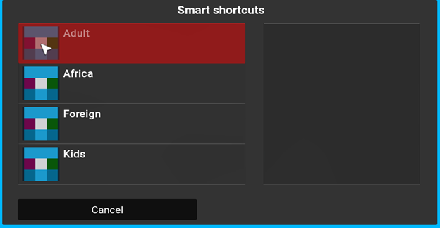

t123thomas 63 Posted October 30, 2023 Posted October 30, 2023 Hi quickmic, Please you check version 8.2.15, it appear that smart short cut is not working in LE 11 and 12, can you take, as I have make several attempts to include in the Titan skin where it only point to Plugin.emby not including next-gen. After the changes every changes appears to shoe yet the smart short refuses to show. Thanks for your supports

t123thomas 63 Posted October 31, 2023 Posted October 31, 2023 Hi Quickmic, I am not sure if this a skin issue or changes made to emby for Kodi 8.2.15 which caused the smart-shortcut not displayed in Kodi 11 and above, everything seems to work in Kodi 10 series this issue is specific to Libreelec, not windows machine. The second screen smartshortcuts is empty in Libreelec Any suggestions to get this working in LE.
quickmic 1709 Posted November 2, 2023 Author Posted November 2, 2023 On 10/31/2023 at 11:31 PM, t123thomas said: Hi Quickmic, I am not sure if this a skin issue or changes made to emby for Kodi 8.2.15 which caused the smart-shortcut not displayed in Kodi 11 and above, everything seems to work in Kodi 10 series this issue is specific to Libreelec, not windows machine. The second screen smartshortcuts is empty in Libreelec Any suggestions to get this working in LE. Please upload a Kodi.log for review.

quickmic 1709 Posted November 6, 2023 Author Posted November 6, 2023 7 minutes ago, t123thomas said: kodi log 2023-11-04 23:33:01.538 T:1144 info <general>: Skin Helper Backgrounds --> Error while processing smart shortcuts for playlist special://profile/playlists/video/emby_movies_Africa.xsp --> This file seems to be corrupted, please remove it from your system to prevent any further errors. 2023-11-04 23:33:01.538 T:1144 info <general>: Skin Helper Backgrounds --> Error while processing smart shortcuts for playlist special://profile/playlists/video/emby_movies_Foreign.xsp --> This file seems to be corrupted, please remove it from your system to prevent any further errors. 2023-11-04 23:33:01.538 T:1144 info <general>: Skin Helper Backgrounds --> Error while processing smart shortcuts for playlist special://profile/playlists/video/emby_movies_Kids.xsp --> This file seems to be corrupted, please remove it from your system to prevent any further errors. 2023-11-04 23:33:01.538 T:1144 info <general>: Skin Helper Backgrounds --> Error while processing smart shortcuts for playlist special://profile/playlists/video/emby_movies_Movies.xsp --> This file seems to be corrupted, please remove it from your system to prevent any further errors. 2023-11-04 23:33:01.538 T:1144 info <general>: Skin Helper Backgrounds --> Error while processing smart shortcuts for playlist special://profile/playlists/video/emby_tvshows_TV_shows.xsp --> This file seems to be corrupted, please remove it from your system to prevent any further errors Can you please upload one of those xsp files for review.

t123thomas 63 Posted November 6, 2023 Posted November 6, 2023 13 hours ago, quickmic said: 2023-11-04 23:33:01.538 T:1144 info <general>: Skin Helper Backgrounds --> Error while processing smart shortcuts for playlist special://profile/playlists/video/emby_movies_Africa.xsp --> This file seems to be corrupted, please remove it from your system to prevent any further errors. 2023-11-04 23:33:01.538 T:1144 info <general>: Skin Helper Backgrounds --> Error while processing smart shortcuts for playlist special://profile/playlists/video/emby_movies_Foreign.xsp --> This file seems to be corrupted, please remove it from your system to prevent any further errors. 2023-11-04 23:33:01.538 T:1144 info <general>: Skin Helper Backgrounds --> Error while processing smart shortcuts for playlist special://profile/playlists/video/emby_movies_Kids.xsp --> This file seems to be corrupted, please remove it from your system to prevent any further errors. 2023-11-04 23:33:01.538 T:1144 info <general>: Skin Helper Backgrounds --> Error while processing smart shortcuts for playlist special://profile/playlists/video/emby_movies_Movies.xsp --> This file seems to be corrupted, please remove it from your system to prevent any further errors. 2023-11-04 23:33:01.538 T:1144 info <general>: Skin Helper Backgrounds --> Error while processing smart shortcuts for playlist special://profile/playlists/video/emby_tvshows_TV_shows.xsp --> This file seems to be corrupted, please remove it from your system to prevent any further errors Can you please upload one of those xsp files for review. Pls ignore this request, I have gone back to LE 10, as L11 and 12 Beta has issue with PVR. Thanks 1

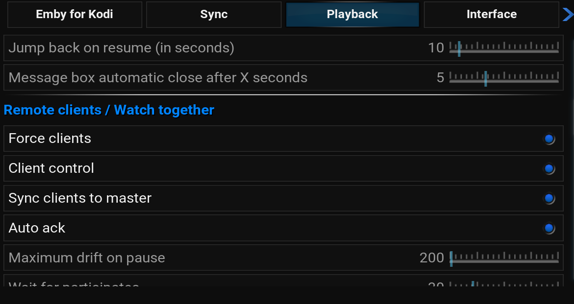

t123thomas 63 Posted November 11, 2023 Posted November 11, 2023 13 hours ago, quickmic said: Did you try 8.2.14 (beta) or 8.2.15 (public testing)? I fixed an issue related to the watch together feature: I tried both only find kodi client not emby
quickmic 1709 Posted November 11, 2023 Author Posted November 11, 2023 33 minutes ago, t123thomas said: I tried both only find kodi client not emby 9.2.15 -> Just tested with Emby app (Android mobile phone) and also with Emby server's WebUi. Works without any issues on my setup. I need a kodi.log for review, maybe I find something.
t123thomas 63 Posted November 11, 2023 Posted November 11, 2023 (edited) 45 minutes ago, quickmic said: 9.2.15 -> Just tested with Emby app (Android mobile phone) and also with Emby server's WebUi. Works without any issues on my setup. I need a kodi.log for review, maybe I find something. pls could U share your settings (screen shot), may be that is where I get things wrong This is my settings where have I got wrong? Edited November 11, 2023 by t123thomas
quickmic 1709 Posted November 11, 2023 Author Posted November 11, 2023 6 minutes ago, t123thomas said: pls could U share your settings (screen shot), may be that is where I get things wrong This is my settings where have I got wrong? I used default settings. Auto ack is off.
