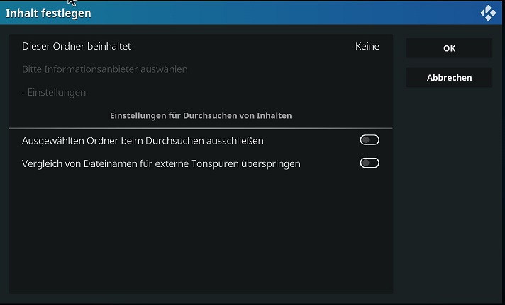

Andy2k 77 Posted July 23, 2023 Posted July 23, 2023 Not sure if this is a dynamic node;) Just a added media source (-folder) showing under the video section of kodi without content type: <source> <name>TMP Ordner</name> <path pathversion="1">nfs://192.168.0.40/volume1/video/TMP Ordner/</path> <allowsharing>true</allowsharing> </source> Im almost sure updating watched status for library files worked in the past after playing a file from such a media source, but i cant say if it was with an older 8.x.x or a 7.x.x version of E4Kng.
Andy2k 77 Posted July 23, 2023 Posted July 23, 2023 (edited) btw, i saw in the kodi log, e4k try to update the progress status for these files, but fails as expected cause the file is not in the library. i guess ek4 lockup after this. Maybe there is a way to exclude these souces from E4K processing.... Edited July 23, 2023 by Andy2k
quickmic 1709 Posted July 23, 2023 Author Posted July 23, 2023 (edited) 1 hour ago, Andy2k said: Not sure if this is a dynamic node;) Just a added media source (-folder) showing under the video section of kodi without content type: <source> <name>TMP Ordner</name> <path pathversion="1">nfs://192.168.0.40/volume1/video/TMP Ordner/</path> <allowsharing>true</allowsharing> </source> Im almost sure updating watched status for library files worked in the past after playing a file from such a media source, but i cant say if it was with an older 8.x.x or a 7.x.x version of E4Kng. Not sure what you expect from external files. This is native Kodi content. Not synced content and not dynamic (nodes) content. Standalone Kodi stuff. E4K should not process this files. If it does, it's an issue but sounds you want to sync progress to Emby server? Edited July 23, 2023 by quickmic
