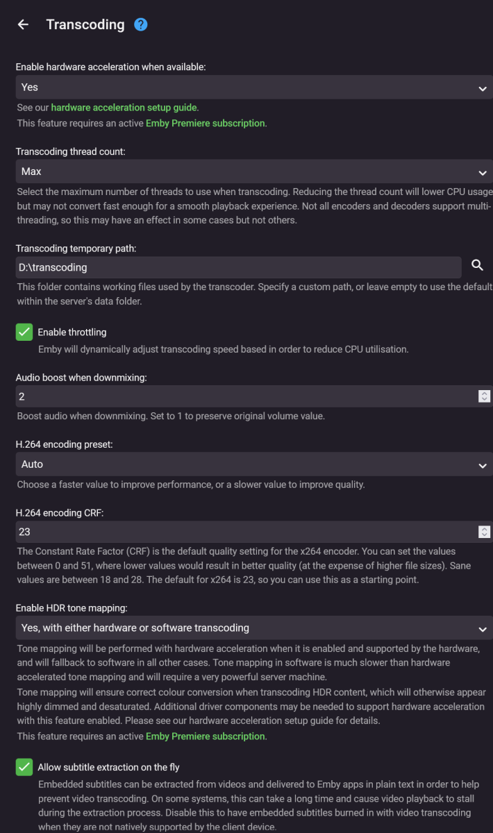

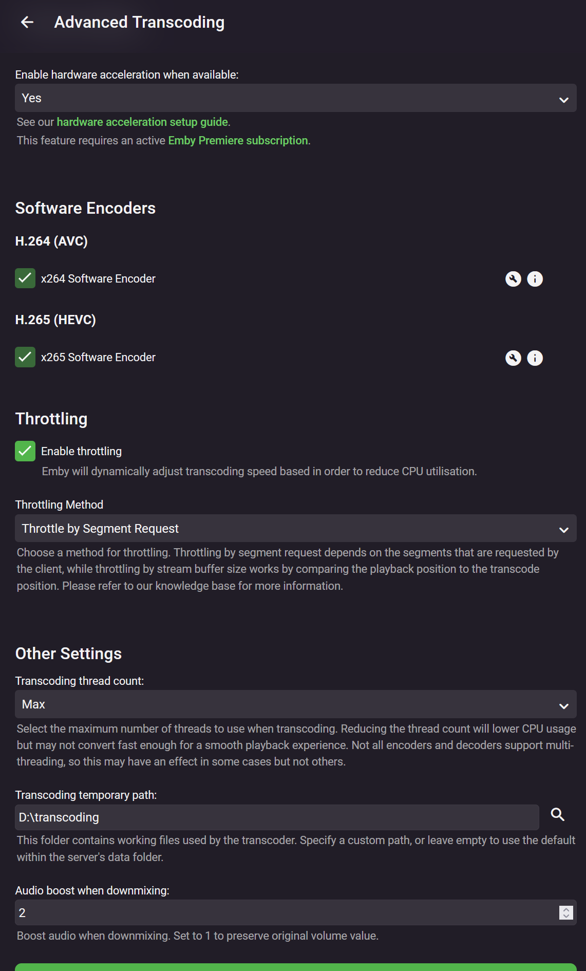

ebr 16354 Posted May 30, 2023 Posted May 30, 2023 17 hours ago, FrostByte said: Your SFN though isn't reporting HDR playback capability. Shouldn't it say under Playback Info "HDR support: HDR10" if it did? Yeah, that's what I was looking for. Not sure why it isn't transcoding. You don't have any transcode options disabled, right?
Spaceboy 2573 Posted May 30, 2023 Author Posted May 30, 2023 27 minutes ago, ebr said: Yeah, that's what I was looking for. Not sure why it isn't transcoding. You don't have any transcode options disabled, right? i don't think so:
ebr 16354 Posted May 30, 2023 Posted May 30, 2023 Yeah, looking at the TV logic, I don't think we ever put the transcode logic in for video range. So that explains at least that much of it. 1
