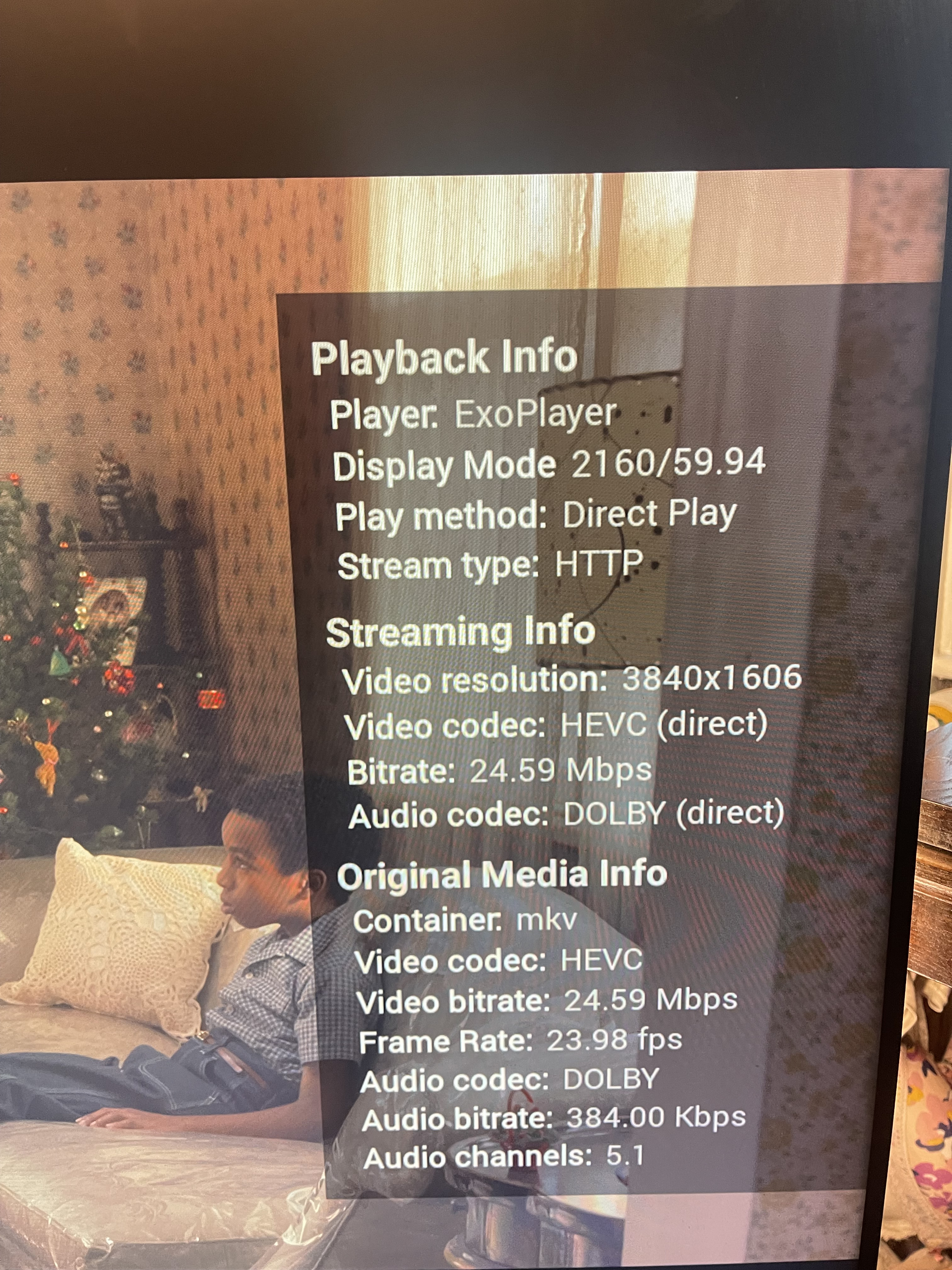

ebr 16354 Posted May 29, 2023 Posted May 29, 2023 It looks like the device is reporting support. if you bring up stats for nerds what does the display support say?
Spaceboy 2573 Posted May 29, 2023 Author Posted May 29, 2023 3 hours ago, ebr said: It looks like the device is reporting support. if you bring up stats for nerds what does the display support say? I wish… it’s a Samsung UE48HU7500, no hdr. There is an avr and a Philips hue sync box between the shield and the tv stats for nerds

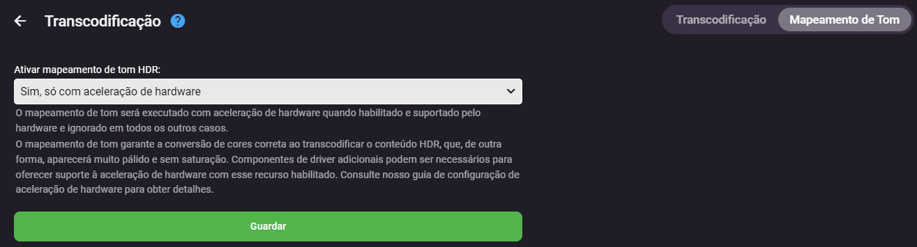

Malamen 1 Posted May 29, 2023 Posted May 29, 2023 (edited) This is my solution for that: It's in Portuguese, but I think you can get there yourself. This is in the server options, obviously. It works 100% for me. I hope it helps you. Edited May 29, 2023 by Malamen
Spaceboy 2573 Posted May 29, 2023 Author Posted May 29, 2023 well i have it set to "yes with either software or hardware" or word to that effect, so not sure its that. i'm going to go out on a limb and say its the syncbox that is reporting hdr compatibility not the tv
FrostByte 5464 Posted May 29, 2023 Posted May 29, 2023 (edited) 51 minutes ago, Spaceboy said: i'm going to go out on a limb and say its the syncbox that is reporting hdr compatibility not the tv Your SFN though isn't reporting HDR playback capability. Shouldn't it say under Playback Info "HDR support: HDR10" if it did? Edited May 29, 2023 by FrostByte
Spaceboy 2573 Posted May 29, 2023 Author Posted May 29, 2023 35 minutes ago, FrostByte said: Your SFN though isn't reporting HDR playback capability. Shouldn't it say under Playback Info "HDR support: HDR10" if it did? would you expect it to if the tv doesnt have hdr support? something is telling the shield it supports hdr and i doubt its the tv
FrostByte 5464 Posted May 29, 2023 Posted May 29, 2023 (edited) 12 minutes ago, Spaceboy said: would you expect it to if the tv doesnt have hdr support? something is telling the shield it supports hdr and i doubt its the tv No, I wouldn't. Ebr though mentioned that something is reporting your device supports HDR. If something is reporting your device supports HDR, then why doesn't SFN reflect that also. Almost like SFN is reporting the end device and the logs are reporting anything in the chain. Edited May 29, 2023 by FrostByte
FrostByte 5464 Posted May 29, 2023 Posted May 29, 2023 SFN should reflect the whole chain (which maybe it does) and the decision to TM should be based on that and not what the log says based on any one device. If that makes sense.
FrostByte 5464 Posted May 29, 2023 Posted May 29, 2023 (edited) Of course, if you have a HD Fury like myself then you wouldn't want the decisions based on the whole chain, but the next device. The HD Fury tells the Shield that my TV supports DV when it doesn't and is reflected in my Shield settings. Shield -> HD Fury -> Video Out -> Samsung TV Audio Out -> Samsung Soundbar - > Samsung TV Edited May 29, 2023 by FrostByte
