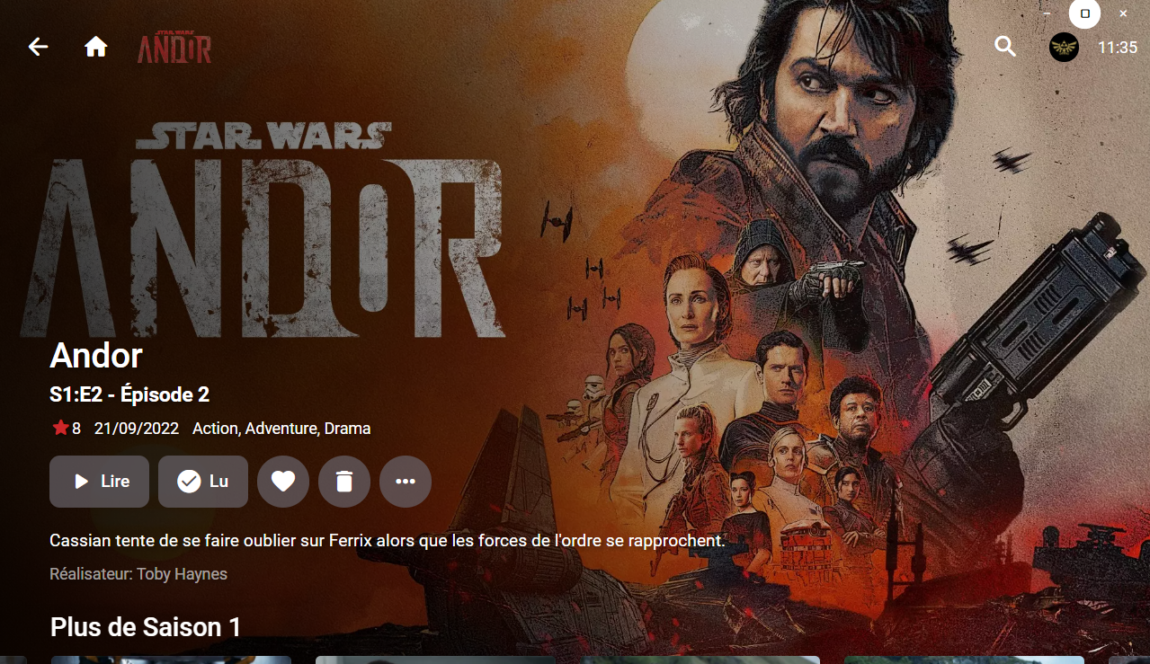

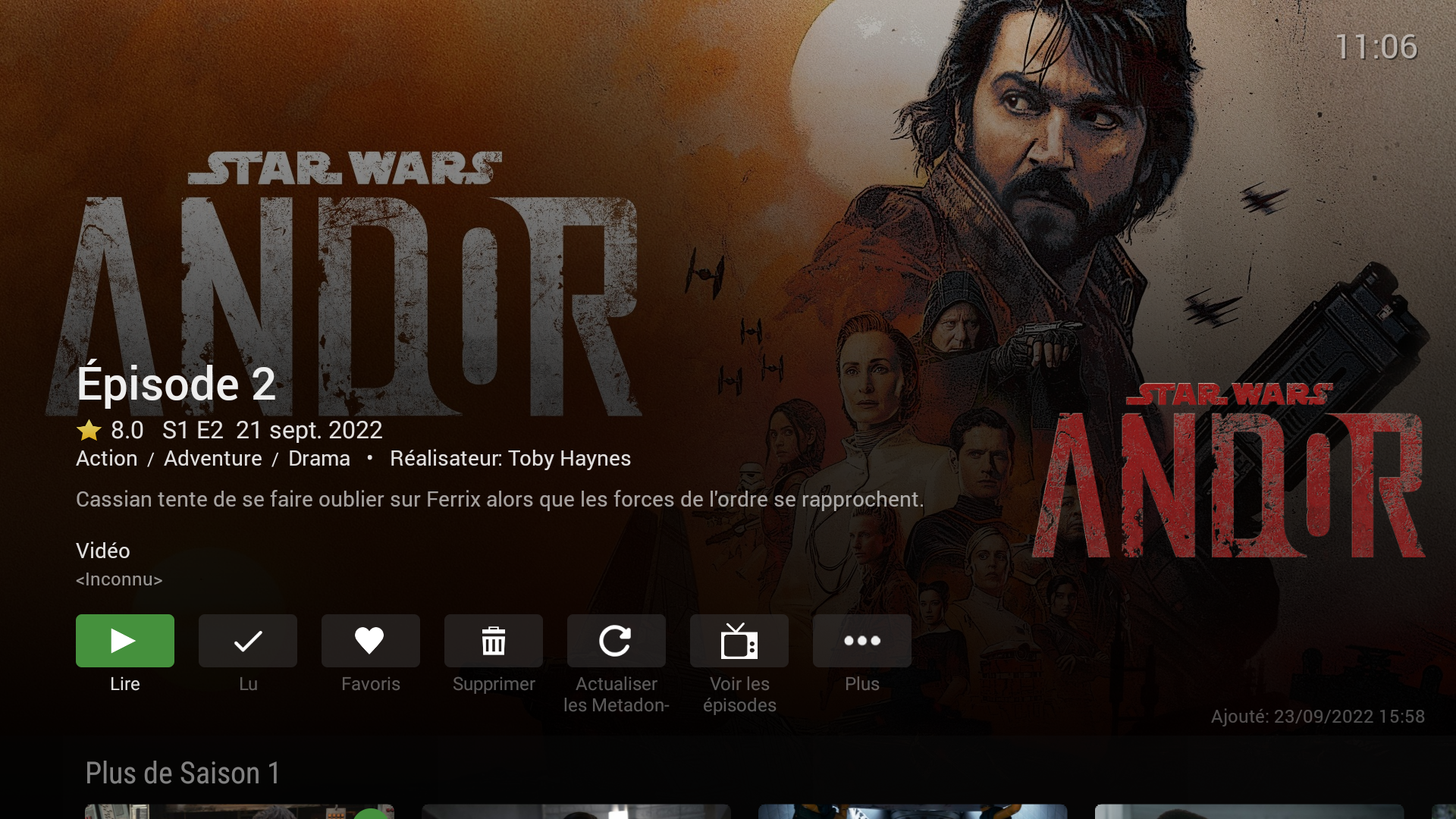

Mjude 1 Posted February 4, 2023 Posted February 4, 2023 (edited) Hi, Since end of November, my Emby server suddenly became unable to decode any new movie or show that I add. Before that everything worked like a charm. When I add a new file, Emby correctly identify it, but when I try to play it, I get infinite loading on my Android TV. As you can see in the attached screenshots, the only thing noticeable is the lack of the line "Video: 4K HEVC blablabla", same line where I can change audio language or subtitle. What is "funny" however is that even with these problems, I still can play files through Emby on my Android phone, but only in default language and without any subtitle because Emby Server doesn't see them. As you can see in the 2nd screenshot (the one took through Emby for Android TV), the line "video" is saying in french "Video: <Unknown>" instead of "Video: 4K HEVC etc etc" I tried creating another path on my hdd for emby files, but the problem remains. I tried updating Emby Server (was beta user), no luck. I even tried to completely uninstall Emby Server then install latest stable version, so I started a fresh install, but no luck either. Even worst: now all my files are "newly added files", so I can't play any of them. I know my files aren't corrupted since I can play them directry in my server through files explorer and VLC. My Emby Server is a Chromecast with Google TV with USB hub and a 5TB HDD If anyone has an idea how I can solve that I would be very grateful. I can provide any log or file if needed, just ask and I will provide. Thanks for your help. Edited February 4, 2023 by Mjude Add line about 2nd screenshot
