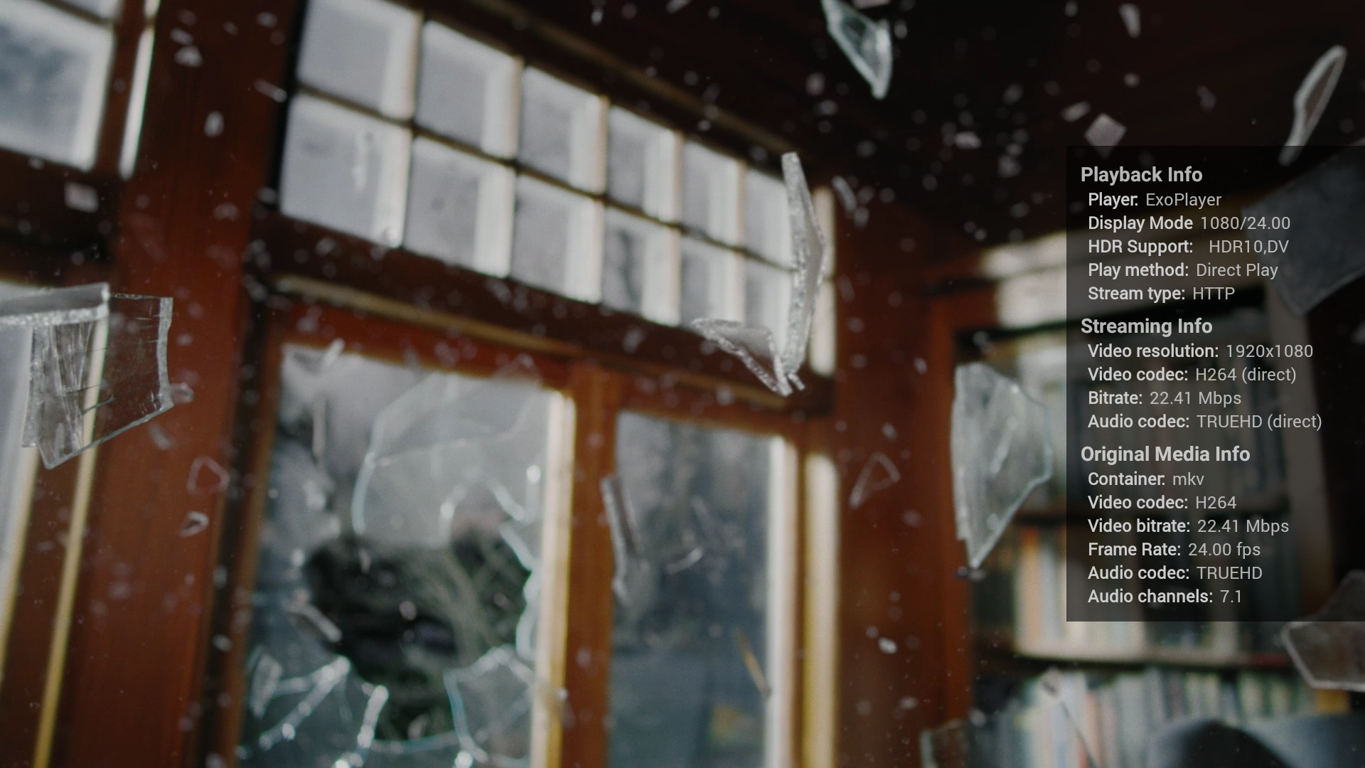

BalthazarBux 19 Posted February 7, 2023 Author Posted February 7, 2023 (edited) Hi I have the Shield connected directly to the Soundbar. But I think the Shield is supporting Atmos via m2ts, therefore the thread start. But Emby doesnt even play the m2ts-file without allowing container changing. On 2/5/2023 at 10:17 PM, Luke said: @BalthazarBux can you provide a sample video for testing? Thanks. The m2ts I attached have three audio tracks. One that says I'm not playing the dolby atmos track, and then one trueHD and one EAC3. I'm going to try to be detailed now about the different ways I try to play it and the outcome. 1. With Emby app on Shield and server not allowing transcoding or container change. NOT PLAYING AT ALL 2. With Emby app on Shield, server allowing transcoding of audio, not container change. VIDEO, NO AUDIO with the trueHD track (Direct playing), stuttering frame by frame video or "too many errors" with EAC3, both VIDEO and AUDIO with AC3-track, (Direct playing both audio and video) 3. With Emby app on Shield, server allowing transcoding of audio and container change. VIDEO, TRUEHD AUDIO working , all other audio tracks also working. (Direct play both audio and video on every track) but NO ATMOS 4 With built in TV dlna function. VIDEO AND ATMOS AUDIO triggered only EAC3-track. TrueHD not supported, doesnt show up. 5. When I container change myself to mkv with MKVtoolnix, it plays TrueHD track and trigger ATMOS with Emby App, no transcoding or container change allowed on server. dolby-shattered-lossless-(www.demolandia.net).m2ts Edited February 7, 2023 by BalthazarBux tested mkv too

BalthazarBux 19 Posted February 7, 2023 Author Posted February 7, 2023 Oh you get Atmos triggered? Hmm, I don't, only TrueHD...except when mkv and it is weird I have to enable transcoding of audio and container change in Emby server to make it play at all when it isnt using any of it since it direct plays anyway. Of course the end result is the same, but I'm curious why...
