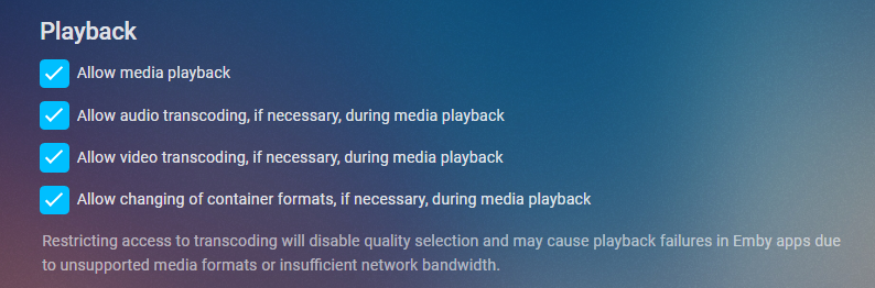

Happy2Play 9800 Posted February 2, 2023 Posted February 2, 2023 Only with hardware support. "hevc" | Can I use... Support tables for HTML5, CSS3, etc You can test disabling user playback setting but if transcoding is required it will fail to play. 1 minute ago, GoldenSpider said: Here should be the logs for the TV app if it is the same Issue I am confused how the native app for the 4K smartTV is not able to encode 4K content ffmpeg-transcode-37177a7b-ece2-40af-8908-f5797c73f2aa_1.txt 50.11 kB · 0 downloads ffmpeg-transcode-8db9e30a-00b6-4356-a06c-8d28a27e7291_1.txt 1.97 MB · 0 downloads Primary issue here should be graphical subtitles. But hard to say on the additional Directplay error. TranscodeReasons=SubtitleCodecNotSupported,DirectPlayError

GoldenSpider 12 Posted February 2, 2023 Author Posted February 2, 2023 22 minutes ago, Happy2Play said: Only with hardware support. "hevc" | Can I use... Support tables for HTML5, CSS3, etc You can test disabling user playback setting but if transcoding is required it will fail to play. Primary issue here should be graphical subtitles. But hard to say on the additional Directplay error. TranscodeReasons=SubtitleCodecNotSupported,DirectPlayError If i tell Emby to convert the 4K titles do you think that would work at all? I guess I should probably just delete the 4K titles and convert them to 1080p or something then
