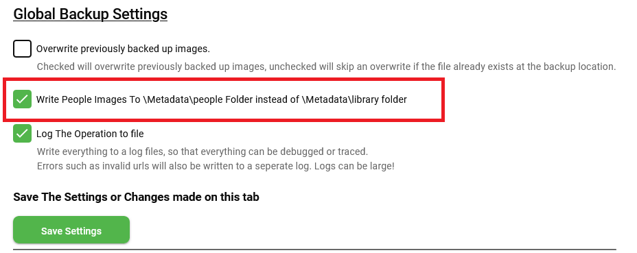

tr0nllam 36 Posted March 23, 2023 Posted March 23, 2023 Is there anyway this plugin could be modified to copy the imported images into the metadata/people folders rather than the metadata/library folder? In the current format, you have to re-import the images if you ever want to move the images to a new database rather than just being able to copy the metadata/people folder over.
mickle026 652 Posted March 24, 2023 Author Posted March 24, 2023 16 hours ago, tr0nllam said: Is there anyway this plugin could be modified to copy the imported images into the metadata/people folders rather than the metadata/library folder? In the current format, you have to re-import the images if you ever want to move the images to a new database rather than just being able to copy the metadata/people folder over. Yes that is entirely possible, I'll add it to my 'todo' list.
mickle026 652 Posted March 24, 2023 Author Posted March 24, 2023 @tr0nllamA new version has been added to the first post with your request implimented. It is untested!!!!! Kodi_actors_Folders_(MetadataPeopleFolder).zip

tr0nllam 36 Posted March 25, 2023 Posted March 25, 2023 (edited) On 3/24/2023 at 3:52 PM, mickle026 said: @tr0nllamA new version has been added to the first post with your request implimented. It is untested!!!!! Kodi_actors_Folders_(MetadataPeopleFolder).zip The new version is copying images to "programdata\metadata\metadata\library\people\Actor Name\folder.jpg" when it should be "programdata\metadata\people\Actor Name-tmdb-xxxxxxx\folder.jpg" For the new method to work, the plugin needs to know the proper providerID to add to the folder. The tmdb id is the default folder id, but it also accepts imdb id if there is no tmdb id available. I don't know how difficult that is to implement. Edited March 25, 2023 by tr0nllam

tr0nllam 36 Posted July 21, 2023 Posted July 21, 2023 23 hours ago, mickle026 said: Updated 20 June 2023 - See First post for description of fixes Did you ever figure out of it's possible to copy the imported files to the default people folder (programdata\metadata\people\Actor Name-tmdb-xxxxxxx\folder.jpg)? I noticed the new version is still using "programdata\metadata\library\people\Actor Name\folder.jpg" rather than adding the tmdbid or imdbid to the folder and putting it where the others are.
mickle026 652 Posted July 21, 2023 Author Posted July 21, 2023 the option is in the config to write to the people folder I coded that way back when .... I couldnt remember off hand if it added the tmdb bit to the folder, but it puts them in the people folder Quote (programdata\metadata\people\Actor Name-tmdb-xxxxxxx\folder.jpg)? it definately put them here programdata\metadata\people\Actor Name\folder.jpg and writes the folder.jpg file if the option is checked Anyway .......... I just checked and it didnt add the tmbd id so I just coded it in to do that if it exists now it'll write like this in priority order of tmdb, imdb, tvmaze programdata\metadata\people\Actor Name-tmdb-xxxxxxx\folder.jpg programdata\metadata\people\Actor Name-imdb-xxxxxxx\folder.jpg programdata\metadata\people\Actor Name-tvmaze-xxxxxxx\folder.jpg and fallback to programdata\metadata\people\Actor Name\folder.jpg if no provider id's are available I also added a fix to invalid http urls errors that the previous fixes highlighted.. I'll re-upload now
tr0nllam 36 Posted July 21, 2023 Posted July 21, 2023 (edited) 14 minutes ago, mickle026 said: the option is in the config to write to the people folder I coded that way back when .... I couldnt remember off hand if it added the tmdb bit to the folder, but it puts them in the people folder it definately put them here programdata\metadata\people\Actor Name\folder.jpg and writes the folder.jpg file if the option is checked Anyway .......... I just checked and it didnt add the tmbd id so I just coded it in to do that if it exists now it'll write like this in priority order of tmdb, imdb, tvmaze programdata\metadata\people\Actor Name-tmdb-xxxxxxx\folder.jpg programdata\metadata\people\Actor Name-imdb-xxxxxxx\folder.jpg programdata\metadata\people\Actor Name-tvmaze-xxxxxxx\folder.jpg and fallback to programdata\metadata\people\Actor Name\folder.jpg if no provider id's are available I also added a fix to invalid http urls errors that the previous fixes highlighted.. I'll re-upload now I have that option checked and it was still sending them to metadata\library\people\ instead of metadata\people. Maybe it has something to do with what my library path is set at in the Emby options. I'll test it out on the new version. EDIT: It's correctly adding the ids to the folder in the newest version, but it's still putting them in the metadata\library\people folder instead of metadata\people. What do you have your Emby metadata path set at? Mine is listed as "C:\Users\xxx\AppData\Roaming\Emby-Server\programdata\metadata" Edited July 21, 2023 by tr0nllam Updated Information
tr0nllam 36 Posted July 21, 2023 Posted July 21, 2023 I created a new Emby server to test it and this is what I've found: If you choose "Use .actors Images (All Images)" from the plugin options, it imports images to "programdata\metadata\library\people" If you choose "Use .actors Images (Missing Images ONLY)" from the plugin options, it imports images to "programdata\metadata\metadata\library\people" If you choose "Import Actors from .actors - missing only" from Scheduled tasks, it imports images to "programdata\metadata\library\people" So, for me, none of the actor import options send them to the correct directory. Also, I'm not sure if it's related, but I've also noticed that if you're using the default metadata directory, Emby won't write it to system.xml file, so it's impossible to change unless you manually edit it.
mickle026 652 Posted July 21, 2023 Author Posted July 21, 2023 OK, I see the problem with the metadata paths. Thanks for the information @tr0nllam I have made the necessary edits and rebuilt/re-uploaded it. It seems to be working correctly here, let me know if its right for you too.....as I use a custom path of my choice rather than the internal one.
tr0nllam 36 Posted July 21, 2023 Posted July 21, 2023 (edited) 54 minutes ago, mickle026 said: OK, I see the problem with the metadata paths. Thanks for the information @tr0nllam I have made the necessary edits and rebuilt/re-uploaded it. It seems to be working correctly here, let me know if its right for you too.....as I use a custom path of my choice rather than the internal one. The two .actors tasks in the plugin options are now sending to the proper people folder, however, I just realized that they're sending all the people to the same directory rather than using a-z folders like Emby does. So, instead of "programdata\metadata\people\Adam Bellamy-imdb-nm7708400" it should be "programdata\metadata\people\a\Adam Bellamy-imdb-nm7708400." Also, The Scheduled Tasks missing actors task is still sending to the "programdata\metadata\library\metadata\people" path rather than the newer one. Edited July 21, 2023 by tr0nllam
GrimReaper 4828 Posted July 21, 2023 Posted July 21, 2023 (edited) 1 hour ago, tr0nllam said: I just realized that they're sending all the people to the same directory rather than using a-z folders like Emby does. So, instead of "programdata\metadata\people\Adam Bellamy-imdb-nm7708400" it should be "programdata\metadata\people\a\Adam Bellamy-imdb-nm7708400." That depends on the installation, Emby also does alphabet folderless. Edited July 21, 2023 by GrimReaper
