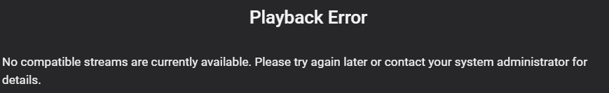

Ewillian9 1 Posted May 10, 2023 Posted May 10, 2023 (edited) 1 hour ago, Luke said: HI, most likely it is capable, but not for the specific file that you played. Can you please show an example? How to Report a Problem Thanks. I did some testing to be sure, all tests I set quality to 420 kbps to be sure no direct play from client. Looking at the logs I was thinking uhd 630 is not supporting av1 10 bits decode because it said : >>>>>> FindVideoDecoder - MediaType: av1, UseHardwareCodecs: True, HWA-Mode: Advanced Info Checking: 'QuickSync Intel HD Graphics 630 - AV1' NoMatch The color format (yuv420p10, p010) is not supported) Info Decoder does not match Info Checking: 'Automatic software decoder' Info Check successful - selecting 'Automatic software decoder' Then I tried av1 8 bits and it selected the uhd 630 : >>>>>> FindVideoDecoder - MediaType: av1, UseHardwareCodecs: True, HWA-Mode: Advanced Info Checking: 'QuickSync Intel HD Graphics 630 - AV1' Info Check successful - selecting 'QuickSync Intel HD Graphics 630 - AV1' But then it just loaded for maybe 20s and throw this error To be sure it was not a random bug I unselected udh 630 from av1 decoder : The media in av1 8 bits plays without error and decode through software of course. Looking at this DOC from intel, UHD 630 7/8/9 gen are not able to decode any av1. ffmpeg-transcode-decode-av1-10bits.txt ffmpeg-transcode-decode-av1-8bits.txt Edited May 10, 2023 by Ewillian9
