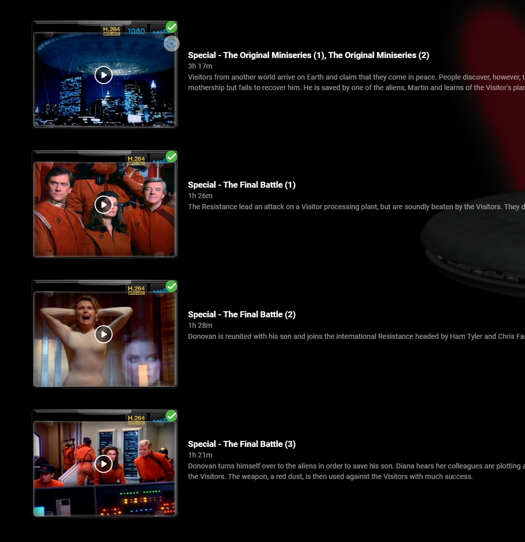

DarWun 357 Posted February 3, 2023 Posted February 3, 2023 (edited) @MasterGreyI added the original V (two mini-series and one season of episodic content) to my library by including the mini-series as specials in the series folder V (1983). All content was scraped properly from TVdb with this setup, both min-series as specials in a "Specials/Season 0" folder and the 19 Season 1 episodes in a "Season 1" folder. The original mini-series was S00E01-E02. The Final Battle was S00E03, S00-04 and S00E05. Edited February 3, 2023 by DarWun

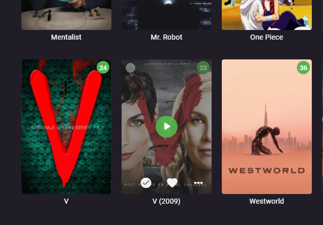

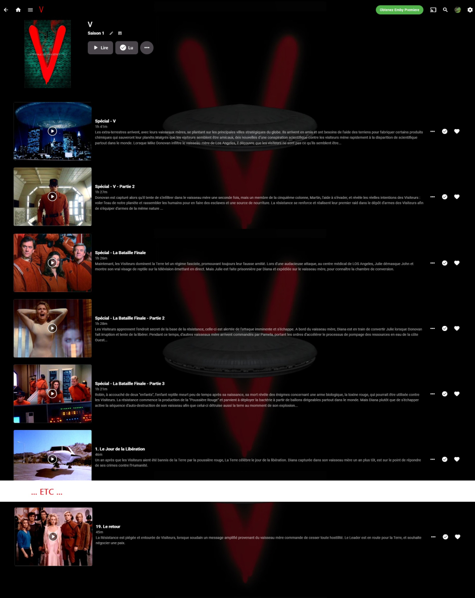

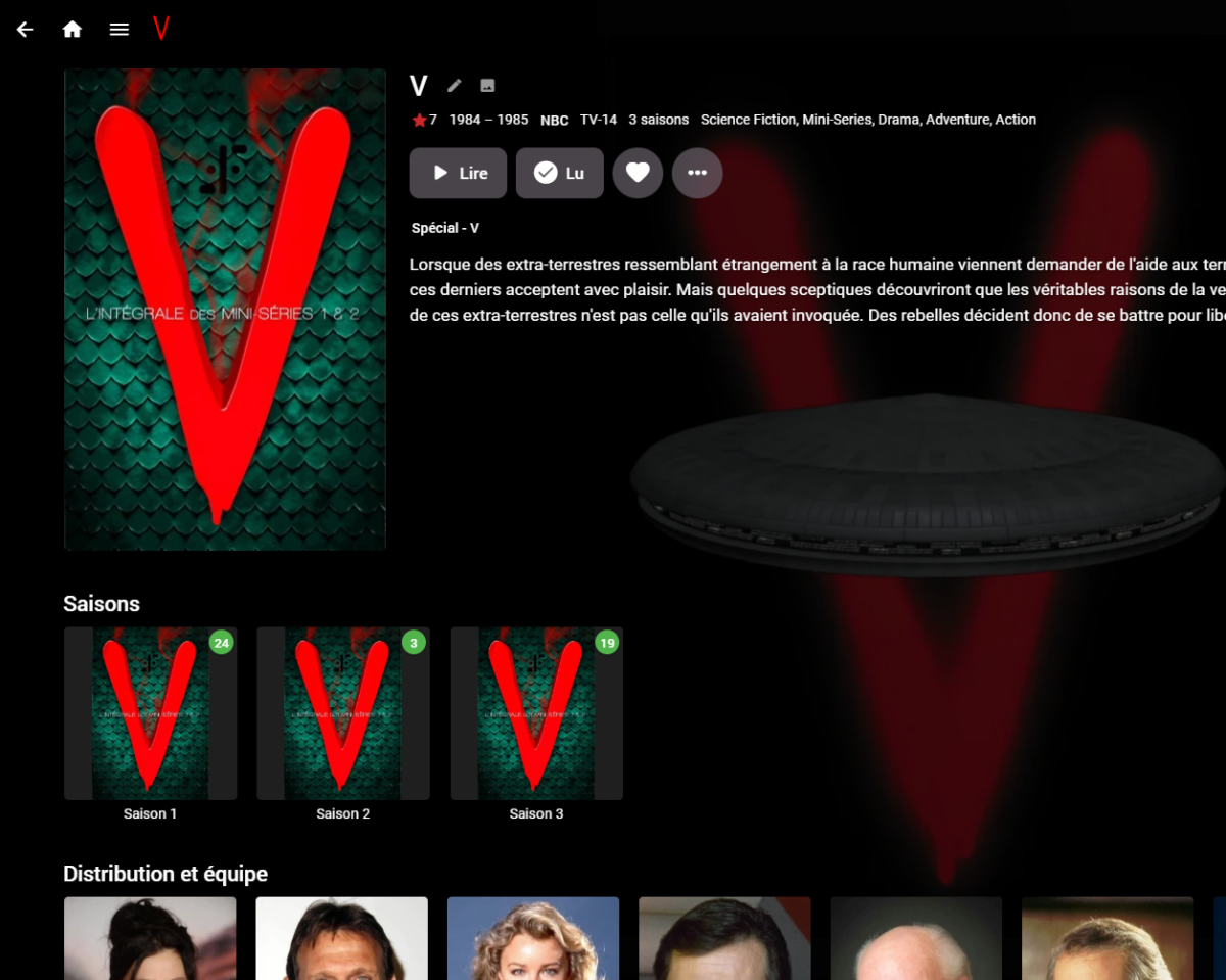

Arraxas 0 Posted January 12, 2024 Posted January 12, 2024 (edited) Hello, I would share with community my config for this serial : - V - La Série (1984) / Saison 1 / S00E01 - Part 1 (1983) - V - La Série (1984) / Saison 1 / S00E02 - Part 2 (1983) - V - La Série (1984) / Saison 2 / S00E03 - Part One (1984) - V - La Série (1984) / Saison 2 / S00E04 - Part Two (1984) - V - La Série (1984) / Saison 2 / S00E05 - Part Three (1984) - V - La Série (1984) / Saison 3 / S01E01 - V - La Série (1984) / Saison 3 / S01E02 - V - La Série (1984) / Saison 3 / S01E03 - V - La Série (1984) / Saison 3 / ..... - V - La Série (1984) / Saison 3 / S01E19 (from memory) I had apply a right click on base folder of the serial / Identifier -> fill ID theTVDB : 76354 -> search and select the only one result found. It allow me to have this render in emby (see attachs) My last problem now is to access to database to remove duplicate links. I think remove all excessive episode in "Saison 1" to keep an organisation as 3 seasons. Someone can help me to edit the database ? (if I use the "delete option", it will remove duplicate link but also files in file system) Thanks all. EDIT : My emby server is installed on an asustor Edited January 12, 2024 by Arraxas
pwhodges 2039 Posted January 12, 2024 Posted January 12, 2024 You can specify the TVDB id in the folder name by adding "[tvdbid=76354]". And of course Emby's confused - you've got file names specifying a different season from the enclosing folders, and season folders that don't exist in TVDB. In particular, if you put an episode with "s00e" into a season folder, it will typically also be shown in a Specials folder. I can see what you're trying to do, but in practice this will be extremely unstable in Emby, and any apparent solution is liable to break again as Emby develops - it's happened to me when I tried to override the system design... Paul
