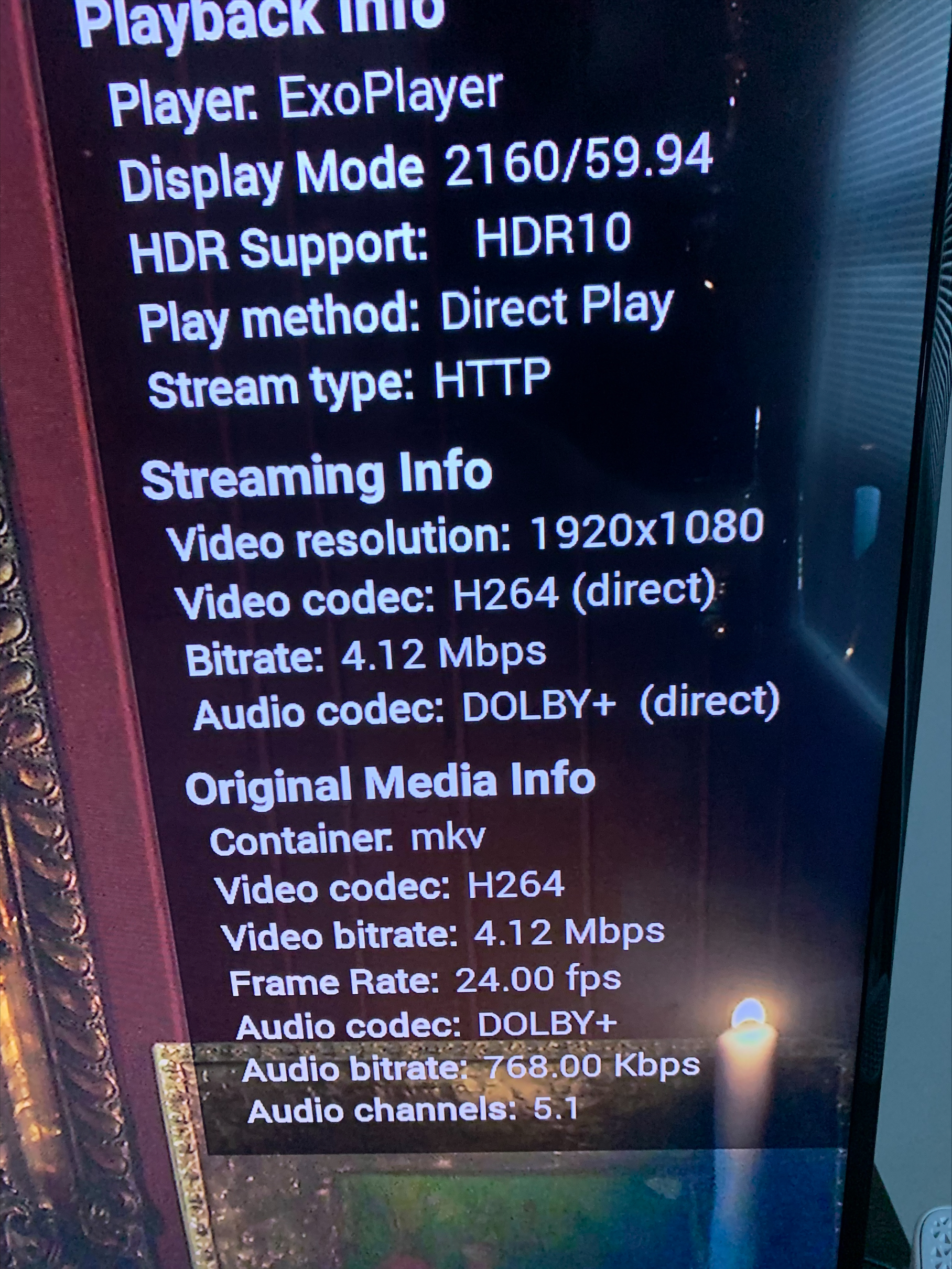

lstryhrn 8 Posted January 25, 2023 Author Posted January 25, 2023 1 hour ago, ebr said: That is telling the TV to convert everything to DD, I believe. Is there an "Auto" setting? I think it switches back and forth. If DD or DD+ is not playing it goes back to the PCM. Please look at the attached pictures. This is why Im confused. If the video is 1080p it direct play the audio. When I play 4K it software decodes the audio as you can see. My tv supports DD and DD+

lstryhrn 8 Posted January 25, 2023 Author Posted January 25, 2023 (edited) Playing a 4K remux movie are my Shield TV. The name of the movie is called Alita: Battle Angel. Software decoding is on even though my TV support DD and DD +. This only happens with 4K DD and DD +. 1080P direct plays the audio for DD DD+ 4K Logs 2:46 PM EST -- this is the log I am reporting about- This software decodes 1080p logs 2:51 PM EST -- This is the log that works with the same audio as the 4K. It direct plays The name of the user is Joshua Edited January 25, 2023 by lstryhrn
ebr 16337 Posted January 25, 2023 Posted January 25, 2023 14 minutes ago, lstryhrn said: 4K Logs 2:46 PM EST -- this is the log I am reporting about- This software decodes Hi. The track selected in this log was True HD and, therefore, is being decoded by the app. It doesn't appear to match up with the stats image above but, maybe it is only reporting it as "Dolby" instead of TrueHD for some reason.
lstryhrn 8 Posted January 25, 2023 Author Posted January 25, 2023 45 minutes ago, ebr said: Hi. The track selected in this log was True HD and, therefore, is being decoded by the app. It doesn't appear to match up with the stats image above but, maybe it is only reporting it as "Dolby" instead of TrueHD for some reason. Thats clearly not correct at all unless the audio selection doesnt work in the Emby app. TRUEHD is the default audio for that file but I change it when I played it. I just sent another report at 3:58 EST time. Can you please check that log. I also included a screenshot of the stat
Solution ebr 16337 Posted January 25, 2023 Solution Posted January 25, 2023 Hi. I can see you switching back and forth on the audio tracks in the log. When the True HD one is selected, it is decoding. When the DD+ one is selected, it is bitstreaming it. The stats may just not be updating quickly enough. Can you try sideloading our standard android app on the same device and see how that compares? https://emby.media/emby-for-android.html Thanks.
