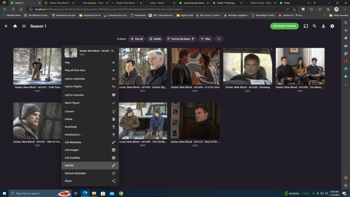

bendyintc 2 Posted January 22, 2023 Posted January 22, 2023 Hello, after finding the tutorial on naming tv shows, I renamed my folder structure TV/Dexter - New Blood/Season 1/Dexter, New Blood - s01e01 - Cold Snap.mp4 and still can't seem to get it to show correctly in Emby. So I went to TVDB and looked up the ID for this particular episode and entered it in the box under the Identify prompt and it comes up that it can't find it. The same is true for doing the same via IMDB. Is the lack of information due to the way I have it named in Emby? The "TV" folder is on the same drive as my movies, does affect it also? I have the folder's properties set to "TV Shows" and have the TVDB listed as the first database. Any help would be appreciated. Thank you in advance. Scott

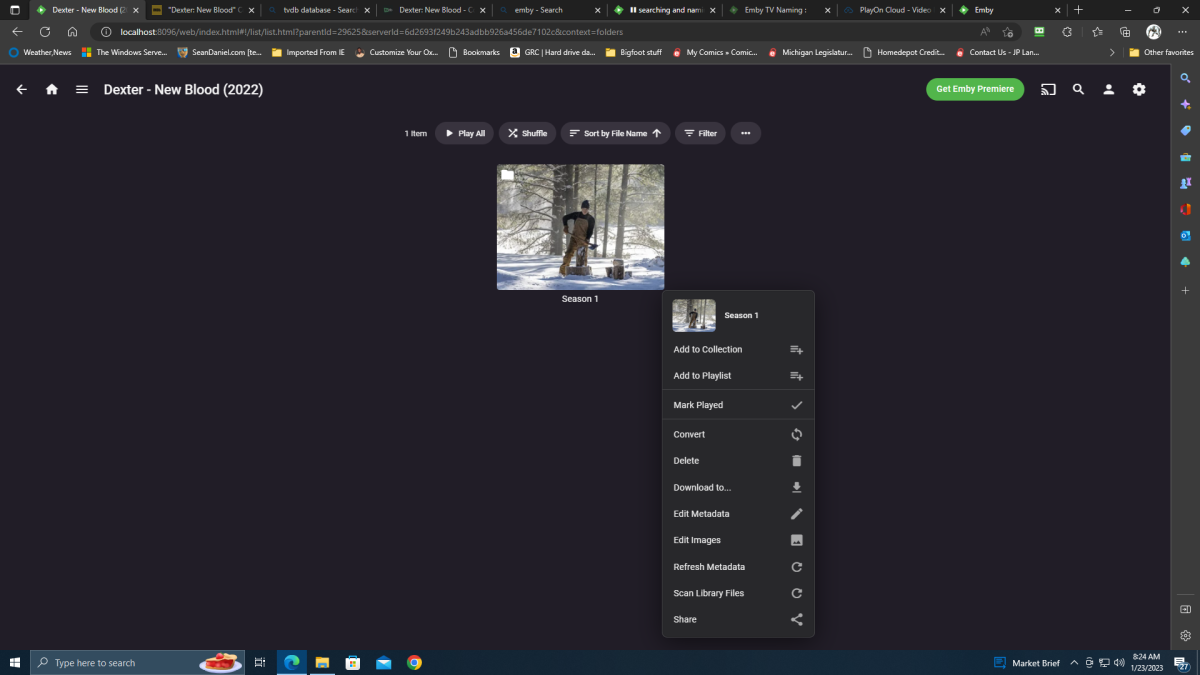

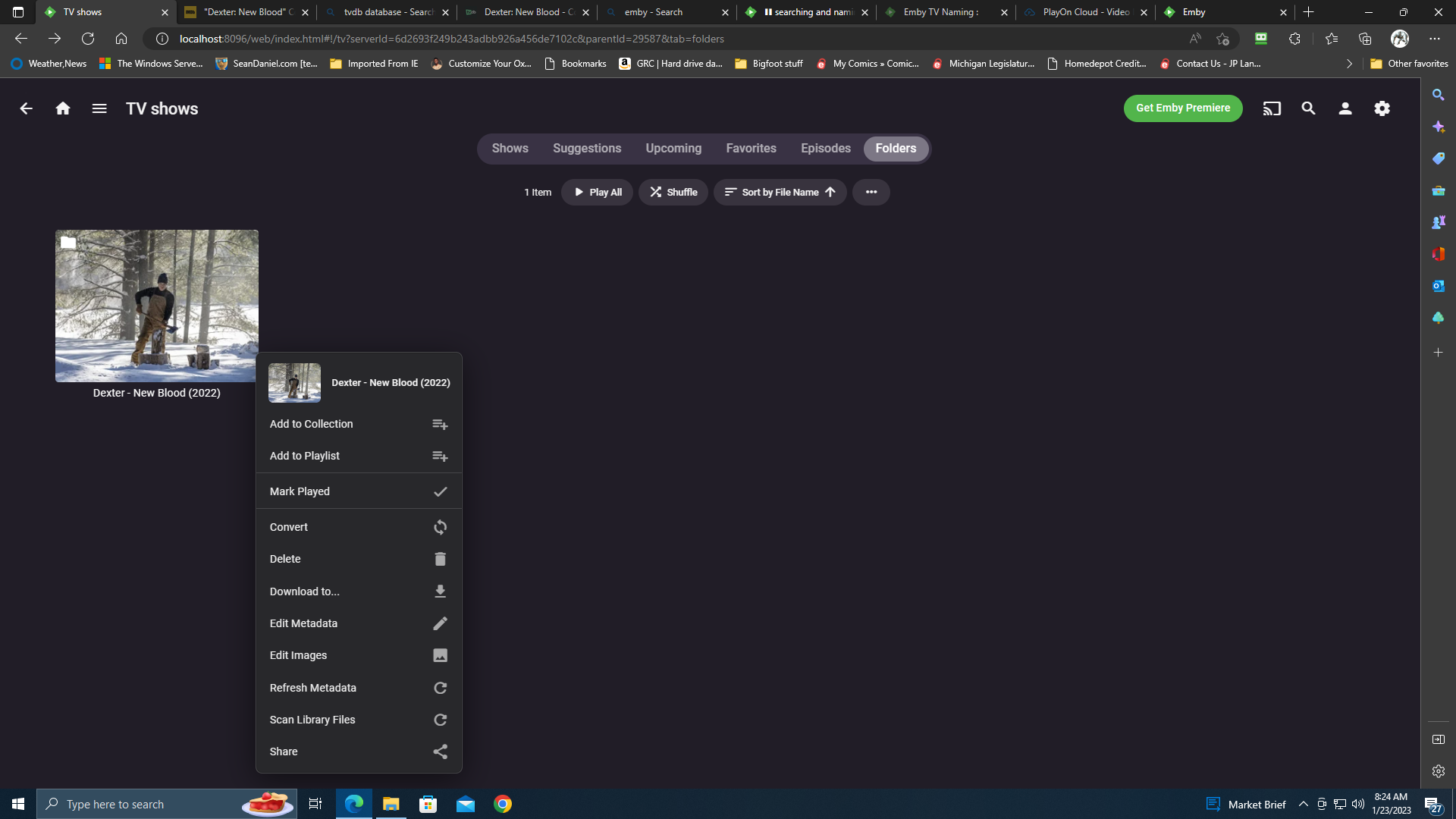

bendyintc 2 Posted January 23, 2023 Author Posted January 23, 2023 I guess I'm missing something ..there isn't any "Identify" option at either the folder or the series (season) level. The only place that option comes up is at the episode.

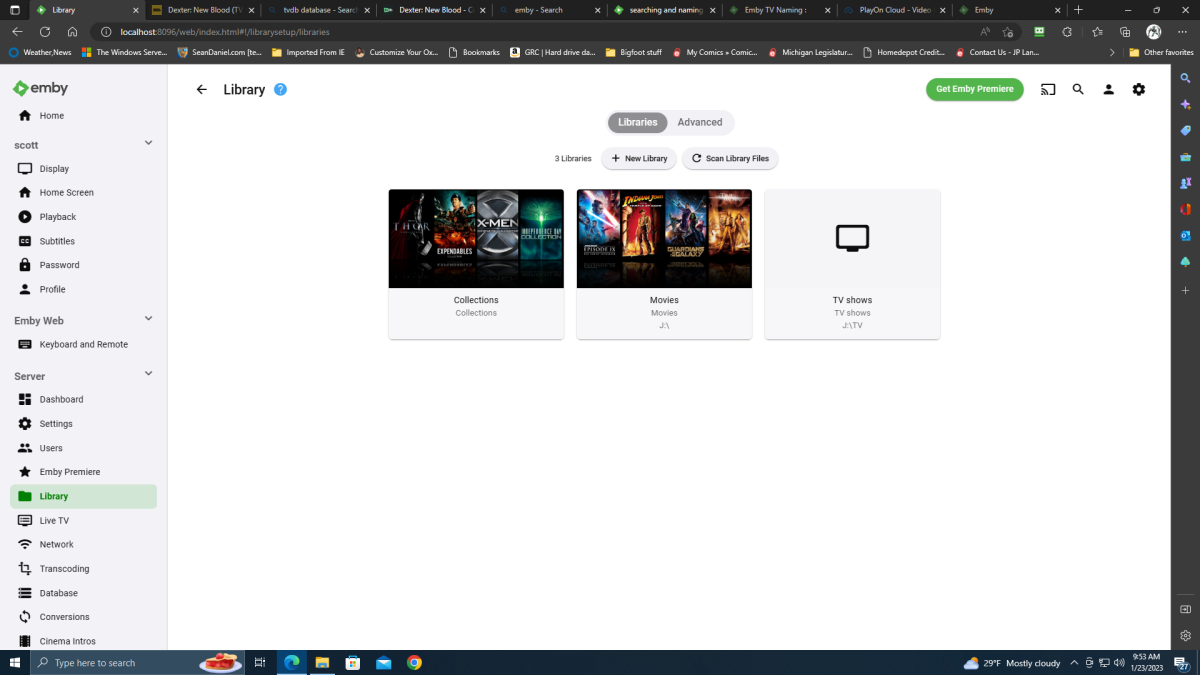

GrimReaper 4851 Posted January 23, 2023 Posted January 23, 2023 How many libraries and with which paths have you created? 2023-01-23 07:45:06.752 Info App: Found duplicate path: J:\TV 2023-01-23 07:45:06.838 Info App: Found duplicate path: J:\TV 2023-01-23 07:45:16.478 Info App: Found duplicate path: J:\TV
GrimReaper 4851 Posted January 23, 2023 Posted January 23, 2023 (edited) 16 minutes ago, bendyintc said: same issue ..do I need to locate the TV folder somewhere other than the same drive I keep my movies on? embyserver (1).txt 26.62 kB · 0 downloads No, as long you're not using same folder paths. What is your movie library folder path? Edited January 23, 2023 by GrimReaper
bendyintc 2 Posted January 23, 2023 Author Posted January 23, 2023 just the one library with the one path ..I've done multiple scans

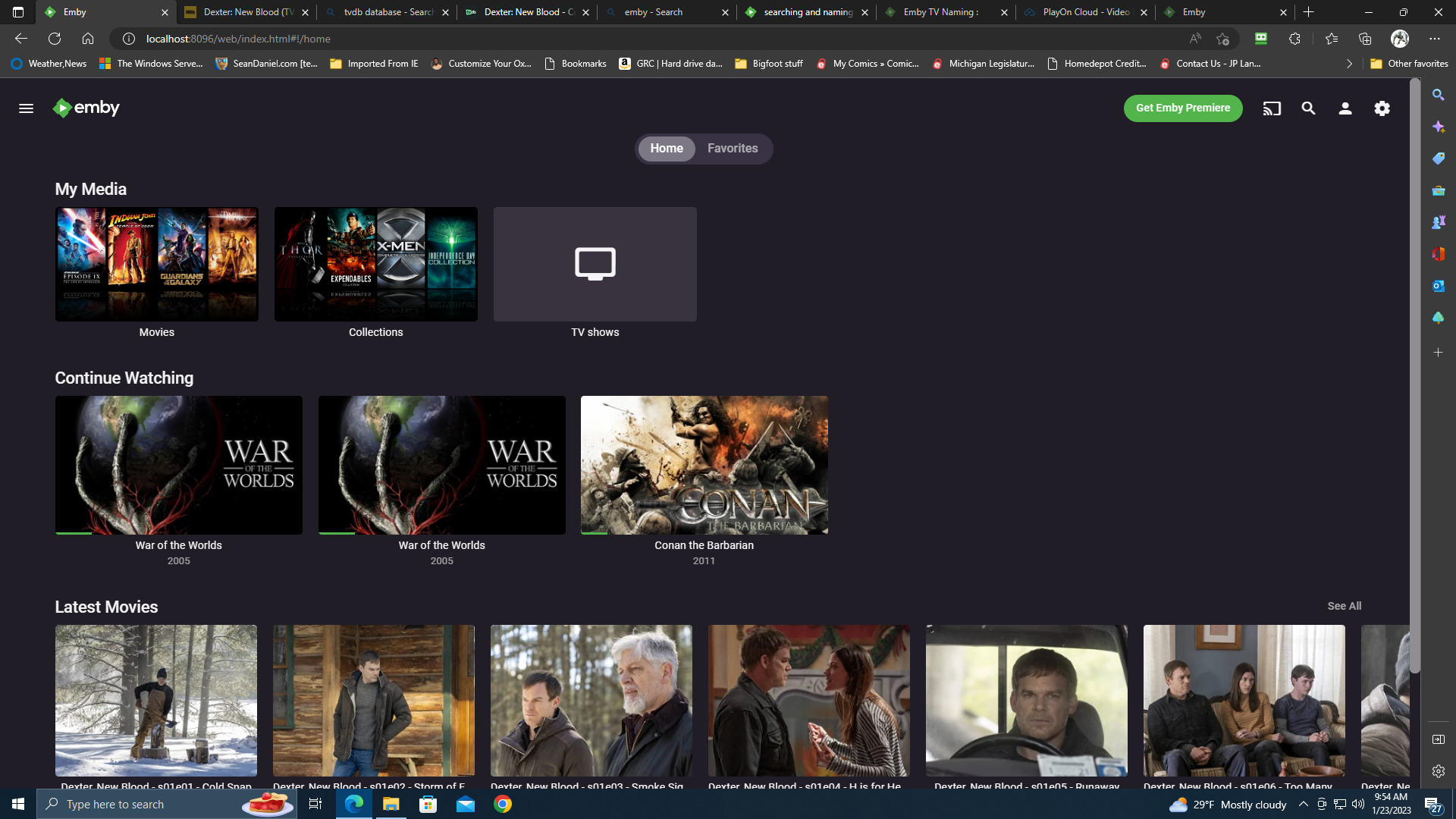

GrimReaper 4851 Posted January 23, 2023 Posted January 23, 2023 Therein lies your issue: your movie library is J:\ - can't have library with folder that is subset of another library. Hence your Dexter items are being queried as movies: 2023-01-23 09:28:38.528 Info HttpClient: GET https://api4.thetvdb.com/v4/search?type=movie&q=Dexter, New Blood - s01e01 - Cold Snap Transfer all your movies to J:\Movies and put that as Movie library path. Leave TV shows library as J:\TV. Rescan and everything will sort itself out. 1 1

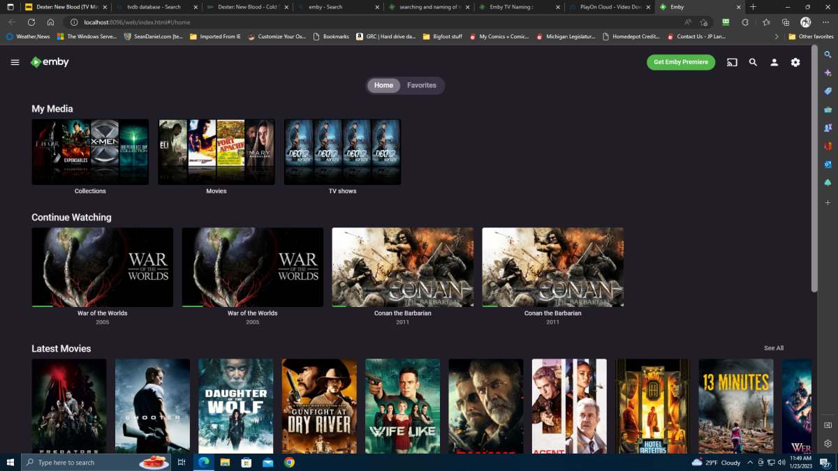

bendyintc 2 Posted January 23, 2023 Author Posted January 23, 2023 one more quick question if you have the time .. how do I get the home page "TV Shows" to show multiple titles like the "Movies" one does?
GrimReaper 4851 Posted January 23, 2023 Posted January 23, 2023 Delete that image (three-dot menu or right-click on Library thumb>Edit images), scan library.

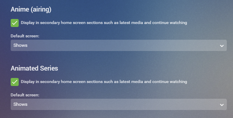

pwhodges 2024 Posted January 23, 2023 Posted January 23, 2023 Check your settings for the home page (in the user/app settings); you can enable or disable each library from showing in the Latest Media: Paul
GrimReaper 4851 Posted January 23, 2023 Posted January 23, 2023 1 minute ago, pwhodges said: Check your settings for the home page (in the user/app settings); you can enable or disable each library from showing in the Latest Media: Paul Guess we understood the query differently. 1
bendyintc 2 Posted January 23, 2023 Author Posted January 23, 2023 Both helped ..once again, thank you very much! ..also refreshing my browser helped! have a great day! Scott 1
