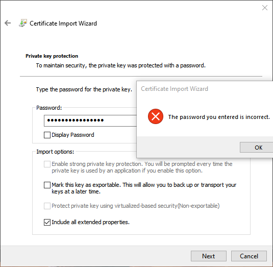

strander14 3 Posted January 22, 2023 Author Posted January 22, 2023 You're right - I just tried installing the certificate and it says the password is incorrect. It is the same password I used in that get_cert.bat. I am wondering how it changed. I guess I will recertify the DNS and get back to you when I figure that out.

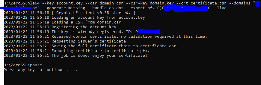

strander14 3 Posted January 22, 2023 Author Posted January 22, 2023 So this is what I followed when creating my cert: @[member="Echo"] off le64 --key account.key --csr domain.csr --csr-key domain.key --crt certificate.csr --domains "yourdomain.net" --generate-missing --handle-as dns --export-pfx “yourpasswordhere” --live pause Replaced the domain with my domain - and the password with a password. When I enter that password it says it is incorrect. Even generating a new certificate with a new password yields the same results. Attached shows that the SSL cert creation was working properly. Also attached is the file that I am trying to access with the password input in "yourpasswordhere".

strander14 3 Posted January 22, 2023 Author Posted January 22, 2023 I tried this and got the same error when trying to import the cert. I am just confused as to why or even how the password is incorrect.

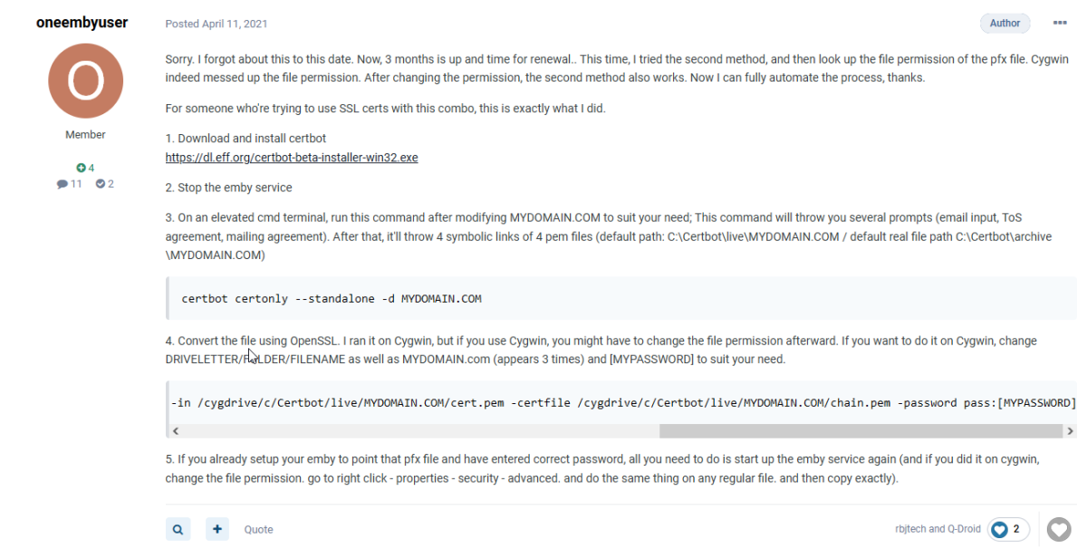

strander14 3 Posted January 22, 2023 Author Posted January 22, 2023 Oh my goodness. I got it!! I was browsing another post on the forum. I posted what I followed below. I did try what you are saying - creating the pfx file myself - but I couldn't figure out how to do it. The .pem is also something that le64 didn't generate or that I didn't find. 8 minutes ago, Q-Droid said: Do you also get the cert file when using le64? If so then you can create the pfx using other tools. In your listing above I don't see a file for the certificate itself - .pem or .cer. Either way - I can use my 8920 port to login as well as my domain!! THANK YOU GUYS FOR THE HELP!!!! 3
seanbuff 1360 Posted January 22, 2023 Posted January 22, 2023 11 minutes ago, strander14 said: I was browsing another post on the forum. I posted what I followed below. Well done, yes I also found that and was going to mark it as a Recommended post over there, I will do that now. Thanks for following up.
