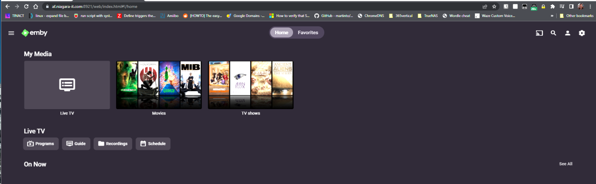

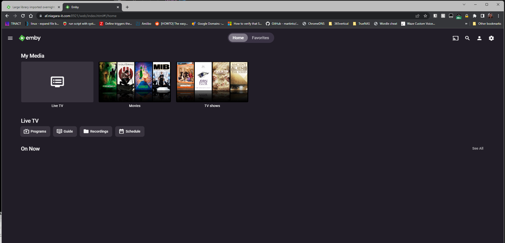

bruor 43 Posted January 20, 2023 Author Posted January 20, 2023 (edited) I've got my first batch of media imported and it's definitely causing a delay when the home screen is loaded. It takes around 4 seconds to switch from this: to this: 3672 movies, 136 series 4933 episodes Removing the TV folder from the library results in a load time of approx 1.5 sec. Thinking I might change my approach and include only the TV subfolders for the shows that I want to be in EMBY, is there a limit to the number of folders that can be added to a library? How does it handle things if a folder gets deleted? OR, if I enable "show missing episodes" can I get the new missing episodes when a series releases new ones to show up in the "continue watching" list so I can be notified that I need to copy the strm files into the library folder? Edited January 20, 2023 by bruor
