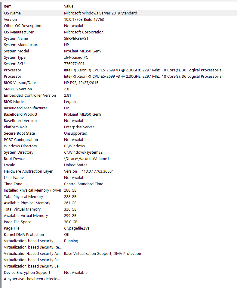

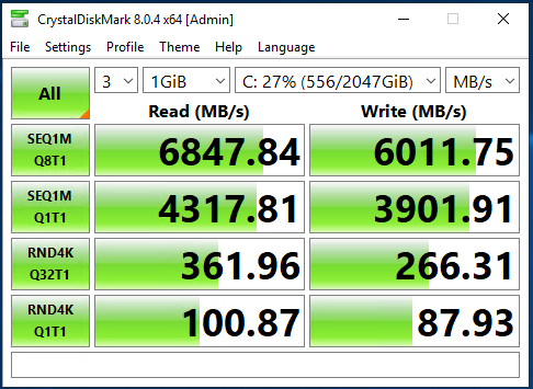

pir8radio 1313 Posted January 20, 2023 Posted January 20, 2023 (edited) I have always ran emby bare metal on a physical server, usually due to me having multiple GPU's for transcoding and other stuff. Looking to virtualize but notice all other VM's just are not as snappy as running on my bare metal server. Giving them like 10 cpu's each... all the ram they need, and VM's are all on a raid... I have not put emby on a vm yet, i fear transcoding will suck... Looking for feedback from other Hyper-V users and how emby is working for you? How much have you stressed it? as in 4k 10bit transcodes, etc.. I get it wont do better than my GPU, and I have not looked into gpu passthrough yet.. i know its possible. Anyway just looking for feedback from actual emby hyper-v users... below is my server info... no SSD's spinning disk raid. Edited January 20, 2023 by pir8radio
jriker1 21 Posted January 22, 2023 Posted January 22, 2023 Yeah I just set it up the other day. Note not 100% sure but believe your cpu came out in 2014. I had something similar with a Dell Precision. Lots of cores but the age even running it on the primary OS wasn't the same. Also your drive test. That 1GiB test could be all cache. If I read right and your drive is all rust based raid drives, that's the speed of an NVME drive. Anyway, I have mine now running water cooled on a Ryzen 7950x with Windows 2022 and the Hyper-V role. I've allowed it to use up to 4 "virtual processors" for Emby and 4GB ram. Works faster than my prior mentioned precision. Since this is a rack mount 2U system I'm also not currently using a secondary GPU don't need it. Using the one that comes with the CPU. Also no passthru just whatever the default GPU is that Hyper-V sets up. Emby shows it's using hardware transcoding but for me it's doing this with WMV 720p and 1080p content. Works great. I do not have any 4k content that for my scenario would require transcoding. Everything I use thru Emby is using a NVidia Shield Pro TV. MP4, MKV, etc will all play direct.
pir8radio 1313 Posted January 24, 2023 Author Posted January 24, 2023 (edited) On 1/21/2023 at 6:47 PM, jriker1 said: Yeah I just set it up the other day. Note not 100% sure but believe your cpu came out in 2014. I had something similar with a Dell Precision. Lots of cores but the age even running it on the primary OS wasn't the same. Also your drive test. That 1GiB test could be all cache. If I read right and your drive is all rust based raid drives, that's the speed of an NVME drive. Anyway, I have mine now running water cooled on a Ryzen 7950x with Windows 2022 and the Hyper-V role. I've allowed it to use up to 4 "virtual processors" for Emby and 4GB ram. Works faster than my prior mentioned precision. Since this is a rack mount 2U system I'm also not currently using a secondary GPU don't need it. Using the one that comes with the CPU. Also no passthru just whatever the default GPU is that Hyper-V sets up. Emby shows it's using hardware transcoding but for me it's doing this with WMV 720p and 1080p content. Works great. I do not have any 4k content that for my scenario would require transcoding. Everything I use thru Emby is using a NVidia Shield Pro TV. MP4, MKV, etc will all play direct. THanks for the feedback.. Yes after digging in my spinning drive speed is in fact cache results.. i have the raid set to 50/50 read write, and i have 8 gigs of cache (should be 4/4gig).. so i just haven't been hitting the point where cache gets overrun. I was going to do the emby db on a ramdisk, but don't think ill need it. Raid has been doing a good job of using the cache. Yes they are older CPU's but i wanted the lots of cores for VM use.. I'm giving 10 virtual cores to each of my VM's, none of them so far use that much cpu time, emby should be the largest. I don't think my vm's showed up with a gpu hardware device, ill have to look... But yest download a 4k 10 bit video file, and try to transcode it to 1080p that is what i need emby to do for me.. my bare metal can handle a few of these concurrent transcodes, but I have found almost no xenon (without built in enc/dec capability) can handle eve one stream. Guess ill find out.. I'm dreading doing a fresh install of emby.. my emby has been on the OG database for many years lol. Edited January 24, 2023 by pir8radio
