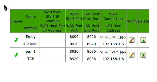

sross44 435 Posted January 20, 2023 Posted January 20, 2023 To set it up for port forwarding, you should just have one rule to test this. Port 8096 (assuming you didn’t change the ports in Emby) pointing to your local ip address that the emby server is on. If you want, take a screen shot of your port forwarding settings and I’d be more than happy to help you if I can.

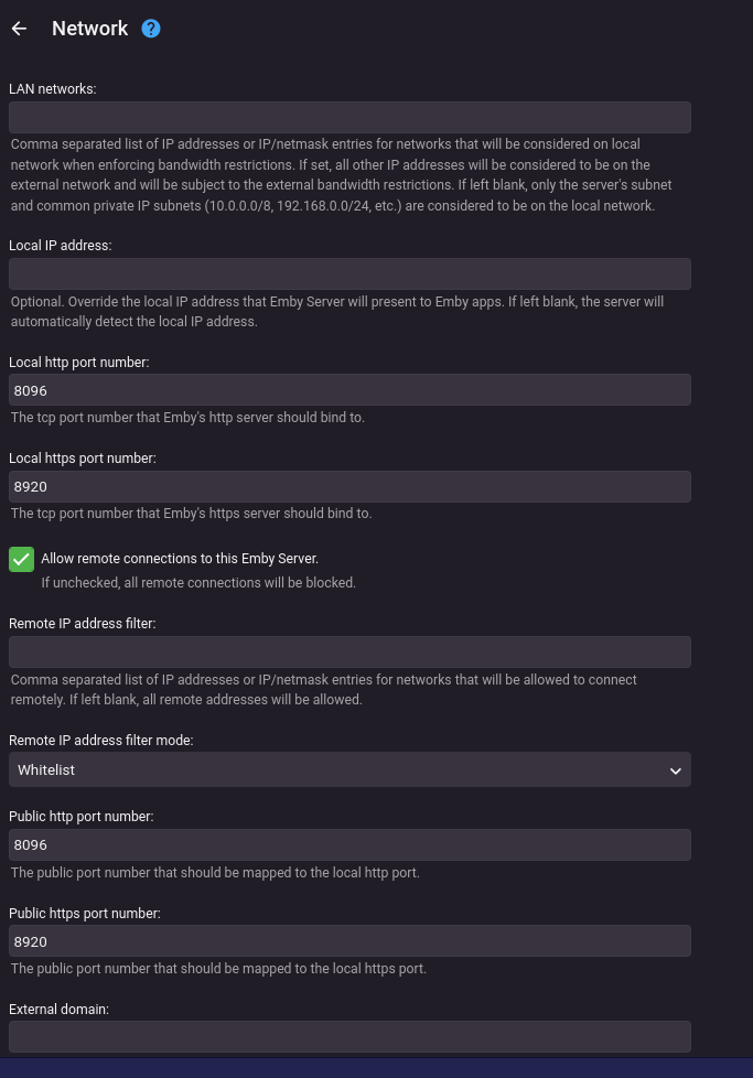

AngstyAardvark 2 Posted January 20, 2023 Author Posted January 20, 2023 (edited) ^ thanks very much ...i am at work at the moment but wil get a screenshot tonight and post it here.... (i am in thailand and it is morning here) i assume you mean my router's port forward settings btw - i have noticed that as long as i sleep the laptop and leave the VPN connected, then it will work when i get to work....if i shut down the laptop, it will not connect either manually or with quick connect. - this could be co-incidence but it is working as i type ithis is what i have in my emby network settings fr the time being Edited January 20, 2023 by AngstyAardvark

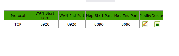

AngstyAardvark 2 Posted February 3, 2023 Author Posted February 3, 2023 On 1/21/2023 at 1:40 AM, visproduction said: Hope that helps. It might well do thnk you. i have always used emby via wifi sorry not to hve thanked you sooner ... i popped back in to vent more frustrations with my remote access..... first i will check how it goes with a wired connection. what i have noticed is that when my WAN changes that is when i (and other users of my account) can't connect remotely ....even with emby quick connect right now - the wan address in my emby dashboard for remote connect is not the same as my actual WAN address (my LAN address is static) does this lot look right? thanks again everyone for the help
rbjtech 5345 Posted February 3, 2023 Posted February 3, 2023 So a different WAN address in emby to your real WAN address indicates an issue (could be cgNAT or VPN issues if used) but I believe your port forwarding rules are wrong - so lets correct them first. You need two port forwards - 1 for http (8096) and (if you use https) 1 for https (8920) So for http WAN Start Port = 8096 WAN End Port = 8096 LAN Host Start Port = 8096 LAN Host End Port = 8096 for https same as above, but use 8920 for all of them -- Use TCP only - emby does not use UDP for WAN connections. 1
