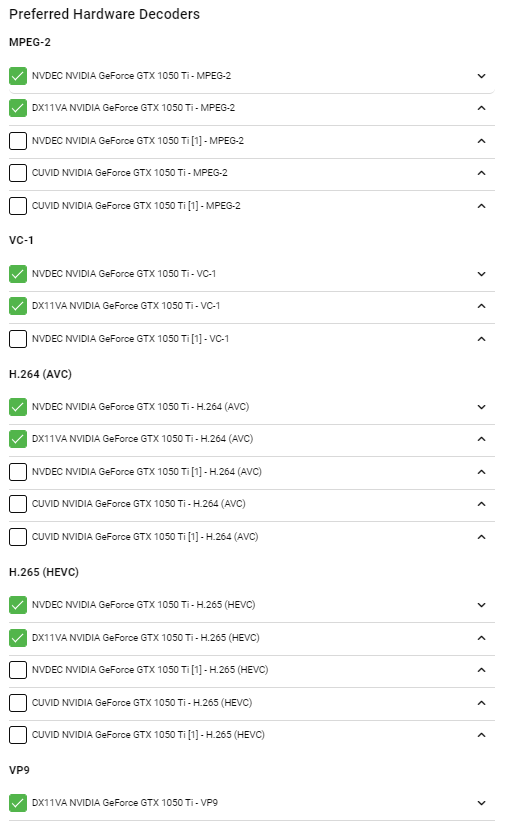

matbeebe85 2 Posted January 21, 2023 Author Posted January 21, 2023 19 minutes ago, Happy2Play said: That is usually how it works when you try to troubleshoot. Seems odd there is no ffmpeg with mkv in Chrome though as it should be at least remuxing. Seems odd you don't have a hardware decoder also. >>>>>> Hardware Encoders for h264 [X] NVENC NVIDIA GeForce GTX 1050 Ti - H.264 (AVC) [X] NVENC NVIDIA GeForce GTX 1050 Ti [1] - H.264 (AVC) >>>>>> Selected Codecs Decoder Automatic software decoder But if it happens again please post the server and ffmpeg log if present. I am using Brave browser currently. It is still chromium based, but is there a difference with remuxing? I turned on advanced settings for hardware decoding. Here is my settings for Decoding:
Happy2Play 9800 Posted January 21, 2023 Posted January 21, 2023 @matbeebe85may have just been the avi mpeg4 file in the previous ffmpeg log. As for remuxing it is just a container swap as most browsers will not support mkv.
