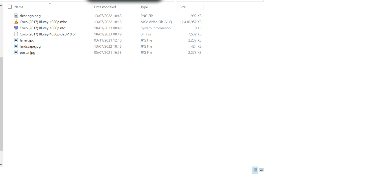

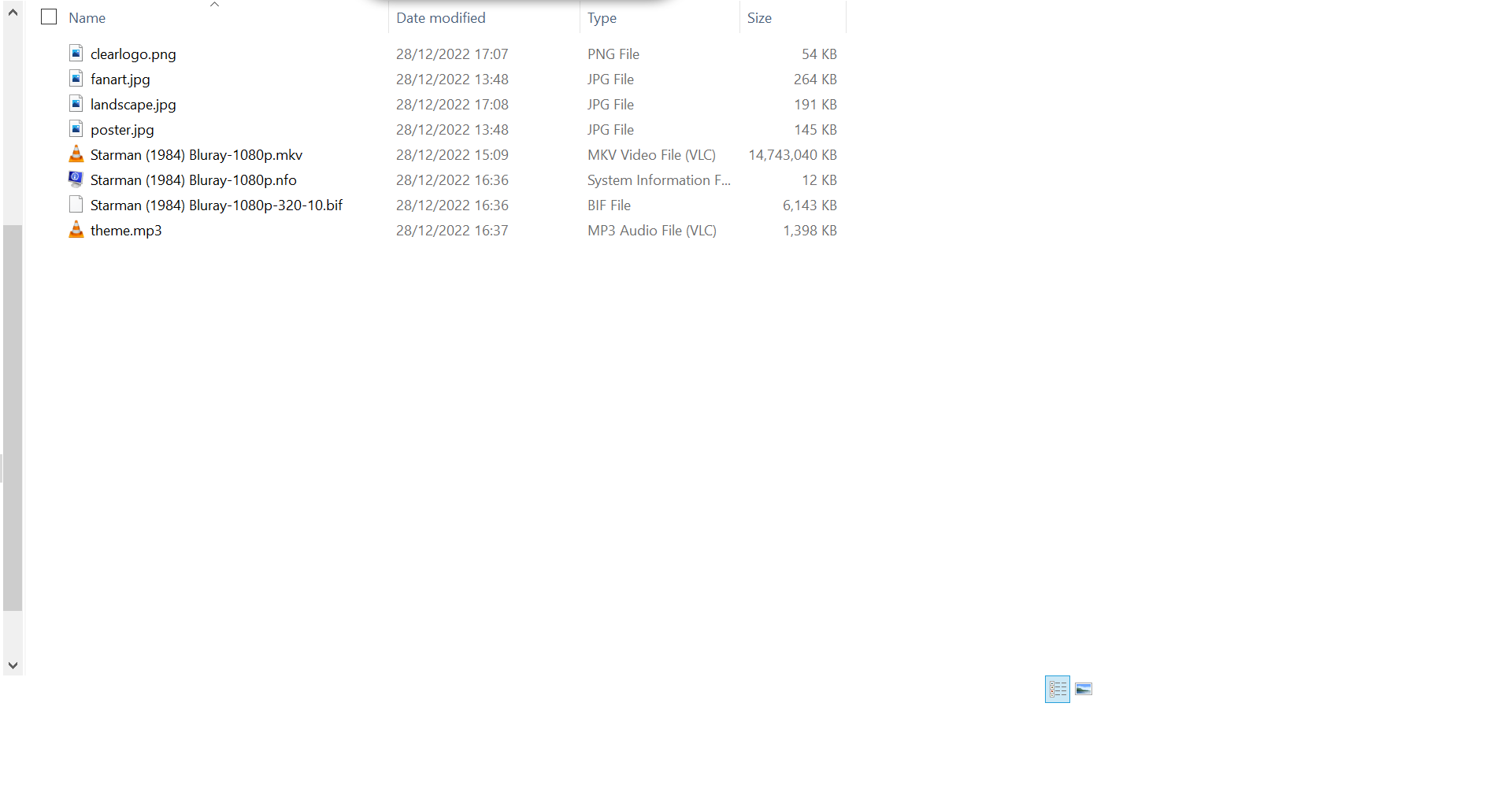

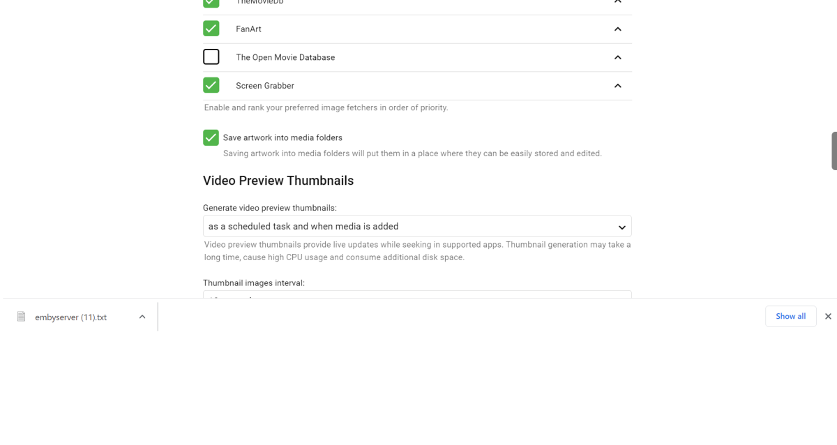

JuJuJurassic 49 Posted January 18, 2023 Posted January 18, 2023 (edited) As the UK's power costs have quadrupled over the last year, I'm turning my server off from 4am to 4 pm. I've added "00 04 * * * /usr/sbin/shutdown -P now" to the crontab -e on the Emby server and it works fine. I have internal storage and 2 SMB servers offering shares. One is old, and stays on all the time. The other, films, is the new, power hungry, server. My plan is to move the old server to the new one in the longer term, eliminating a server. Yesterday it worked fine. Today I tested it and all the media that was internal or permantly on, had it's metadata, but the films, the server that turned off, seems to have lost most of it's metadata, even though the metadata is stored with the media folders, as in metadata.png attached. If I look at a folder from a film with it's images and metadata, it looks ok, as in metadata2.png, but if I look at a film with it's metadata missing from Emby, no images etc, it's folder looks like metadata3.png. But it looks like the metadata's there. Initially I thought it was the problem I had previously, but the metadata is now stored with the media, here's the old problem I've changed the timings so the emby turns off first, then 5 minutes later the films smb server, and on poweron the new SMB server powers up, but I put a 5 monite wait in grub before the Emby server completes it's boot. Unfortunatley with the electricity prices as high as they are, I need to implement this, but has nay one any ideas why my metadata went, and how I can stop it happening again? Also is there a way of making Emby realise the metadata's already there, it's now pulling it down again. I'm running Emby on unbuntu 20.04. Thanks embyserver (11).txt Edited January 18, 2023 by JuJuJurassic reference old post
