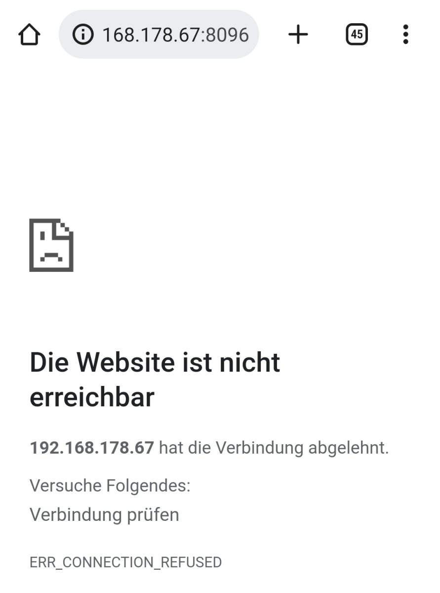

Newuser1234 0 Posted January 17, 2023 Author Posted January 17, 2023 Hi, my emby isn't reachable anymore. I get an erorr from my Browser, see attached picture. When is start the container new via portainer everything works fine again. Then I am able to reach emby with that ip/Port.
