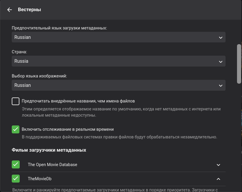

slaver666 6 Posted January 15, 2023 Posted January 15, 2023 Hi. Ubuntu Linux 22.04 LTS Emby Server 4.7.6.0. I've chosen the Russian metadata language for for all my Media libraries. TheMovieDb and The Open Movie Database are enabled as metadata grabbers. When I try to recognize the movie I have no response at all. I've found that Russian IPs are blocked. OK. I run Emby Server via socks proxy and receive search results. But ALL metadata became in English but not in Russian. When I search not by movie name but by Imdb ID I receive the correct Russian metadata. But it's too long way to rebuild entire Movie library movie by movie. I can't get Russian metadata if I refresh Media Library. Any suggestions? P.S.: please don't suggest to update Emby Server to the latest version. All versions older then 4.7.6.0 have an issue with default Folder view for Emby Android TV app (the generic Emby Android app works good but it's not useful for me on TVs because of some streaming issues).

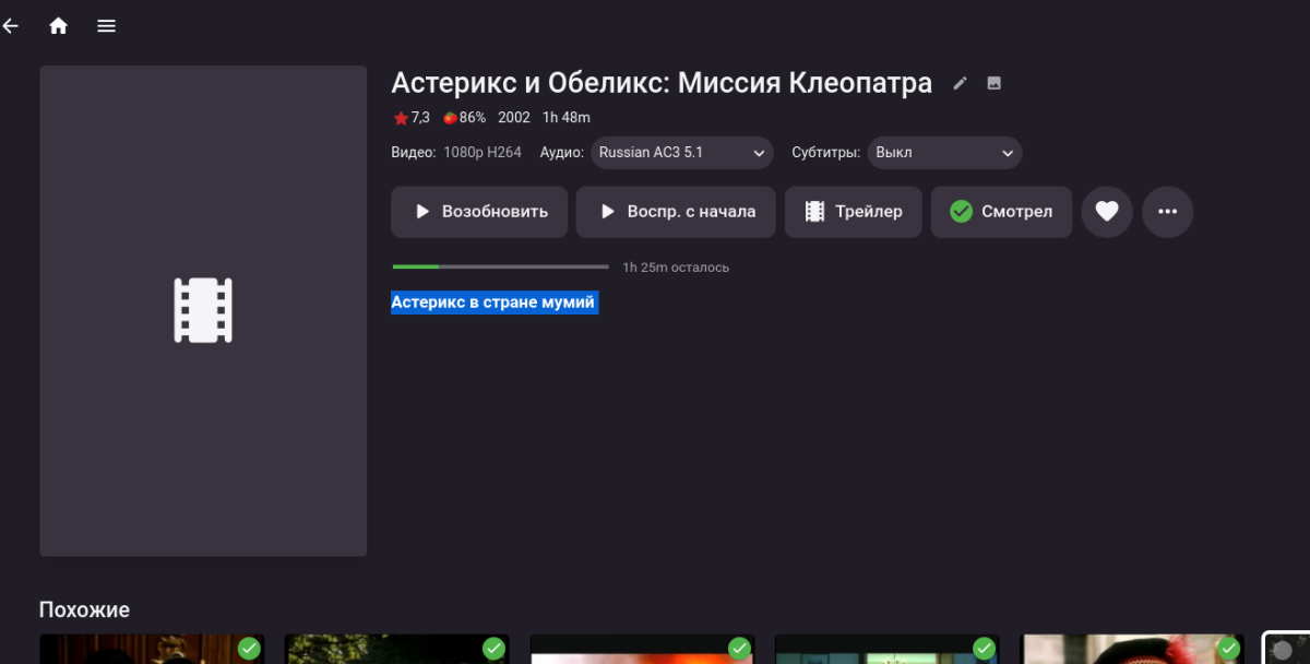

slaver666 6 Posted January 21, 2023 Author Posted January 21, 2023 I've rebuild all my libraries by hand. Now it quite difficult to give you the correct example but let's try. Again! I run Emby server over proxychains because the movie recognition doesn't work at all. I suppose it is a restriction for Russian users now. My movies are located in folders and subfolders. I don't use any Emby sorting and I definitely do not need this!!! I just need the Folder view. So. I try to get metadata for movie "Astérix & Obélix Mission Cléopâtre". I can find it by Russian name but after applying changes I have no correct metadata and even no images at all. I also lost main image for one of my movie libraries today for example. I would say that this issue is permanent for me. I see it in different libraries for different movies from time to time. I have no such issues with early Emby server versions: 4.6 etc. The current version is 4.7.11. embyserver.txt
