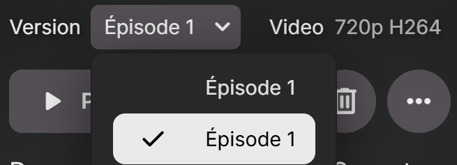

AndreiP 33 Posted January 12, 2025 Posted January 12, 2025 (edited) Hi wakeboarder141, I have exactlly the same problem. Did you find the solution? Please chek my screenshot: for this episode I have only one .mkv file, but Emby shows as 2 same version. I checked for another shows and there are some for which it is the same thing, but I can't determine why for some series it appears and not for others. I removed the episodes and added again, but nothing changed. Edited January 12, 2025 by AndreiP
Luke 42180 Posted January 14, 2025 Posted January 14, 2025 @AndreiPcan you try removing the entire series folder from your library, running a library scan, and then after it completes, adding the series folder back? Please see if that helps. Thanks.
AndreiP 33 Posted January 17, 2025 Posted January 17, 2025 (edited) First of all, thank you for your reply @Luke. It's helpful to receive a follow-up to a message posted on the forum, especially when you can't find the solution yourself. Secondly, sorry for taking too long to reply: before posting the solution, I wanted to make sure that it would really work. In order not to take too much time, this kind of problem is due to a failure of the hard drive to which the media library pointed. I read carefully the post by @wakeboarder141 and, based on my experience also, it seems that Emby was "seeing" the same series twice, even if, on my side, I was not able to see it twice. Before doing the following steps, make sure that you have checked the paths where your media libraries point and that the files are not in two different locations. The definitive solution to this problem, in my case, was to 1. delete the media libraries, 2. format the hard drive and 3. recreate the media libraries. Be careful, it is very important to delete the media libraries from Emby before or after formatting the hard drive even if you keep the same letter (s) (or paths) of your (for) hard drives. I hope this will help the community in the future. Edited January 17, 2025 by AndreiP 1
