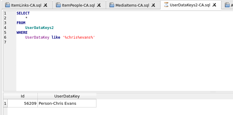

robcampbell 1 Posted January 12, 2023 Posted January 12, 2023 How are the tables linked to view the cast? Version 4.6.7.0 Is this not possible?

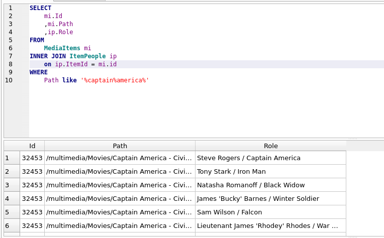

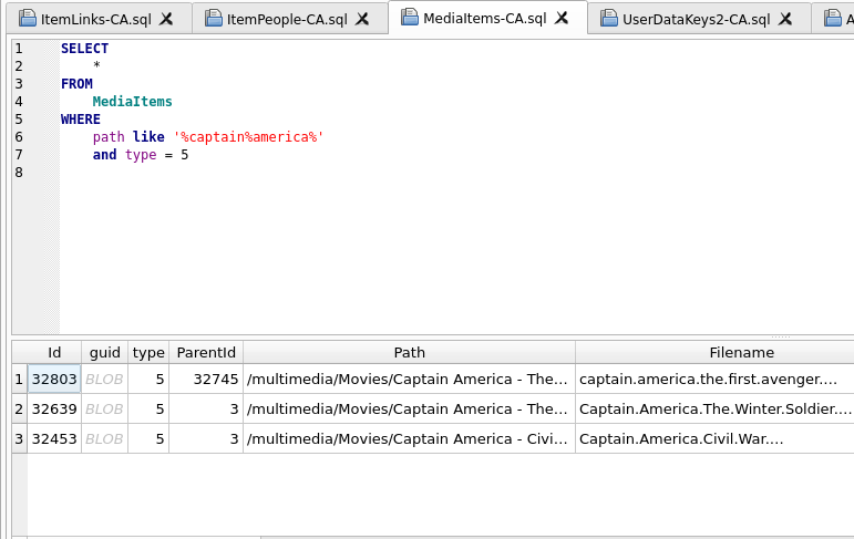

Luke 42245 Posted January 13, 2023 Posted January 13, 2023 Hi, yes now take that and join on mediaitems with itemid

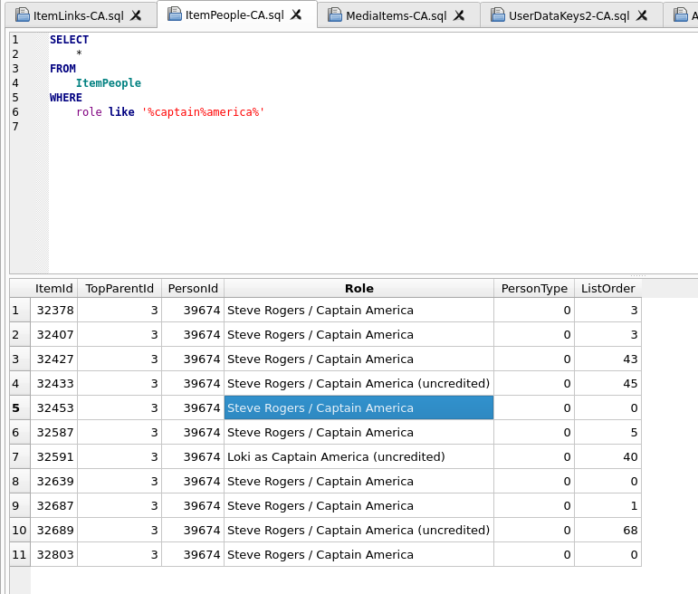

robcampbell 1 Posted January 13, 2023 Author Posted January 13, 2023 What am I joining? I am able to id the role, I am trying to the cast member's name. How am I joining UserDataKey2 to ItemPeople?
