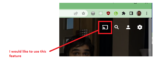

CelsoCruz 1 Posted January 11, 2023 Posted January 11, 2023 Hi, I created a server in my house with Emby. I set up M DDNS and it's working. The problem is that if I access through the Web my server (outside my home) when I want to mirror to a TV it shows the TV options of my home, where the server is installed. If I trigger the play, the video is shown on the TV of my home,where the server is installed... Can you fix that? Is there any way to show the video on tv where I am?

CelsoCruz 1 Posted January 11, 2023 Author Posted January 11, 2023 3 minutes ago, SamES said: I don't think that works remotely. Are you accessing via a VPN, or just though port mapping on the router using the servers external address? By NoIP (DDNS) with port redirect. I expected the browser to search for the tvs available on the local network where I was watching (should be). But it is looking for the TVs of the network where the server is installed.
SamES 1084 Posted January 11, 2023 Posted January 11, 2023 (edited) 14 minutes ago, CelsoCruz said: But it is looking for the TVs of the network where the server is installed. That’s correct. Local network means from the perspective of the server, not the client. Generally, casting only works to devices on the local network @Luke, or someone else can correct me if this is not actually correct Edited January 11, 2023 by SamES
Luke 42245 Posted January 11, 2023 Posted January 11, 2023 This is correct. We do plan to move this out of the server and into the individual apps in future updates, so that they can detect devices no matter what network you're on. But even once that happens, you'd have to do it using our windows, android or iOS app. The web browser can't detect your TV.
CelsoCruz 1 Posted January 12, 2023 Author Posted January 12, 2023 6 hours ago, Luke said: This is correct. We do plan to move this out of the server and into the individual apps in future updates, so that they can detect devices no matter what network you're on. But even once that happens, you'd have to do it using our windows, android or iOS app. The web browser can't detect your TV. Perhaps include a setting to block this mirroring when using the browser outside the local network. 1
